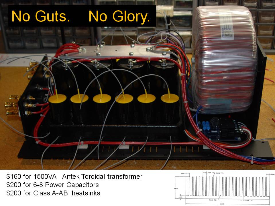

Sizing the output stage, power supply and cooling for the worst case speaker load at maximum SPL requirements is a good starting exercise. I've attached LTspice for an example current feedback amp you can test your ESL load with.
I've owned Krell KMA100s and highly recommend them. Worth some simulation time.

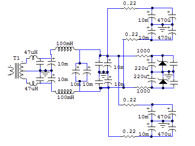

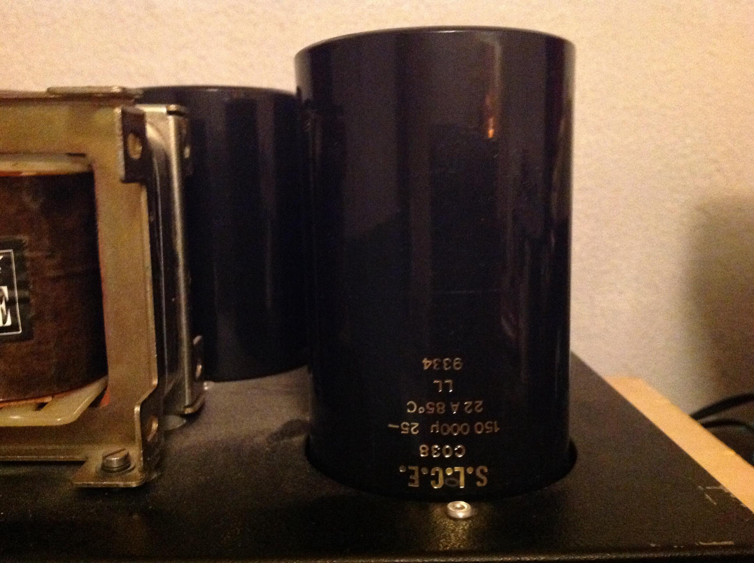

Helllo,
If you read the original publications about these amplifiers you will see all sbout big power supplies. 330.000 microfarad.
If i would build one again i would use the chokes lundahl did make for heater supplies and a big r core transformer.

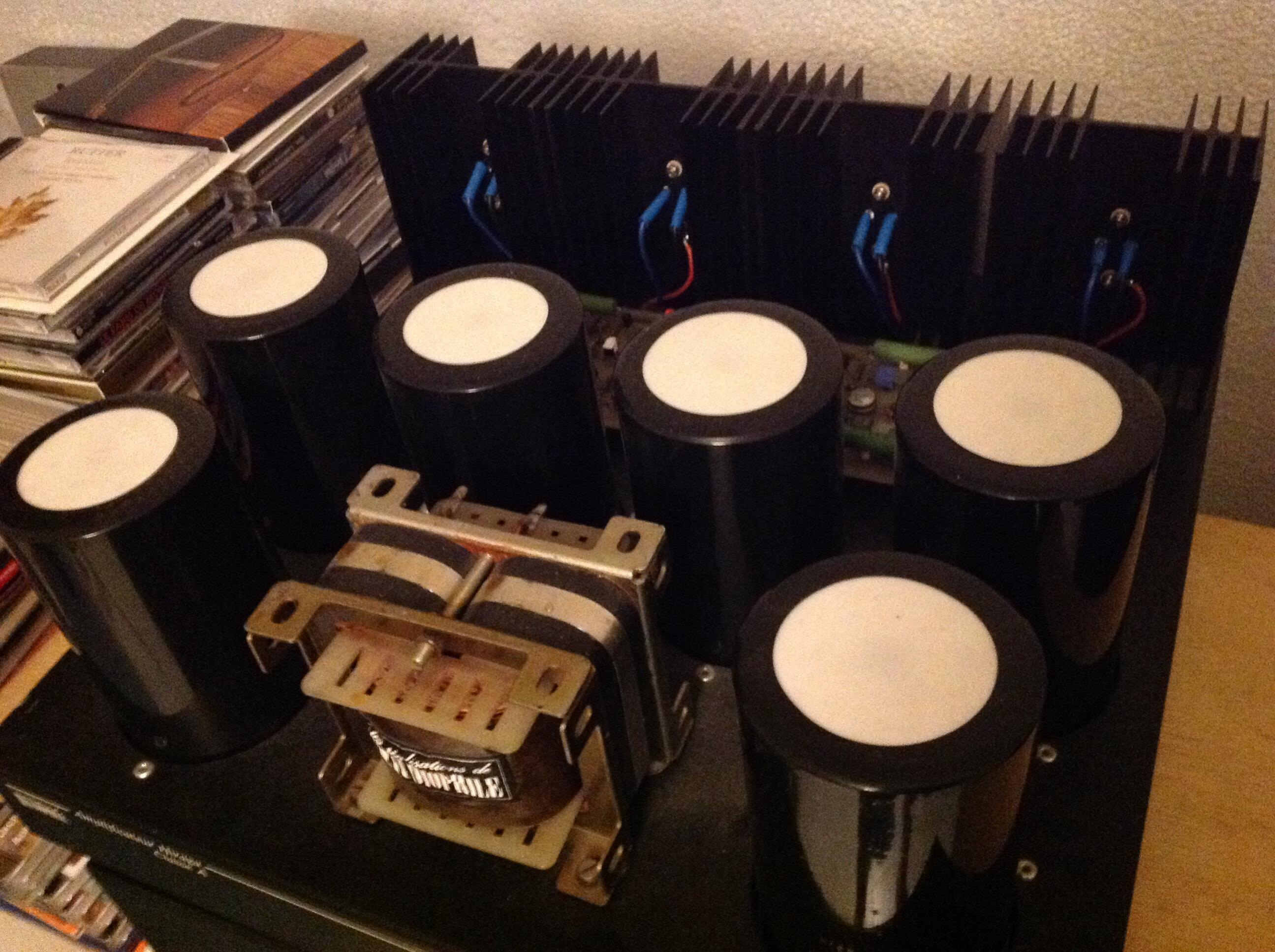

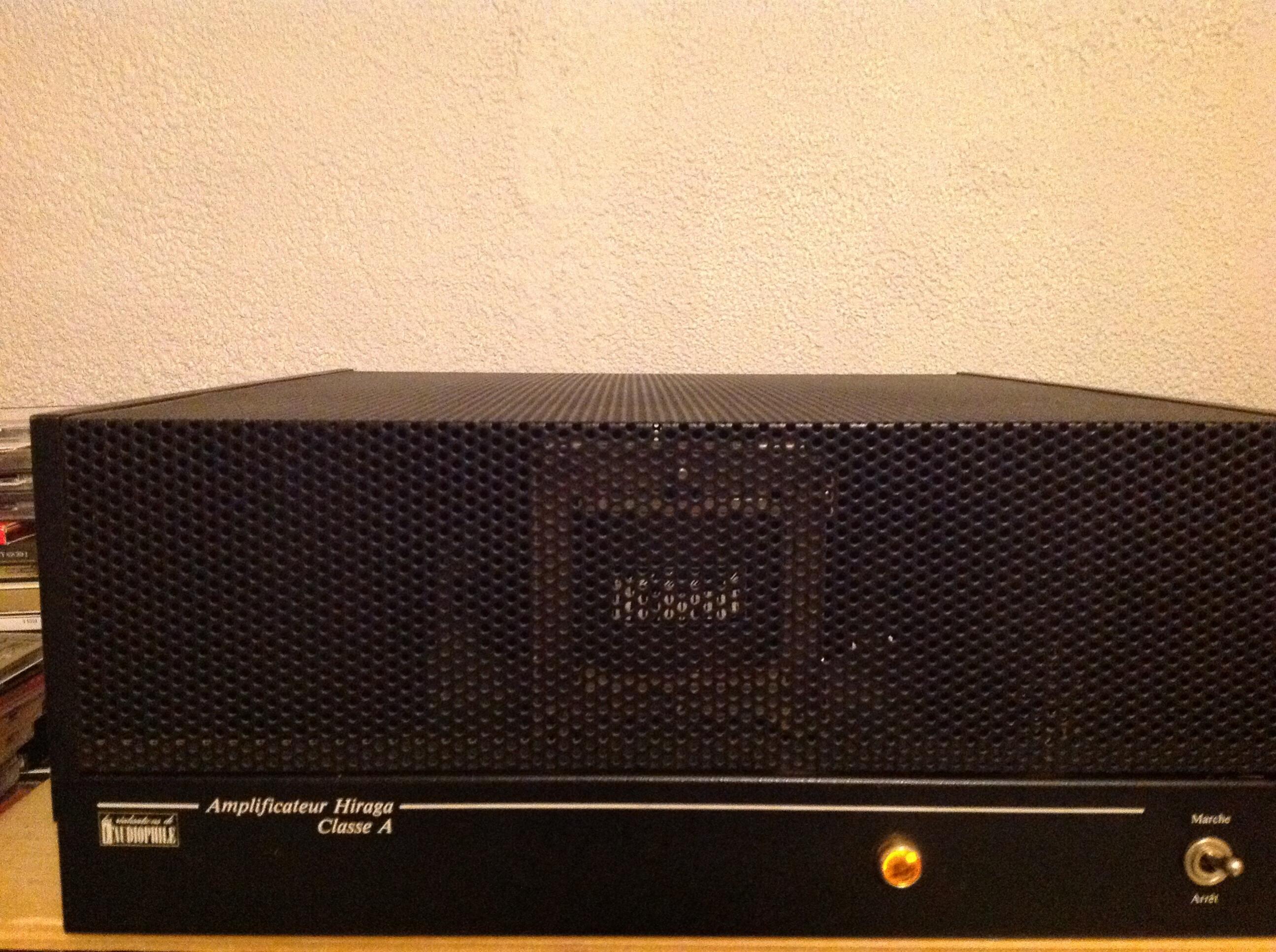

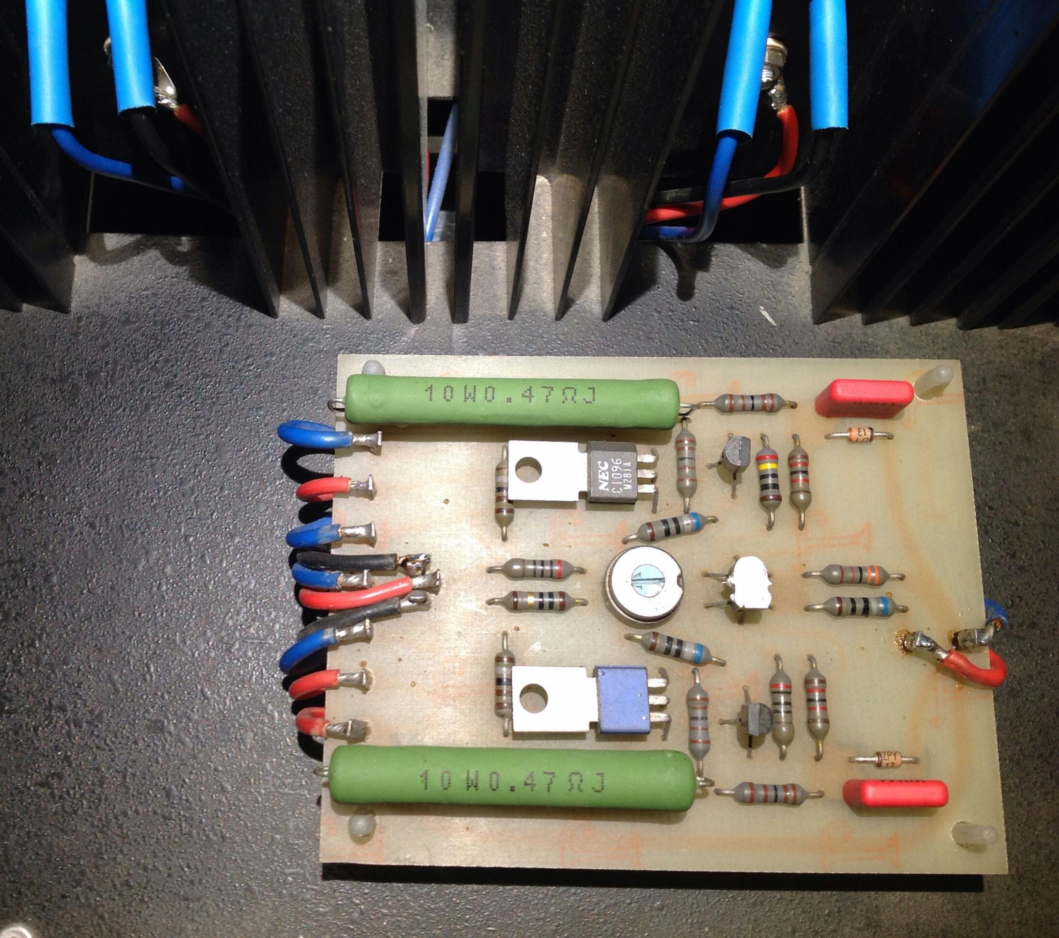

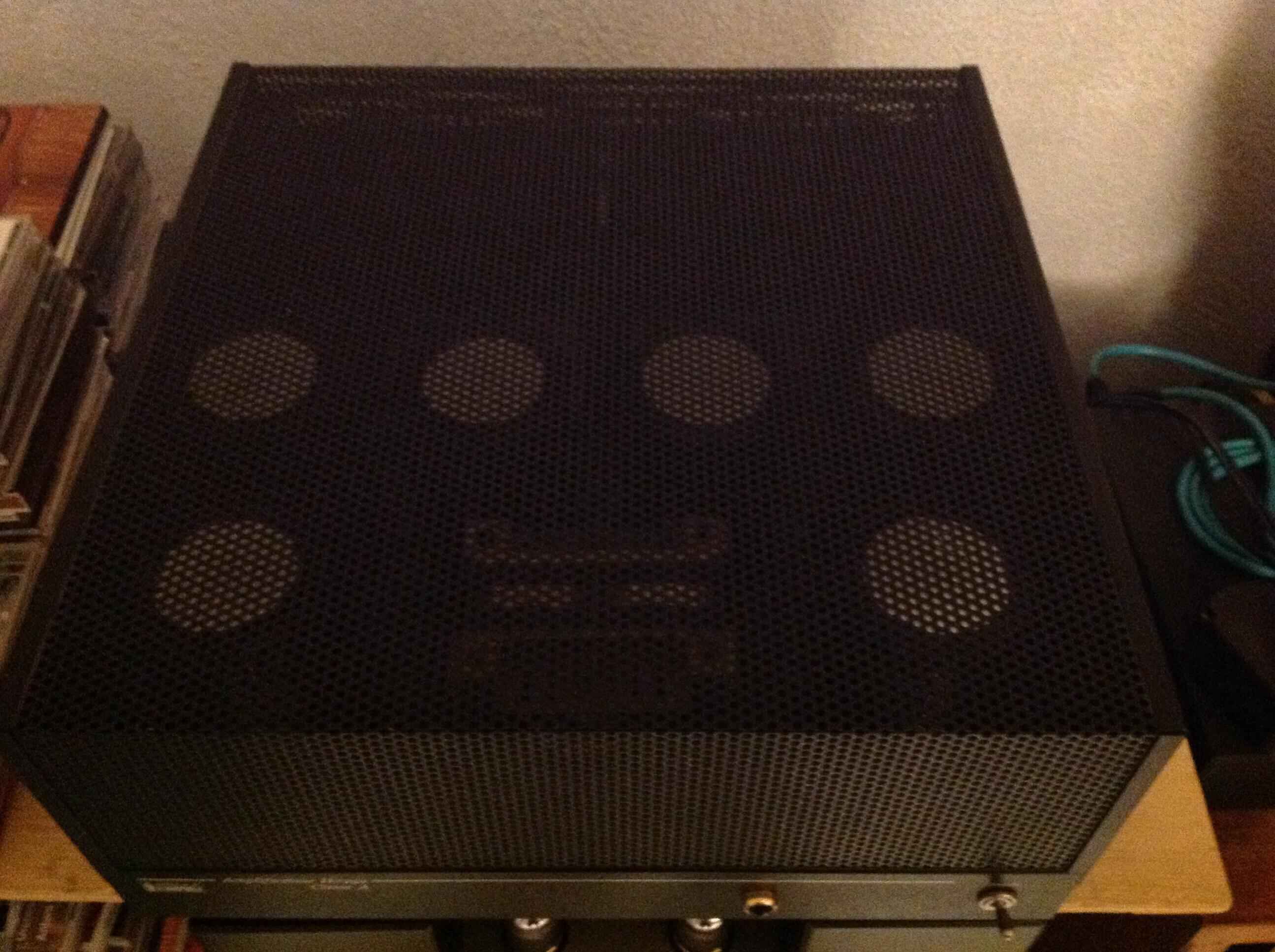

@ Sjoerd Smits @ Diyers
20 watts Hiraga the genuine one from " La Maison d'Audiophile " in Paris
