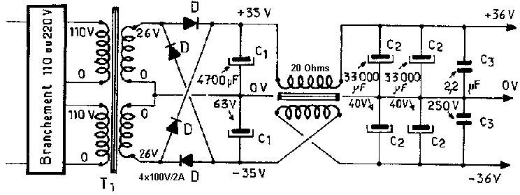

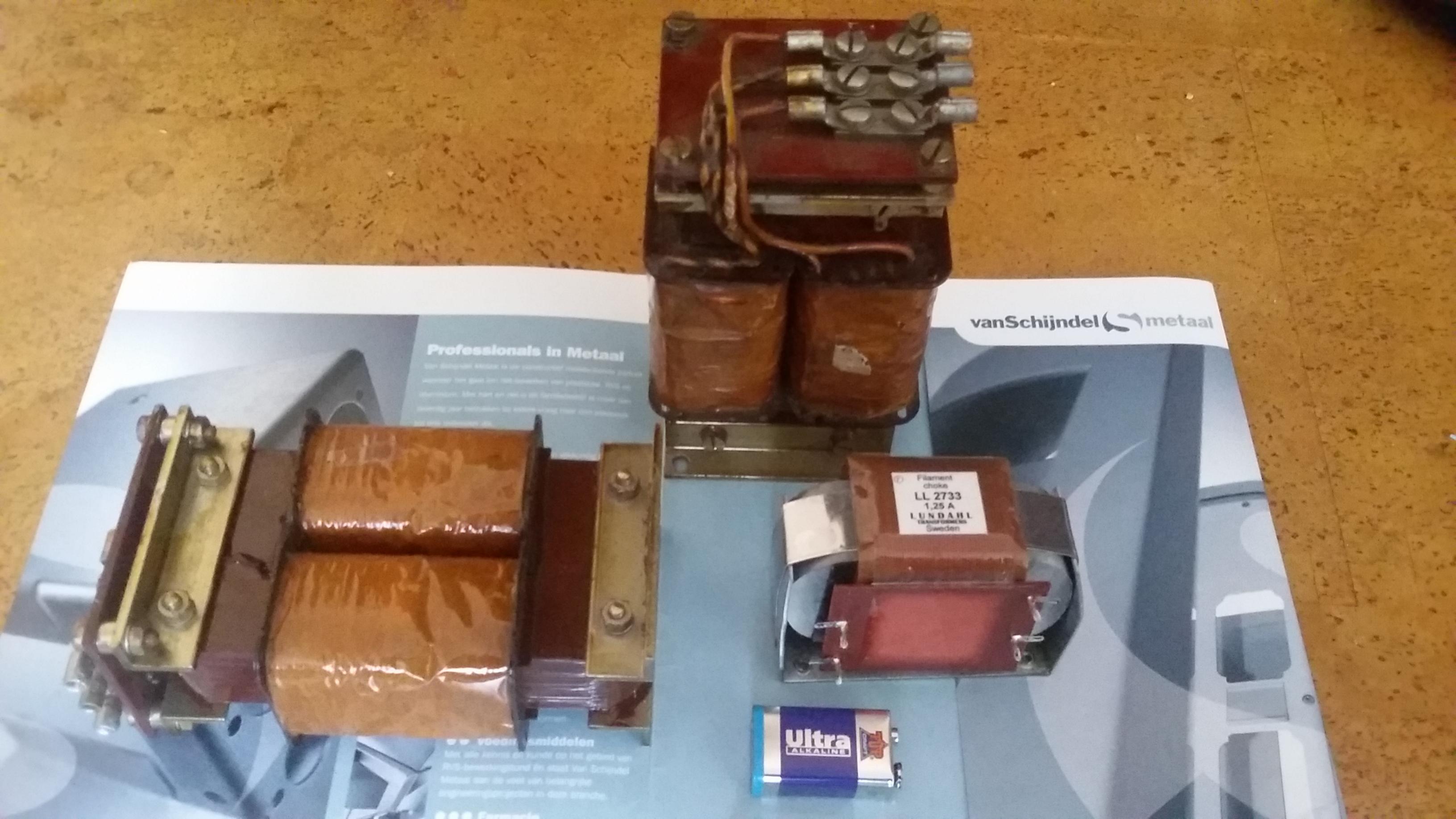

Hello,
What a pity only a few people did try to use CLC instead of the usual CRC for the hiraga.
When i did buy the parts for my hiraga in paris 30 years ago i did ask them if i could use the choke used in their nemesis amp and some high powered 50 watt class A.
They said surely but they did not publish this idea because it did require changing the chassis that they were selling as well!
In the attachment you can see the choke connection in their kaneda preamp.
The photo is the biggest lundahl choke availsble for class A power amp and some surplus chokes made by telefunken. One is 2× 97mH , the other one 2×660mH.
Surely more filtering than 0,5 ohm!
Greetings, Eduard

Hello,
The sound quality of the Hiraga amp depends a lot on the power supply. At the time i did build mine ( 1985) all parts were available in France. Now even with the worldwide web it is a bit tricky to find the right parts.,
Of course one could use the same '' topology '' using different parts but if you read all the original publications on these amp you will see that they spend a lot of time finding the right '' mix ''
The chokes i did use at that time were about 40$ a piece. You did need 2 for a stereo amp. The lundahls are a bit more expensive. I dont know if you can use them in the way that the French did use their double winding choke in their famous Kaneda preamp. If you can you will only need one.
My surplus chokes were just 30$ and they offer a better filtering. The high number mH will of course have a bigger voltage drop than the power resistor in the original set up. If i remember well it is 2 ohm for each coil. The lower inductance one is just 0,3 ohm for one coil so very similar to the original resistor.
I will p[robably use them in the dddac that will take some current too if you will use multiple boards and some shunts as well.
Greetings, Eduard

Hello,
I did read the articles i do have about the design of the Hiraga and the '' Le Monstre ''amp written by the man himself. Each of them did go through several design stages and in the end they always ended up spending more money on the power supply.
I did ask Per Lundahl about using the LL2733 or LL1694 in the same way as pictured in my post a few days back. His answer:
Regarding the common mode schematic:
The idea with a choke connected in "common-mode block" is that you normally have the same current in both coils. As there are bypasses (through ground) you must make sure that both sides are loaded equally.
If you do, yes LL2733/LL1694 should work.
Of course everybody is waiting for another person to invest some money in a choke and tell the other it is a good idea.
You could also decide to buy a pair of them. Put the the coils in parallel and have one choke in the - and the other one in the + that will surely work! I had mine that way.
Greetings, Eduard
