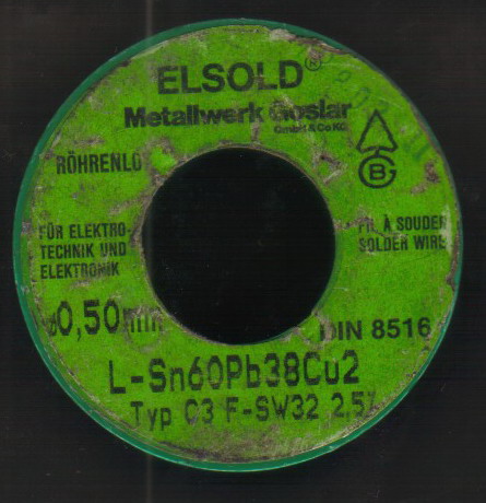

Has anyone has experience with this type of solder? Sn60Pb38Cu2?
Usually people likes silver solder, but this Cu solder seems better to me
How dangerous it is to inhale (daily) the solder smoke? Is the smoke only contains the rosin smoke or also has Pb/Sn smoke in it?
I have no experience, but the copper content should save erosion of the copper bit if unplated.
As far as I know it is not eutectic, therefore it will be pastey as it cools.
Does the copper wire that is being solder get eroded if the solder has no copper content? It will be a one off transfer so could be irrelevant. What happens?
I'll bet it is 62Sn, 36Pb, 2Ag.
Only because it was popular, and when you see 62% tin instead 63% it usually means that there was an additional element beyond lead... and that is usually silver.
