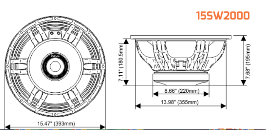

my funds are very nimble... there is no CNC people around in my town... the closest is around 200 miles
and they charge 100 bucks to cut a sheet of ply , plus 200 set up fee for the plans....
seeing that i discarded that route and start getting my humble tools and will do it myself
i mean... will start the step learning curve...

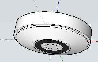

at least i can draw now in sketchup simple cabinet plans
and the 3d projections of the cabinets
still learning all the curves and domes shapes
and since i cant find a driver to add in my drawings, i making it myself...
is not as easy as it seems cause there is a lot of chamfers and angles
watching you tube tutorials along the way
the cone thing
and the magnet
now i the hard part is the back structure that hold all together
