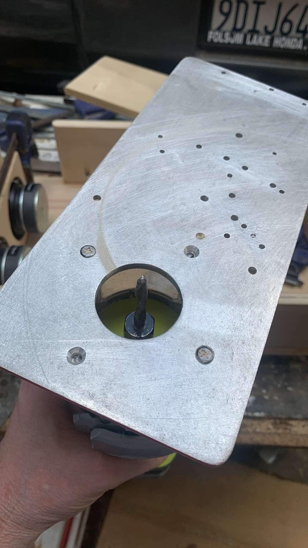

1/2" shank preferably, straight cut for using a compass jig, a pattern makers bit (top bearing) if using an inside template. If making an inside template make sure to leave enough room to clamp it down without interfering with your router base.

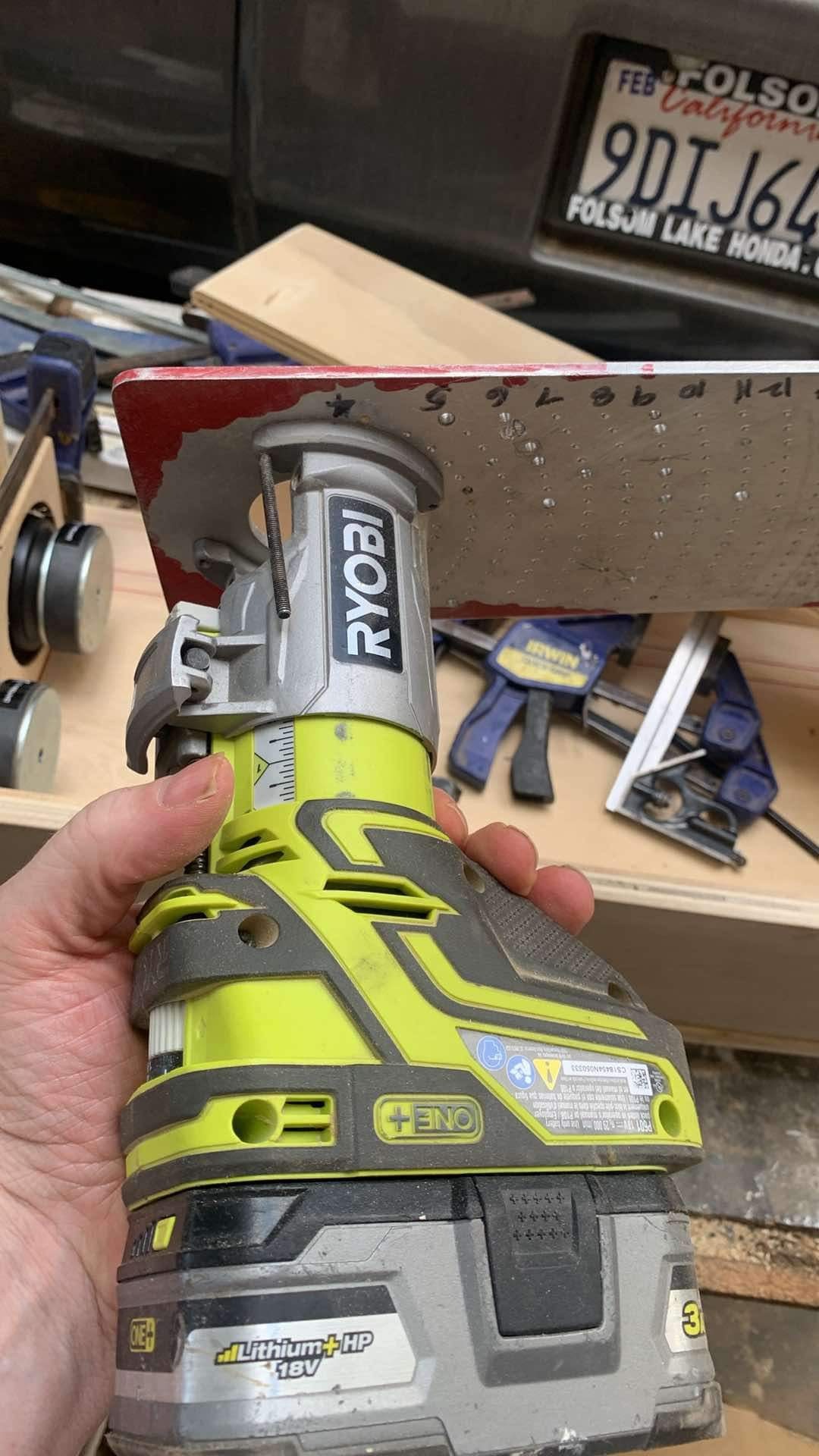

That's a good router. I have the same one. I like the stepped vertical guide. It has 1/4" depth increments when you turn it.

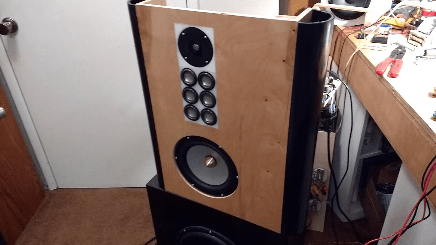

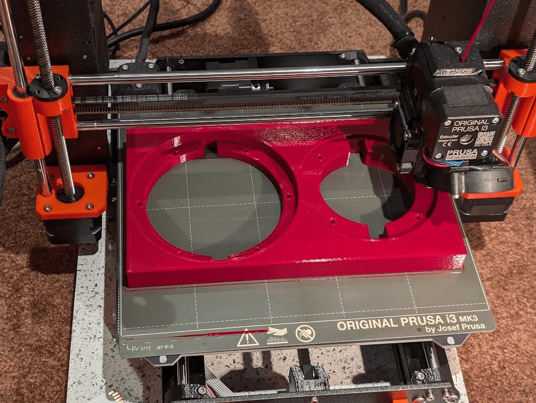

In my latest builds I have been 3D printing sub baffle sections for the tweeter and midrange as I can dial in everything to a fraction of a millimeter and have perfect repeatability. Even a low quality 3D printer can do a good job on a baffle and used printers are nearly free or very cheap on craigslist or FB marketplace.
@weltersys maybe it will get rid of the chatter too(I’ve been using spiral up ignorantly)
Eat your noddle's, Learn something new every day little Grasshopper !
Wow,In my latest builds I have been 3D printing sub baffle sections for the tweeter and midrange as I can dial in everything to a fraction of a millimeter and have perfect repeatability.
those last pic looks like high end studio monitors!!
if they sound as they look you are golden !

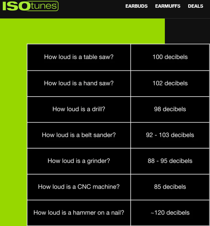

Make sure you wear good fitting NRR 30dB (or higher) hearing protection, like the 3M Peltor Optime 105 earmuffs.
Using ear plugs in addition is a good idea, safety glasses, masks, hair all reduce the NRR rating.
I made the mistake of thinking "deadphones are deadphones", and found out too late I could have reduced my hearing loss by a good amount if I'd worn muffs with greater attenuation- some muffs have as little as NRR15 dB.
