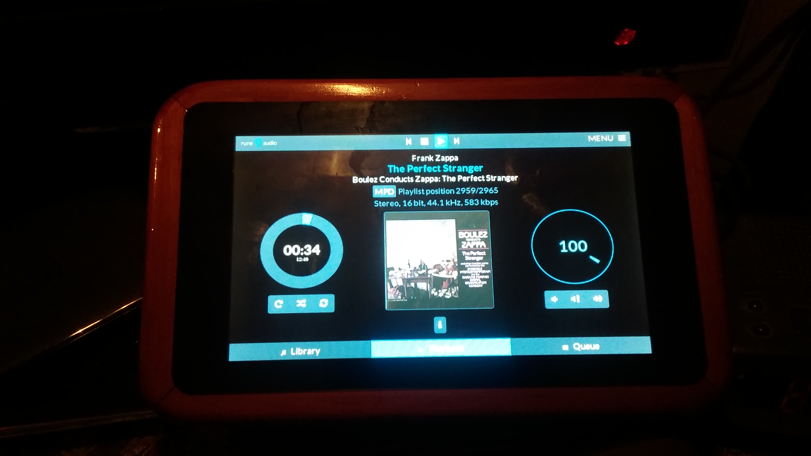

Rune Audio 0.4b on a raspberry pi 3b.
I am not a fan of using my phone or finding the tablet behind the sofa cushions for control so I have it set up as a 'stand alone' with it's own touch screen with a mahogany surround sitting in front of the tele. We find this is more family friendly as our house is small and this is the lounge room & kitchen. It is fed by a small external 0.5Tb USB drive which I update manually every few weeks and it feeds into a Shiit BiFrost DAC. Very happy.
I have recently tried '+R e4' version but because I am quite happy with the 0.4 and the later froze on me a couple of times I couldn't be bothered pursuing it.
