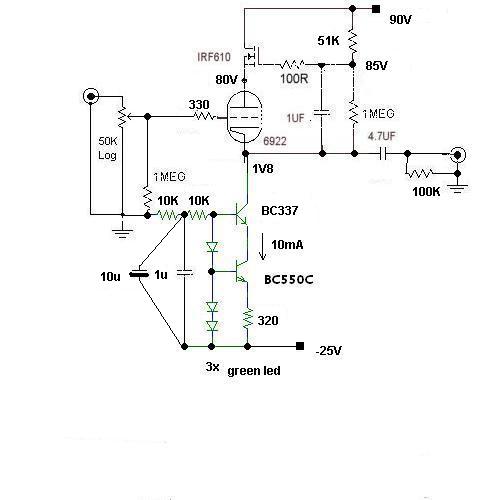

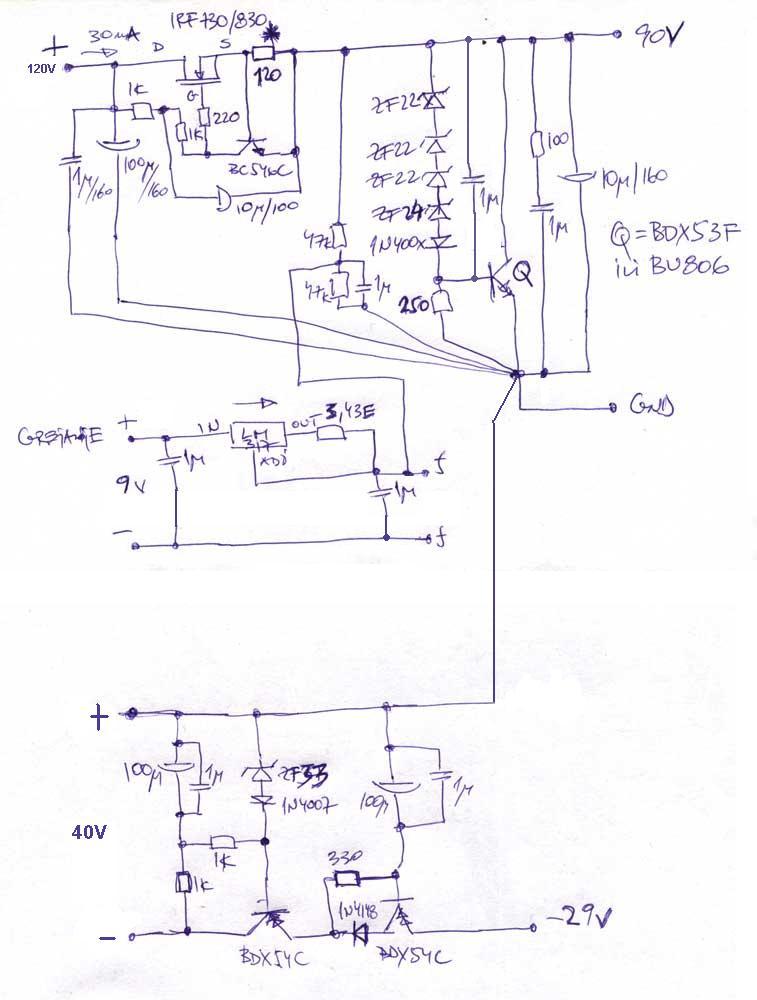

To revert to the thread topic, I am seriously contemplating making a tube line preamp. I have a few good tubes incl matched quad of NOS Mullard E80CC tubes. I don't need the greatest gain levels. I do need low noise as I am driving 96Db horns and also O/** at similar sensitivity. Any ideas gratefully examined!!! Thanks.🙂

regarding AW's book - even if I didn't read it , I think it's well worth ;
if you're looking for SLCF info - there is active thread at our Serbian DiyA .
but - to save you hassle of registering and translating , look at these two pics ....
it's amalgam of various ideas , off course .
if you wish any help for E80CC SLCF , just buzz

Many thanks indeed. FRom a practical, VFM*, viewpoint it looks excellent! I have most of the bits in the garage/workshop!😀

regarding PSM SLCF - say your preferences , and I'll try to help ;
that's not just VFM-related good , but damn good stage .
