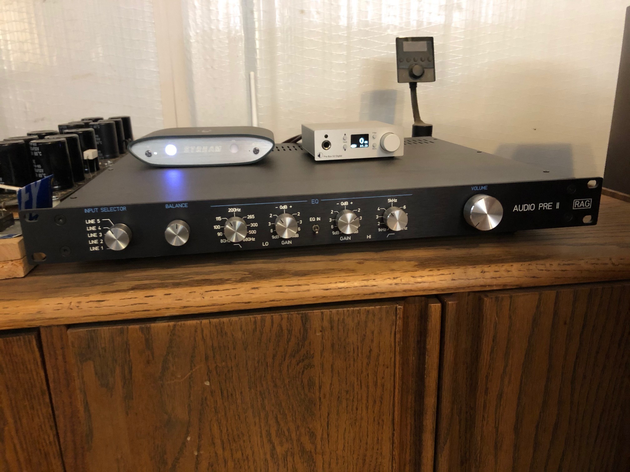

How about something completely different. Break out of the minimalist mode and go full function pre. My vote is for Doug Self Preamp. A fantastic pre.

Freecrowder, yes actually I would prefer a full function pre to be honest. Just not sure I'm up for building one, biggest problem being the chassis. That's why I'm also looking at the possibility of some vintage commercial design that can be refurbished and/or modded. The one thing that is attractive about newer minimalist designs are the years of advances in both thought and designs, plus easier to build. I don't need a ton of inputs, just phono and a couple of line inputs. I'll check out the Doug Self.

You don't have to build the chassis for the Self. check it out. The front and back panel designs already have been laid out from Front panel. You also end up with something that looks like it is commercial design. It doesn't come w/phono but you could add it. I outboard it and an excellent one from DIY. Let me know if you want to see some pics.
