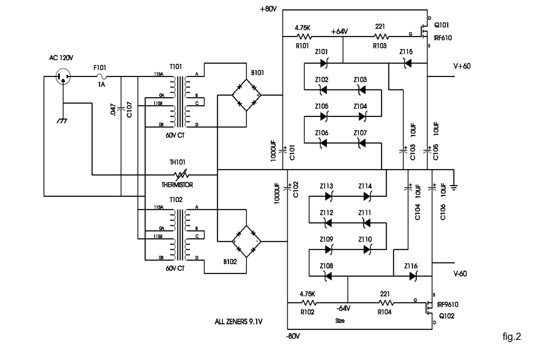

The PS is quite simple. Borrowed from NP's BOSOZ article. Figure 2 is attached.
https://www.firstwatt.com/pdf/art_bosoz.pdf
I built up a 30 V zener reference into the gate of the MOSFET. The trafo is putting out about 37 V. Ideally, it would be good to get a bit more out of the trafo. Under load, there is about 28V into the preamp on both rails. I used the same Fairchild MOSFETs as the main preamp in the PS. You can see the PS on a perf board to the top of the first image.
My build is quite the ghetto build. Please build yours with safety in mind. I literally built this in an afternoon and I am in capacitor swap mode right now, so I haven't put it in a case as yet. I used on hand parts from my parts bin, so you might see, for example, that the resistors and even the heat sinks do not match. At least I got a pair of the same sinks for each channel. The PS caps are Panasonic Nichion types, but nothing special. I installed the MOSFETs in reverse and had to fix that.
Hi ra7,
Is that a dual 25V trafo that you have in the pic?

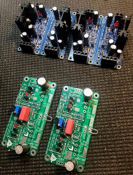

Juma's LSK
Need to get mine together, at the very least something quick and dirty to give it a listen. These boards have been tested and should be ready to go. Used a DCA75 to get closely matched transistors on the Cubie 2's (set up as a preamp only). The blue boards are Super Regulators from the Store.
Yes, dual secondaries wired into one bridge rectifier each. Can't remember the the spec. But I can look it up tonight.
Yes please, and thank you!
The marking on the trafo is unreadable but I am getting 27 V AC before the rectifier. I would shoot for at least 7 V above the rail voltage you want to supply the preamp. In the BA-3 article Nelson mentions anything from 24 to 32 V should work just fine. If you start dropping more than a few volts across the PS FET then it should carry a heatsink. I put a small clip-on heatsink on it and it does not get warm. Current draw should be about 60 mA per channel if you build it to spec.
