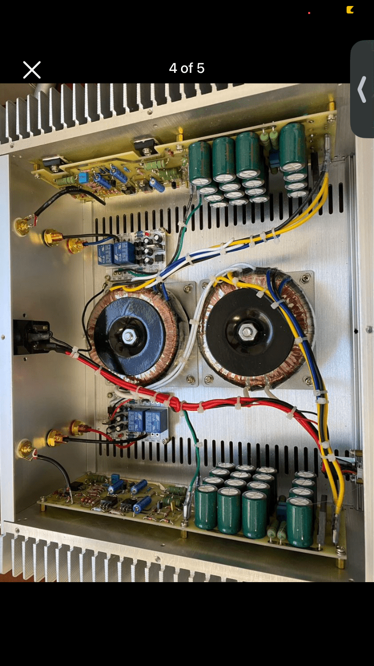

I am NOT a DIYer so it may be a stupid question. The seller doesn’t know what amp this but he says it is supposed to be a Pass Labs circuit. He bought it from someone.
Can you tell what model it is? And how well/cleaned it is made? Looks neat to me.
This is also what he mentions about the specs but I don’t know how accurate it is.
Very nice sounding 30wpc class Internal working voltage: two groups of independent double 35V DC

I'm going to guess it's a small Aleph. If you can take some close up photos of the circuit board people are have a better look.
Looks like each channel has three electrolytic capacitors, three TO-220 transistors, and a TO-92 transistor, so that definitely suggests an Aleph circuit. Only two TO-247 devices per channel, so it must be essentially an Aleph-mini with higher rails and bias.
I decided to do a Google Lens search and this came up! This is the SAME amp. Funny thing is the asking price is $10 more that his used amp!
What is A30? Aleph 30?

Yes, A30 would likely be interpreted as Aleph 30 in this context. But, there are some key differences between this amp and a true Aleph 30. For one, the Aleph 30 had more output pairs (6 pairs in total, if I remember correctly) instead of a single pair per channel. Also, an Aleph 30 would power double into 4-ohms. The lack of additional power into 4-ohms for this amp could be caused by lower overall bias (being limited by the single output pair) or a different current gain setting (or both).
This isn't too say it's a bad amplifier, just not really a true Aleph 30.
