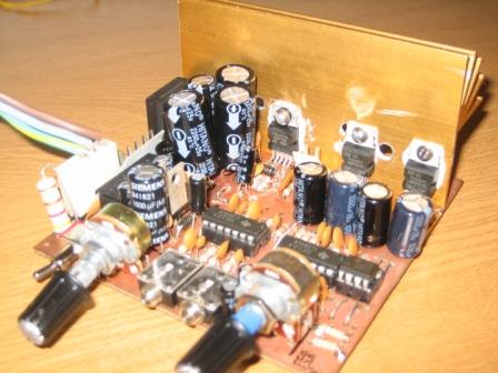

Mike,
I did that project using TL074 .
I'm using it in a work in progress 2.1 PC sound speaker.
I use ground plane layer and 78xx based PSU.
I drive TDA2003 and TDA2030 directly. I'm planning to change these by lm1875.
Sound is good. No noise No hum

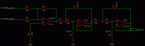

Anyway, I'm stuck... I've found a voltage summer here:
http://users.cscs.wmin.ac.uk/~wooda/components/opamps/
Now, the part which concerns me is "R5 should be parallel combination of R1-4 (R1-3 including source impedances)."
I'm not really sure what the source impedance is, but would using input buffer solve this? Or could I just get rid of R5 and have an inverting summer?
I'll post the schematic so you can see what I'm trying to achieve...
I've got 8 pin sockets handy, so I can use them and use my 4558's while I'm waiting for the TL's to arrive.
