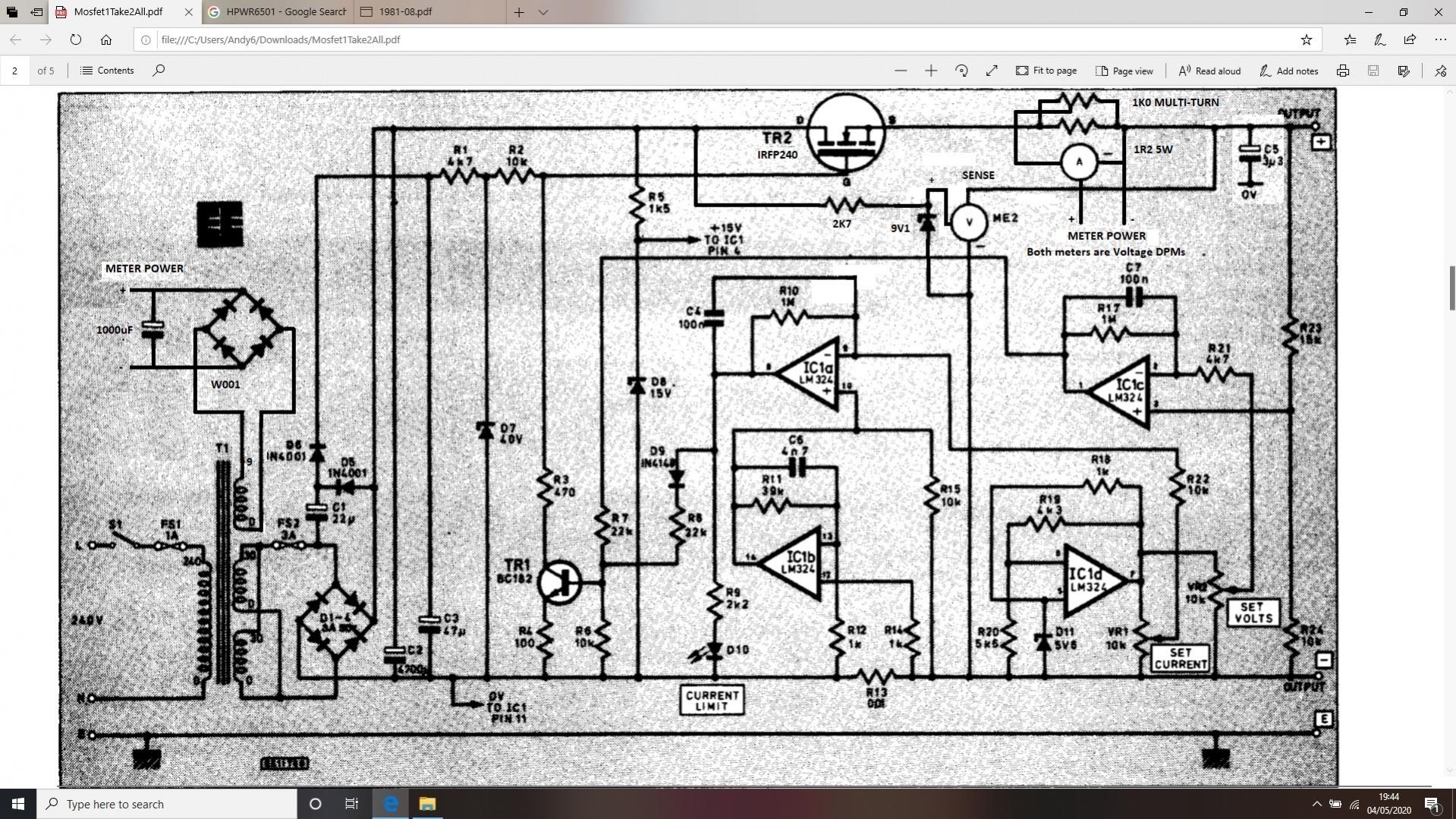

The modified schematic

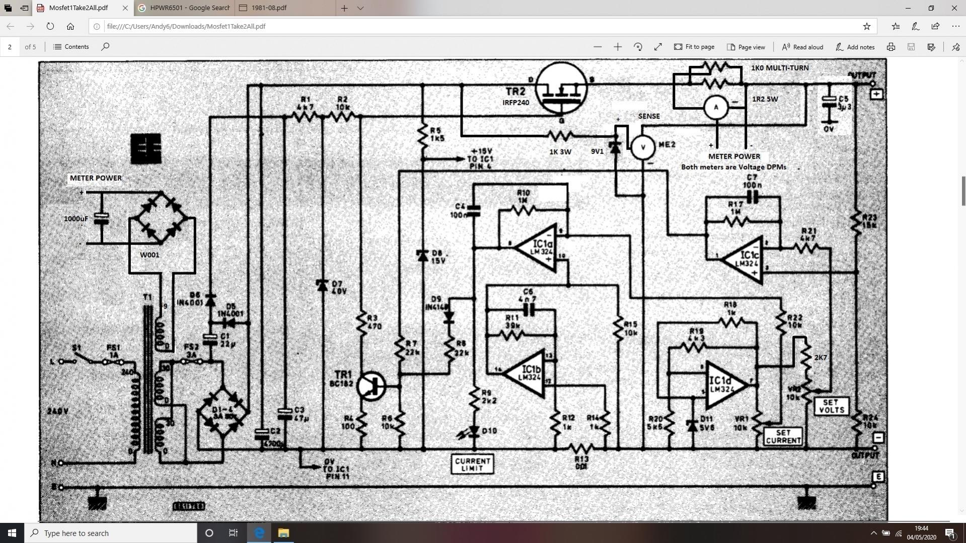

Here's the modified schematic.
I've added the trim-pot across the shunt resistor as it is difficult to get 1R0 / 10W at 0.1% accuracy.
The 1R2 allows for the builder to trim any errors out of the current reading.
There is still a tiny error due to the sensing circuit drawing a minute current but it is the order of a few mA.
I was hoping that someone would comment on how the original design would have been able to shed some 100W of heat from a single output device.
The DPMs have a wide operating voltage, I only used 9V1 as that is what I had on hand.
I don't think there will be much difference in the two displays at 12V and 9V.
By using a MOSFET with a big die area mounted in a TO-3 package with its large thermal contact area mounted on a huge heatsink? And making sure to use a MOSFET without Spirito instability, of course, but MOSFETs from before the 1990's generally didn't have that.
It couldn't, the HP part had a max PD of 90W. I would think that the original project documentation would have had a graph or curve showing max voltage and current output vs dissipation.I was hoping that someone would comment on how the original design would have been able to shed some 100W of heat from a single output device.
I've got the original article, there is no mention of maximum dissipation curves.
It simply says 0-25 V at up to 2.5A.
It's unlikely that I would ever need 1V at 2.5A.
5V at 2.5A is a real life load. At that load the IRFP240 would be dissipating 87.5W.
The IRFP should be good for 150W but will the heatsinking be adequate ?
I could mount a couple of fans to increase the airflow.
Would it be possible to get a copy of the article from you? Thanks.
If you PM your e-mail address I'll send you a copy.
I have had permission from the originator of the design.#

I've had to make a few slight adjustments.
The DPMs draw slightly more than 20mA, the 2K7 in the Zener line for the voltmeter starves the DPM of power. I've had to reduce it to 1K0 and up the rating to 3W.
The DPMs can only read up to 30V. I've added a 3K3 at the top end of VR2 (Voltage adjust) to limit its range within that of the meters.
You can play with the value of the 3K3 resistor to suit your DPM.
I eventually used 2K7.
The circuit with a 30V transformer and IRFP240 can actually produce about 37V.
