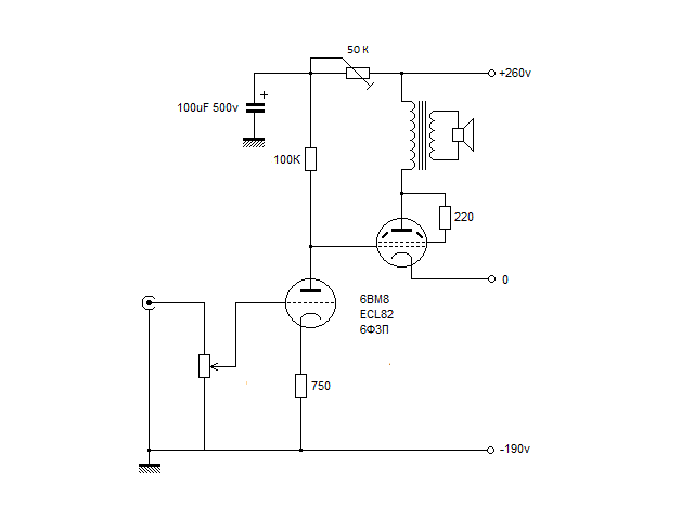

6BM8 is a very good tube ! Do you have them ? I use it in this schema (please look attachments):
With anode load 4-5K this amp gives with 2,5W power about 0,5% of 2nd harmonic. 3rd harmonic is so small that it is not defined by my devices

you are missing cap on input , for start

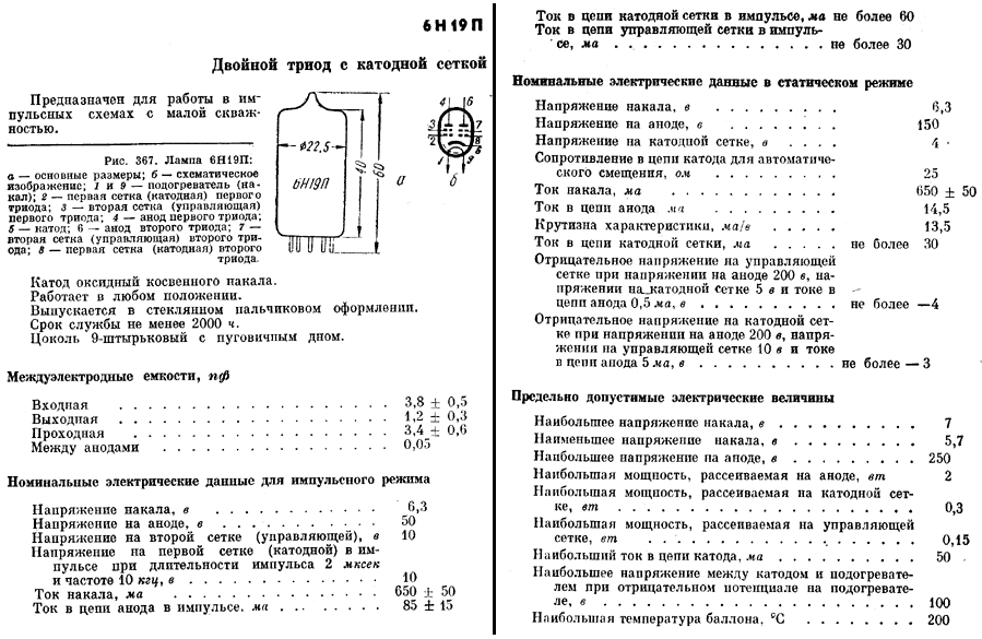

😉Do you mean Google Translator is needed to translate tetrode picture to pentode?
You should count grids. Tertode has 2 grids, pentode has 3 grids.
Zibi;
we discussed it already, but did not come to conclusion, who made a mistake: who wrote description in the datasheet, or who drew the picture. Sacrifice is needed to check what is inside, or at least X-Ray picture.
I like the way they put the -190V to ground, after all, this is a floating supply and no coupling capacitor is needed ! 😀6BM8 is a very good tube ! Do you have them ? I use it in this schema (please look attachments):

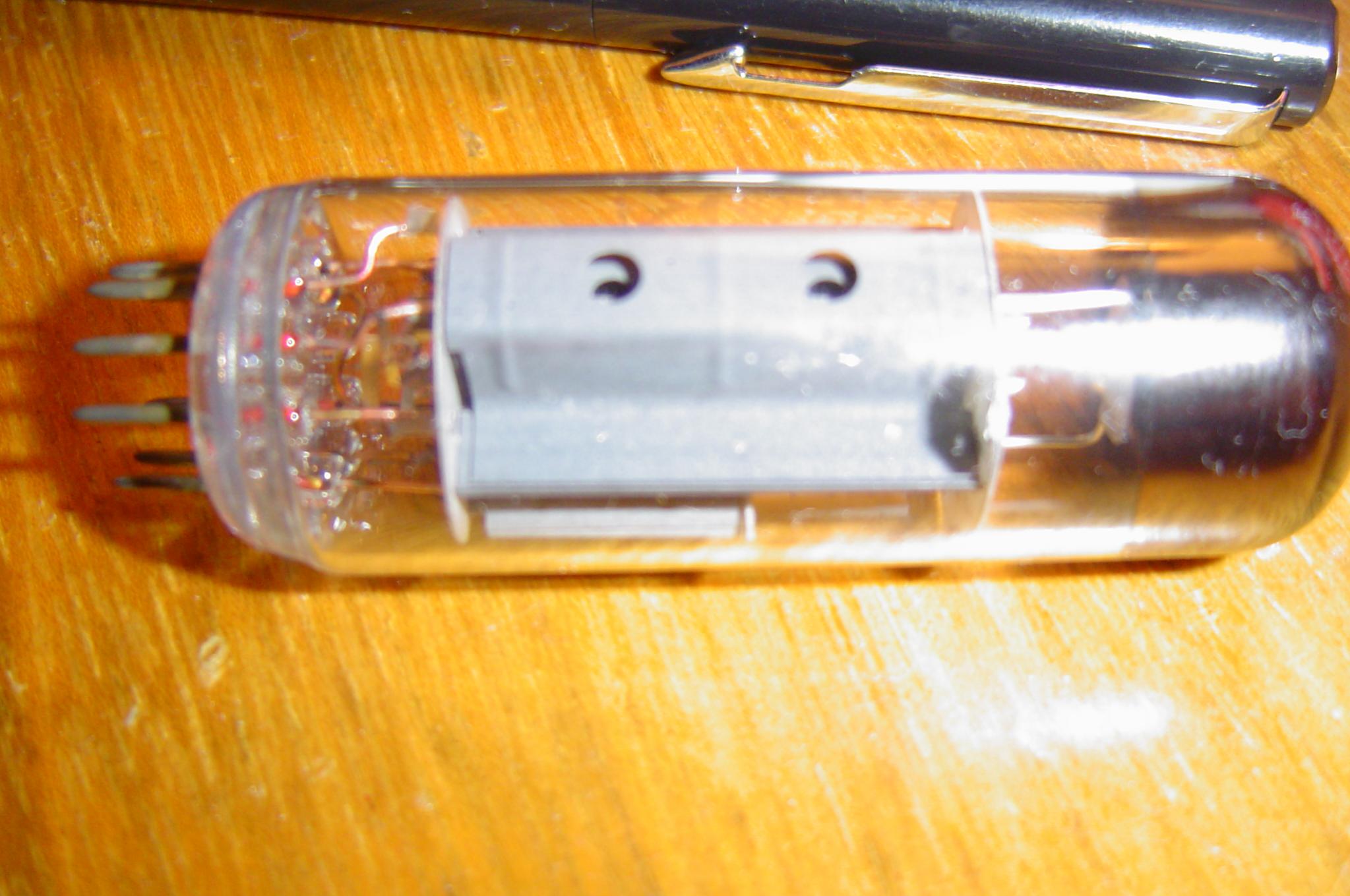

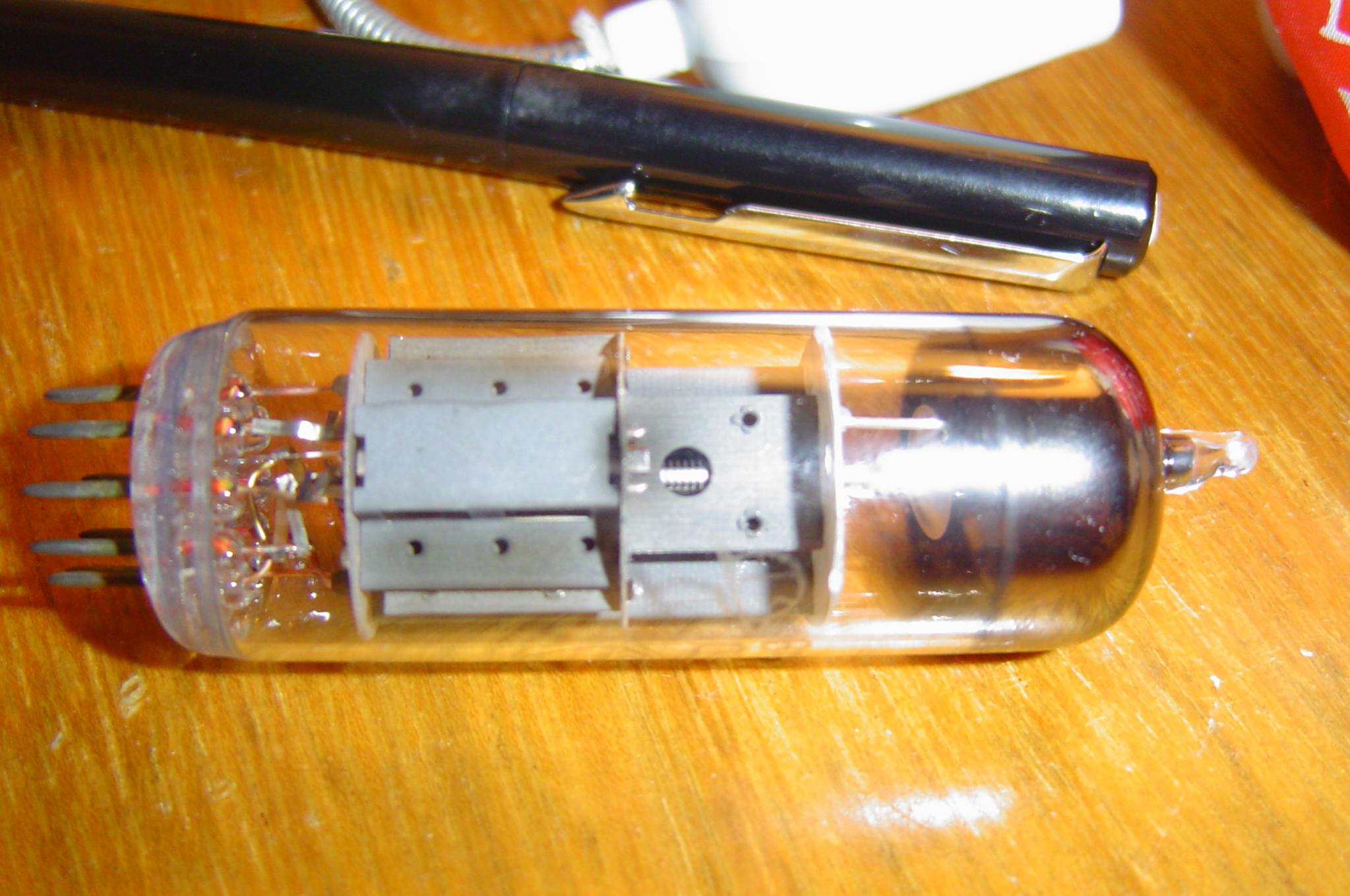

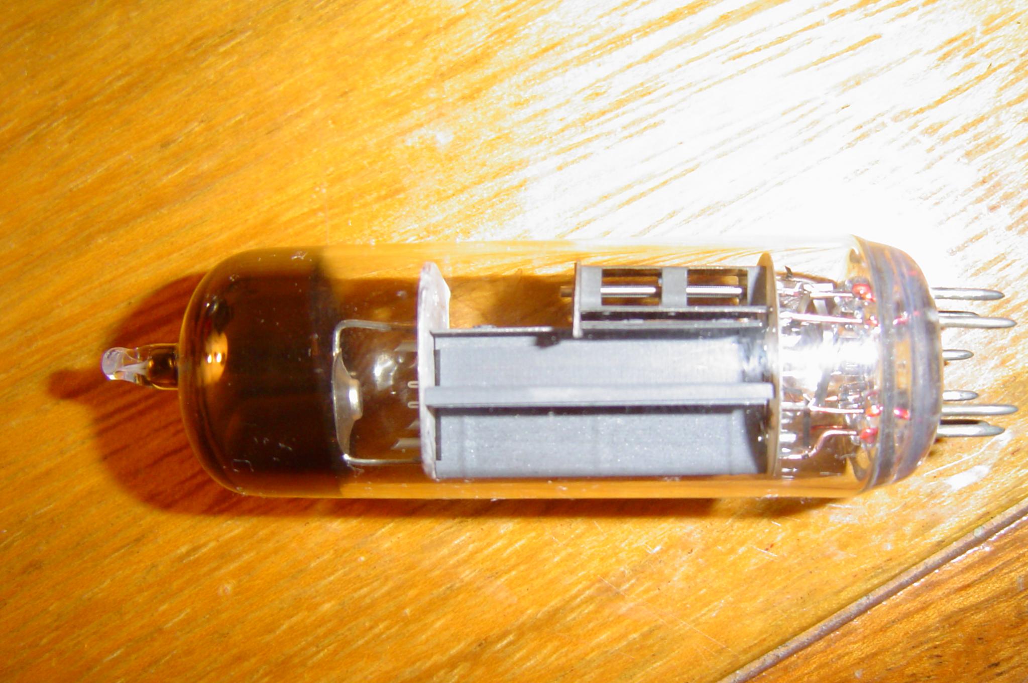

Sorry for resurrecting this thread from the dead, but IMO it deserves it as contains such a lengthy discussion on the pentode vs. beam power tetrode and I can add a proper (documented) closing to it.
No need for sacrifices though. I have got a batch of this 6F5P and can confirm that it is a beam power tetrode. The beam forming electrode is clearly visible through the holes in the anode, as also is the lack of the g3 supporting rods on the top and bottom of the assembly. I will upload photos tonight.
Gaston
If 6J4P and 6J5P are copies of 6AU7 and 6AH7 that are actually popular 6AC7 and 6SJ7 tubes without metal skirts most probably they must be ray tetrodes since RCA did not want to pay for pentode patent.
6F5P Photos
Crappy photos, I know, but better than nothing.
In the first one one can see the beam forming electrode right under the anode structure. Same material as the anode itself-
In the second one can see the screen grid (g2) supporting rods through the hole in the anode.
The third photo shows (badly) the grid supporting rods protruding through the top mica disc. g1 and g2 only. The getter is supported by extensions of the anode.
BTW this specific tube was made in 1985 at the "October" plant, in Ukraine.

B = volts.
BT = watts by the looks of it.
The direct coupling is nice but totally negated IMO by the bypass capacitor, which is effectively replacing a film coupling capacitor with a worse electro in the most critical signal path.
