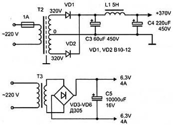

I was looking at this interresting schematic but I have a problem with some units :
Is 6ГH just mean 6H ( 6 Henry ) ?
The C1 and Ck capacitors seem to be unpolarised, not electrolytics like usual ... 68000Mk and 2200Mk ...
Did somebody know what mean this mysterious "Mk" capacitor unit ???
PicoFarad, NanoFarad ???
Alain.

Yes, its a H and uF. The schematic attached is rather dumb. 68000uF cathode bypass is a nonsense. BTW, voltage on this monstrous 68000uF is rather low (several V probably).
I would be cautious to take schematic with so obvious flaws.

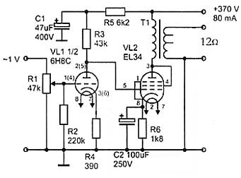

If you want to use similar but more proven design, take this schematic (it was printed in Russian-language Radio Hobby magazine published in Ukraine).
"Áþäæåòíûé" Loftin-White
Author says you can use output tubes 6S19P, 6P3S-E, GU50, 6S33S, 6S41S if you have corresponding output transformer.
Good luck !

The russian sentence :
The google traduction to english :Но наилучшим решением будет применение здесь полипропиленовых или бумажных (МБГЧ или МБГП) конденсаторов емкостью хотя бы 40-50 мкФ.
So, GloBug and LinuksGuru are right ...But the best solution is to use polypropylene or paper here (MBGCH or MBGP) capacitors at least 40-50 uF.
But like said LinuksGuru said : "The schematic attached is rather dumb. 68000uF cathode bypass is a nonsense" ...
I think the C1 capacitor can be 470uF and Ck 47uF ... Plenty enough ... It is always funny to see how some people use a bazooka to kill a mosquito ...
Thanks to all !
Alain. 🙂

If you want to build a true Loftin-White amp, you don't need either of those caps, or power supply caps of the values shown. If you're serious about building it, I'll draw up a schematic.
Sheldon

I made the AC load line of the original schematic with the 5K load and I found out there is some problems with this circuit ...
1- The 218,1V operation is over the 200V maximum.
2- The 11,36W power dissipation of the tube is over the 11W maximum.
3- The 5K load is not the best choice ...
Like you can see, a 2,5K load, 195V operation point at 54ma and a -70V bias is much better ...
1- The 195V operation point is under the 200V maximum.
2- The 10,53W power dissipation of the tube is under the 11W maximum.
3- The 2,5K load result in a higher output power.
4- The 2,5K load result in lower amplitude distortion.
5- The maximum power can be reach with a smaller signal because bias is lower ...
I will redo my Spice simulations with those new parameters next week.
That's the first step before assembling any kinds of electronic circuits, specially when the parts are expensives, Spice simulations cost nothing and the very friendly and powerfull SIMetrix Spice simulator demo is totally free and for unlimited time use ... Circuits evaluation and drawing can be done really fast with it, I believe this fantastic simulator is actually the best in the word, it can run the Koren 8 parameters models very fast, not many other simulators can do that ... Anybody who like to learn more about electronic should download this fantastic software right now !
I made many triodes Spice models myself using the Andrei Frolov software from the datasheet curves and generate back the curves with the SIMetrix simulator to compare both and believe me, they are almost perfects ... The curves in this post are made by this simulator ... Then "the loop is looped" like some people said.
Alain. 🙄
