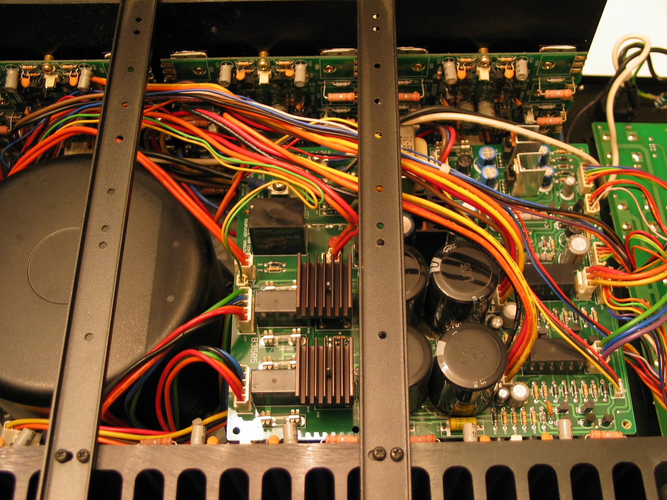

I am trying to get this 12 channel amp to function. It is a Speakercraft BB1265 – 12 x 65W @8ohms. No hope of getting a service manual or schematic. The active light on the front does not light nor do any of the 6 zone fault LEDs. It pulls 1 watt when I plug it in and about 50W when powered up. It appears to have two sets of DPDT relays for each channel pair. I can feel the first set of relays click when it powers up. I don’t believe the second set of 6 relays is opening.
I have included some pictures. It is not blowing fuses, nothing looks amiss inside. The output boards are mounted to the sinks on each side. Six separate boards - 3 per side / 2 mirrored channels per board. Across the emitter(?) resistors I am measuring about 5mV which I assume is normal bias. The sequence on the horizontal board for each channel pair I think is: (see the picture – from the left to right)

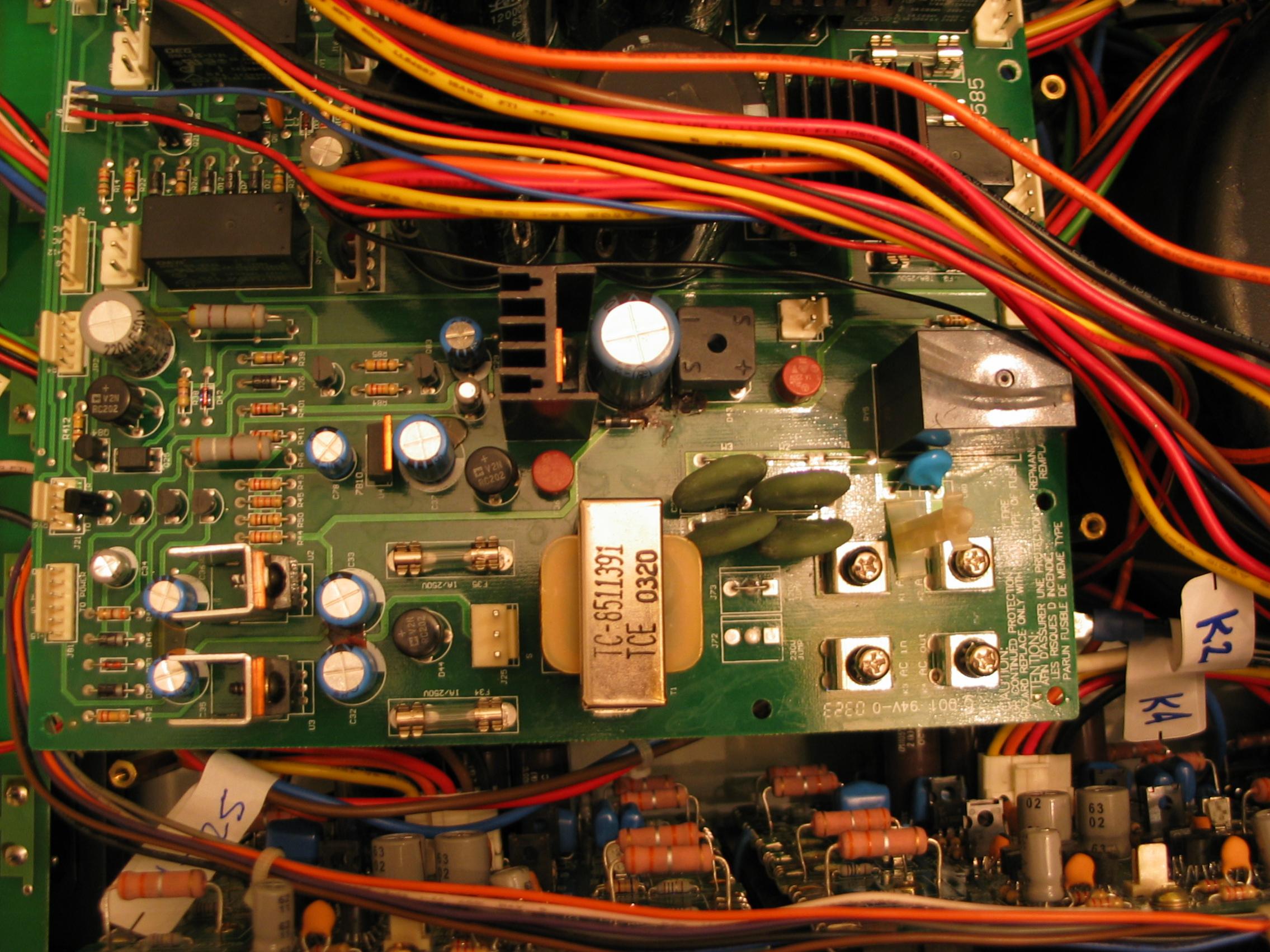

Power from transformer -5 wire connector 1st relay (flanked by 2 fuses) Rectifier (under small sink) Power Caps (2 x 12,000uF 63V) To output board (5 wire connector) 2nd Relay (not opening) To speaker outputs.

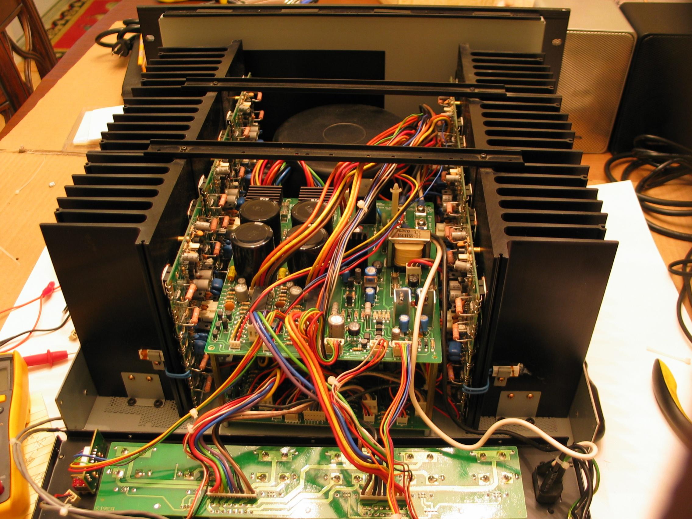

There is another horizontal board below, which has 4 more identical sets of the above (total 6 zone / 12 channel).
Now since all of the 2nd set of relays (6) are not opening, I am assuming it is not a problem with an individual channel. Before I further dissemble, and am not able to get any other powered on measurements - Are there any other measurements or readings I could take that might lead to some additional insight? Any thoughts or ideas as to what condition would prevent the second set of relays from opening (again all channels) ie.. where to possibly look or what to check.

I think you are looking at this all wrong. Does the first relay click shortly after the power is turned on? If so that's the big relay, top center of the picture. That's the in-rush circuit relay, common on all amplifiers with a toroid power transformer, the big round thing. The two relays under the big one in the center of the picture are the switching relays for the transformer secondaries, there are switches on the back to choose between 4 or 8 Ohms, correct? Those choose high or low voltage, high for 8 Ohms and low for 4 Ohms. There should be one of those relays for each pair of channels. The two on the right might be two more, follow the wires from the 5 wire connector to left of the relay to see if they go to the transformer. To find the output relays, if any, follow the speaker terminals/wires back to their origin. That's all can tell from the picture.

Now, each channel pair has a 5 pin connector coming from the transformer. After taking some readings from it, I was a bit perplexed but I think you just explained it for me. I should have posted them before but didn’t think they were meaningful. The measurements I took of the pins were AC voltage (34V, 27V, N, 27V, 34V). 34V for the 8 ohms setting and 27V for 4 ohms?
Yes, the large relay opens up on power on. So do the 6 smaller ones that are on the transformer side of the boards (left side in pic - you can see only two). The switching relays you called them. What you can see in the picture is the top card that has 2 zones on it (4 channels). There is another card below it with the other 4 zones (8 channels).
I am pretty sure it flows from left to right. The relays that are not opening are on the right side - between the wires that run to the output boards (left of that relay) and the wires that run to the speaker posts (right side of relay). The wires that run to the output board (before that relay) are also 5 pin. If I recall correctly DC (49V, G, -49V, 0V, 0V). I assumed the rails B+ and B-. Would the two without voltage be the output signal back to the speakers? If so would they then be AC?

Since it sounds like multiple channels doing this, my first reaction was missing power supply. You should have high voltage supplies for the amplifiers themselves, plus low voltage supplies for the other parts. You report a lot of the LEDs not lighting, that is consistent with a missing low voltage supply. That is the first thing I would check.

I have the top board out right now so that I could get to the underside. Getting 12V to one of those output relays when the board in is place and wired again is going to be a bit tricky. No I never have seen this on, it was headed to the graveyard and I picked it up as a learning project to play with.
The main relay is ok, it is not deformed. The side has a reflection of a resistor and diode you might be seeing, or possibly the shadowing on the top.
I added a picture of the other side of that top board. That side has the components that are for the whole amp and not the individual channels. The gunk at the base of the caps you might see is glue to hold them down not leakage. The green circular components are NTC thermistors that measure 3.4 ohms. I believe they are for limiting inrush. The only markings they have are SCK 058. They do drop in resistance when heated. I have no clue what the little red disks are yet.

There's almost certainly a small logic section doing the supervisory functions, probably runs @ 5V, uses a PIC or Atmel uProc, or some chip-level logic, 74xxXXX chips, see if you can identify anything like that. You can get a little pen-style logic driver that will allow you to momentarily overdrive some of the lines without causing damage, useful for debug.
You might have to hardwire an override of some of the safety features to get some functionality, but that would be a partial win.

Eureka!!!
Those little red disks ARE FUSES. 1 amp 250V 372 series micro fuses to be exact. Refer to my last posted picture - The one that is to the left of the main relay and to the right of the rectifier (above the thermistors) is OPEN. The white connector just above that micro fuse leads back to the toroidal getting power. One leg of that connector leads to one “S” source? leg of that rectifier. The other leg of the connector runs through that blown fuse and then on to the other “S” leg of that rectifier. The missing 12V DC that opens up those output relays must be coming from that un-powered rectifier.
Now I am not going to get too happy just yet. I am fully expecting that when I put a new one in that it blows right away because of some other yet to be resolved issue further in, but at least now I know where to look and can trace it. They are $0.40 a piece so with $5 shipping I bought a few extras.
Enzo-
You were correct all along, missing low voltage power supply.

“S” source? leg . The S is a symbol to mean AC.
Obviously, the two S legs on the rectifier are its AC inputs, the + and - legs are the DC outputs.
This is perfectly consistent with an S going to the toroidal and the other S going to the toroidal via the ( blown ) fuse.
