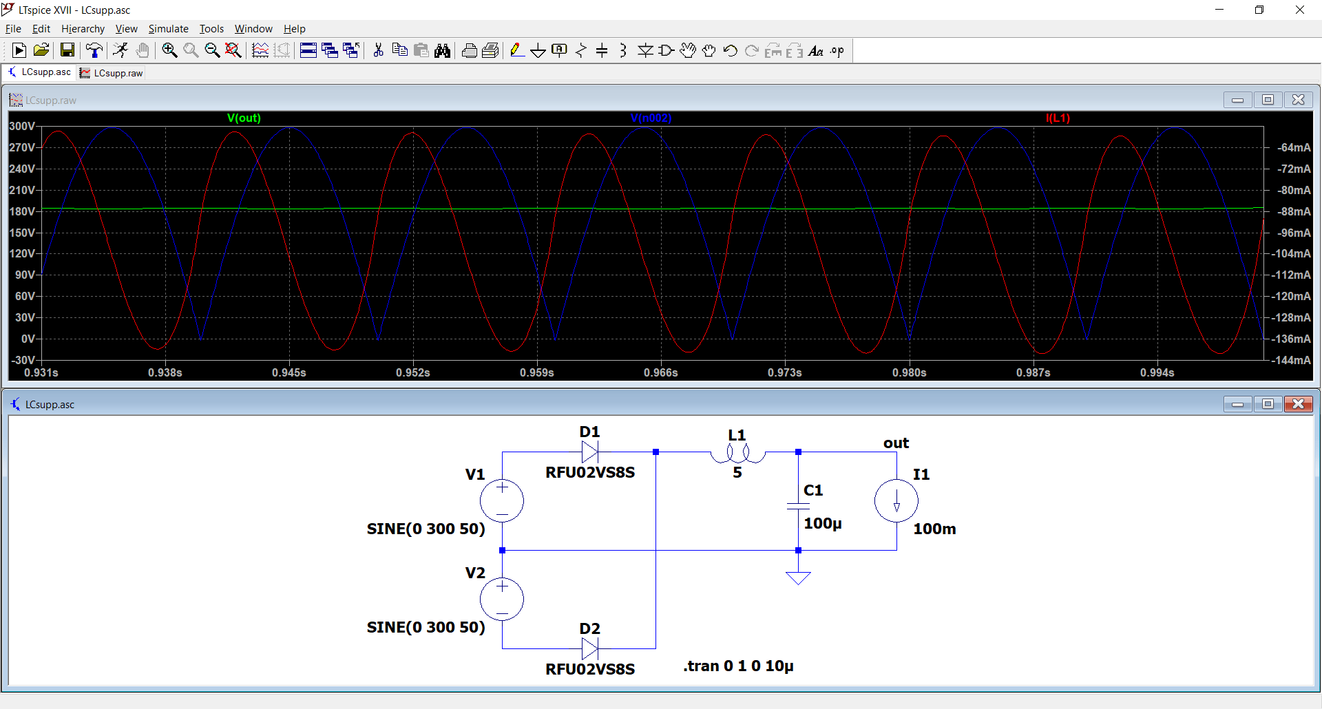

Udc is the rectified DC voltage after the choke. Some other tips:
Vrms across the choke is close to Vrms secondary x 0.5. This is also important.
Flux density of a choke for input duty is a balance between AC flux and DC flux density.
AC flux density across the choke is calculated via B = Vrms / ( 4.44 x F x Afe x T ); where F is mains frequency x2 (100Hz and 120Hz)
In the end, a choke for input duty requires AC flux density headroom, hence it will need a larger core area considering other parameters (Idc, Rdc, Inductance) are kept the same.
Critical inductance increases together with the rectified Udc voltage for the same current, due to the reason a higher Udc to current draw. For example, critical inductance for a 10Vdc 50mA power supply will be 200mH, but for a 1000Vdc 50mA it becomes 20H.
I am not that sure about this: the induction B is going to be proportional to the current through the inductor, assuming the magnetic parameters remain constant ( which they should, more or less if the choke is designed to be well-behaved; swinging chokes are somewhat different).
The formula: B = Vrms / ( 4.44 x F x Afe x T ) is a clever mathematical shortcut avoiding to deal directly with the permeability of the core in AC devices like transformers which generally have a gapless magnetic circuit. Computing the current in those conditions would be a nightmare, which the formula elegantly avoids.
However, we should never put aside first principles, ie. proportionality between B and I, for a "perfect" inductor.
Such a choke is used to smooth (=average) the current, which means that ideally, the instantaneous current should not deviate too much from Idc, otherwise the filter doesn't do its job properly.
The current will fluctuate though (slightly), and the calculation should be based on the peak current, which can be derived from the circuit's values, and another "shortcut" formula, like B=L*I/n*Aeff
Care is needed to separate the two limit scenarios when using a choke input filter.
The classic scenario is when there is a lot of choke inductance, and the current through the choke winding is dominated by the DC level, with the AC variation being a relatively small-signal cycling on the B-H curve. The inductance measurement for that situation is an incremental inductance measurement at one location along a BH curve (determined by the DC current), where the DC operating point is likely up towards where the BH curve is starting to roll over as it approaches saturation region (ie. as commonly shown in choke performance curves where the inductance is starting to droop at higher DC currents approaching the DC current limit for the choke).
The other limit scenario is where there is a low level of choke inductance, and the choke is operating with a large current swing, with one portion of the current cycle where choke current starts to reach zero (and the choke voltage is then influenced by parasitic effects). The choke inductance varies throughout a mains cycle as the BH operating point cycles from down near the BH origin (choke current reaches zero), to up in to likely the saturation region (where DC + AC current is maximum). The BH operating locus is not a straight line, so incremental inductance varies along the locus, and that variation will depend on the core being used, which is one reason to be cautious when doing simulations.
The 'critical' inductance value that influences whether the choke current reaches zero is better assessed by measurement of incremental choke inductance when DC current is quite low. The benefit of the swinging choke is that it provides a high inductance at a low DC current level, but the inductance doesn't rapidly collapse when there is high AC+DC current. When using an E-I lamination core, that can be allowed for by alternating E's and I's in batches, rather than stacking E then I then E ... as in a typical power transformer - this is a similar situation to what is commonly done in output transformer cores to allow them to handle some level of push-pull current imbalance. Other plausible core construction methods are a little more complex, like the commonly seen stacking of all E's on one side and all I's on the other side and butting them together with specific gap separation, but with a variation such as using some percentage of E's that have shortened legs, or displacing some of the I's so that their gap to the E's are different, or the simplest method of adjusting the stack of I's so that it forms a gap with an angle (smaller gap at one end, and larger gap at the other). So lots of opportunities for DIY experimentation.
And of course the practical benefit (if a choke input filter is a requirement) is that a swinging choke can be physically a lot smaller than a standard choke.
PS. I note my post #32 makes an incorrect comment about diode commutation when choke current reaches zero, but too late to edit that now.
I believe there is a kind of feedback going on that can be explained via these simple formulas. When an inductor enters saturation threshold (knee of magnetizing curve) via DC, permeability drops, hence inductance as well.
The moment inductance decreases, flux density does that too, due to the formula B = Idc * L / T * Afe. Not necessarily 100% linear (at least taking ohmic losses into account), but this feedback mechanism keeps the core from reaching full saturation.
It is linear enough however to keep a swinging choke into a choke input critical region. Tested that in practice on a class AB amplifier with a gapless 600mH choke from 100mA idle current ramping up to 2A.
I think the easiest way to reach absolute saturation is to be done via alternating voltage amplitude.
This is what I mean, based on this example:
The inductor is linear, and the peak current is 141mA for Idc=100mA. The ratio of B^ to Bdc is thus 1.41.
You can make the calculation of the peak induction by adding Bdc and Bac. I am not going to write down all the equations, because it would be fastidious without a formula editor, but both have the common factor n*Aeff.
When you make the ratio of Btot to Bdc, this factor disappears, and you arrive at a value of 1.94, much higher than the actual 1.41.
The situation would probably be different with a highly non-linear inductor, like a swinging choke
  • LCsupp.asc
