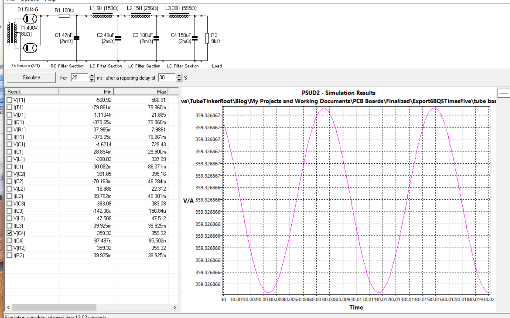

I'd like to use a smoothing choke as an input choke in this over-the-top PS, Triad model C-14X 200ma 6H. As you can see the ripple is extremely low and I have a boatload of chokes and a hankering to use them. The current across L1 is RMS 50ma 30ma mean and maxes never above 86ma as the model runs. I'm assuming this circuit meets the minimum load and inductance for a choke input to be working properly? I chose a 200ma choke to make sure I had enough headroom for both the DC and AC load as I only need 50ma across it. Is that enough room to make using a smoothing choke just fine here? I've been on a few ham radio boards and many say smoothing chokes can work just fine for choke input. But I was also just reading Merlins new book where he mentions problems using a smoothing choke. What are we to do when the market no longer makes dedicated input chokes? If derated enough shouldn't it be possible to use one? How am I doing here, this C-14X will be potted BTW.

PSUD2 doesn't simulate a swinging choke, and imho any sim of a choke-input filter supply needs to be taken with a lot of caution, as the choke model being used is just a simple ideal inductor. The user may not have measured the choke (or relied on manufacturer data) to obtain a good awareness of what inductance is being exhibited by the choke in the application.
The region of the operating cycle that is of concern is when the choke current approaches zero (ie. not when the core has max current and is entering its saturation region), as that is when the diode is again forced to commutate off and on (in addition to the normal commutation when the diodes alternate conduction during each half cycle of mains).
Maybe I'm not finding a good enough datasheet for the triad C-14X, but it has no definition of voltage conditions for the inductance spec, only a DC current spec.
As shewn both those PS sims are Cap input limited by a series R & the PT characteristics.
Its only a .047 uf capacitor so it was my understanding that the circuit shown is operating still as primarily choke input. Some things I've read suggest a small capacitor there for oscillation.

You might want to include a small resistor in series with that cap. It won't show in PSUD, but will help to damp the transformer's ringing following diode transitions. Stuff gets everywhere. Maybe something in the 100 Ohm to 1K Ohm region.

I see, psud wont do that but when I get it on the breadboard I'll note this.
