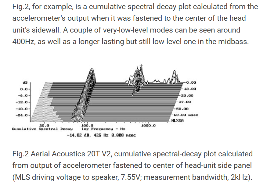

very interesting http://www.troelsgravesen.dk/JA8008_DTQWT.htm
http://www.troelsgravesen.dk/JA8008_DTQWT_cabs.htm
i see 32mm MDF for front baffle Quite a lot indeed

It's not necessarily the front panel, many other plausible reasons already presented by the community : )
My 3way system bass box front panels are almost non-existent and sound felt boxy at least at the beginning. It has calmed down since, either I've got used to them or my xo is better than at first, there is also huge plank of wood crossing atop now, positioning is different, I changed the innards some and so on. But I didn't do anything to the front panel. Just an example that there is rarely any single thing that makes sound something. Sometimes there might be, but often times when one fixes a "single thing" something else gets wrecked as trade-off and it didn't actually improve things, just changed them around. So, always think trade-offs, prepare to do at least one prototype box before committing to piano lacquer because it is a chance to improve your initial attempt. Make two prototypes and you'd likely have so much better system which you can prove by the data you collected and improved upon with every proto.
I mean, you can make hypothesis that front panel makes boxy sound, and then reason how to reduce that. You can practice this kind of imagination play of various speaker concepts in your head and what their strengths and weaknesses are. For example, to mitigate sound of front panel you could minimize the front panel area so that volume displacement goes way down. Or, you could decouple the driver / panel so they never touch, dampen it, brace it, make it thick, what ever you feel like is necessary. Connect the driver from magnet instead of the rim, use force cancellation, what ever you come up with. But please also consider what the trade-offs are for each of the options you came up with to be able to determine which one is worth it and not against your other "requirements" for the project.
For example, if you make very thick front panel it increases mass, perhaps stiffness. But what else? You could now utilize the thickness to do big roundovers to mitigate some edge diffraction issues as well, thats good thing. What are the problems then? It's likely quite expensive / laborous to make so can you do that? It makes a heavy box so can you reliably measure that in a spinorama? Also back side of thick panel needs processing, otherwise the drivers are in a tube basically, and whether that matters or not depends, but might be one trade-off in sound. It would also reduce inside volume compared to outside volume, be more costly and laborous in general, and so on. So, why not make the front panel just very small instead? So small it's perhaps few percent of the cone area and basically cannot radiate sound that would make any difference? Well, this makes the box volume very small, what's the trade off with that or is there any, can you make this trade-off disappear just by system design like adding another bass box? Big roundovers don't fit to small panel, but does it matter? It's easy to manufacture at least, because there is about nothing one needs to do. And so on. Find questions, then answers to those, and soon you'll have huge catalog of various techniques to solve various "issues" in your head.
To help come up with questions: What ever problem (like boxy sound) and solution you come up with (like thick front panel), think what you did not consider while doing this? Find at least one trade-off, like cost and complexity, and consider if it's worth taking. Often, considering / obsessing for one thing we tend to forget other things, or not see bit further in the future that our early decision now prevents doing something even more important and the system endsup with a bad compromise, a wrong trade-off taken. For example why do you need a front panel in the first place, or a box?
For example, if you chose the very small front panel route to mitigate any box noise of front panel, it would make very different loudspeaker system, as one with big 60cm wide front panel. And to make any sense to endless possibilities you now have in your hand, you must first and foremost set good and realistic goal for your project, figure out some fundamental properties of the system that must be fulfilled, a priority list, and then align every small detail compromise with that priority list. So, for example if cheap cost and small size are highly important to your project, then some simple baffle it is, perhaps add extra bracing. If sound is priority above all else, no tight cost or size constrains, then by all means go ahead and brute force a front panel if you wish.
Have fun!🙂

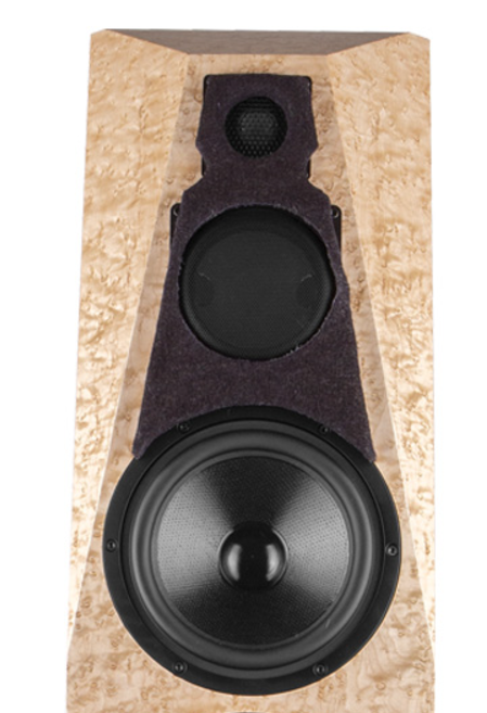

to be more precise this is the original speaker
https://www.stereophile.com/floorloudspeakers/663/index.html
if it sounds boxy i will surrender To boxyness i mean

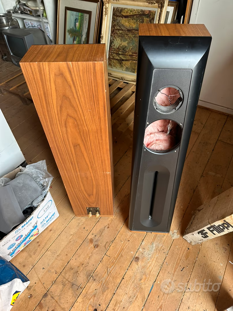

What i am planning to do is to gut a decent speakers pair and transplant drivers and xover in a cabinet better on paper at least I know quite well the sound of the speaker Decent but nothing remarkable I am curious
For sure those Thiel have an impressive baffle I could never build something like that

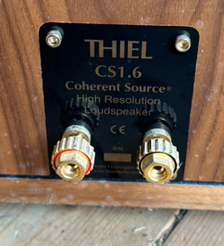

Saturday I will get the scheletons of the Thiel cs1.6
I have just to find a good 6.5 woofer

Hi me again and sorry but i really have to ask If i had learned one thing is how important is the behaviour of the front baffle when excited by the woofer vibrations
The comment on how decisive is the design and construction of the FB expecially for open baffle speakers has canceled any doubt
Then why at Stereophile Mr Atkinson uses to place accelerometers everywhere but on the front baffle ?
https://www.stereophile.com/content/aerial-acoustics-20t-v2-loudspeaker-measurements
Hmm. The amplitude of vibration is probably of secondary importance compared to it's spectrum and distortion.
A few members mention the importance of the axial direction of bracing. It seems preferred if the braces radiate out along the same vector as the wave propagation, not criss-crossing. If you think of ripples on a pond, you don't want hard 'impacts' and reflections as the sound wave suddenly hits a brace glued at right angles.
I guess that the further you go from the driver, the more resonances are likely to be picked up.
