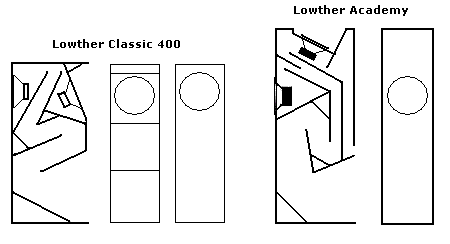

So the "boxy" sound is not just attributable to a box-shaped cabinet? What about labyrinths, folded horns, etc? Everything inside the box (I don't mean bracing) serves a function to conduct the back waves of the diaphragm, get them into phase with the front wave, etc. I built the Troels DTQWTII and the walls don't shake even at high volumes, and the sound floats in the air. Theoretically, it is a horn and has the same virtue as when Ginetto61 puts his wind-up music box in front of a speaker cone and discovers that everything sounds better... cup your hands behind your ears when you listen, and everything changes dramatically too! If you conclude that I am a horn fanatic, you are right.....😉
