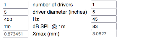

What should I expect for increased low frequency distortion?
Expect ~10% second harmonic distortion at Xmax.
With only .9mm Xmax, the midrange driver would reach 10% distortion at only 86dB at 100Hz.
