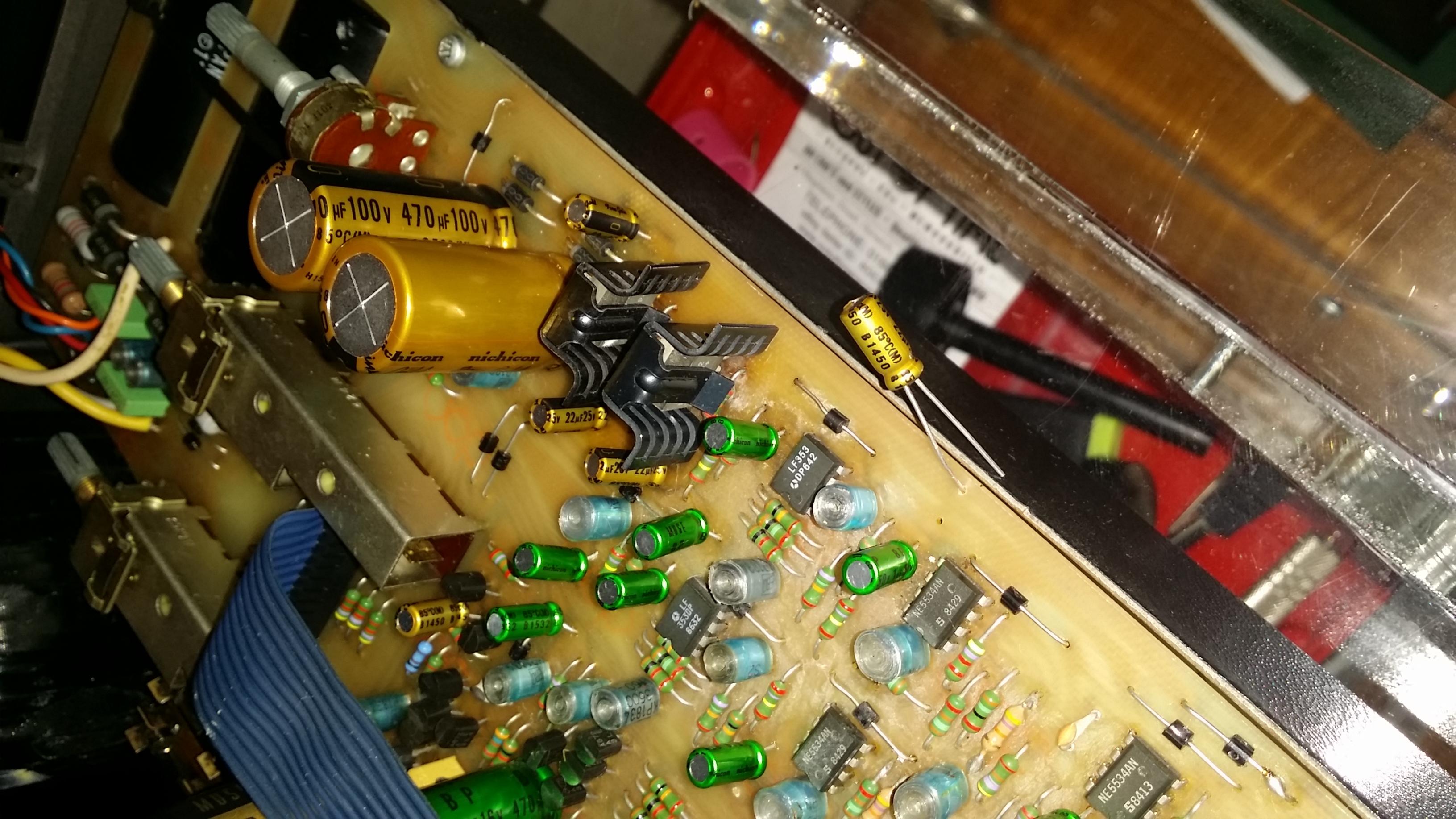

thread hijack apologies ... very early cyrus 2 question !
(sorry, if this question would be better as a fresh post, I'll do that if you think it better.)
I've acquired a very early cyrus 2 and I've replaced all the electrolytics apart from the big 10000uF supply caps.
what's odd is that unlike any other cyrus I've seen there's no polarised 22uF cap where c71 would be. i say would be, but this cyrus is so old it has wired on/off switch and no markings on the circuit board ie it doesn't actually say c71 on the board or anything else for that matter. There's holes where I'd expect a cap and there's solder traces , whereas other empty / unused holes on the board have bare copper.
I can't find either a cyrus 2 service manual (i have a cyrus 1 circuit diagram) or even a photo of any cyrus 2 this old.
see pic ... (I've marked the spot in question with a new cap for the pic)

thanks for the link , I've half a chance with a cyrus 2 service manual ! thank you, I only found a cyrus 1 service manual before so that really helps.
amazing that I can't even find a photo of a 2 as early as this one with no board markings, must have been interesting fixing them back in the day with an unmarked board ....I have to say the soldering on this one is worse than mine ! mission/cyrus might not have changed the basic circuit over the years but the build certainly got better. Having said that , the plastic covers hold up well compared to the later nextel covered cast ones, and it's handy that you don't have to mount/unmount the output trannies from the heatsink every time you want to lift the board or test it with the earth reconnected. Plus the early ones have bias adjustment presets fitted and an electrical on/off switch rather than the plastic linkage thing that generally broke ...

The missing cap looks like it connects to the diodes nearby ?
That suggests either some rail decoupler or perhaps something to give a time constant to minimise switch on/off noises.
If its not been fitted from new then it is that way for a reason. Fwiw, it is common to see blank component spaces and various used/unused 'options' on PCB's.
Thanks Mooly, yes there are other unused mounting holes, was just intrigued that this pair looks like there has been something fitted there, and that every other cyrus I've seen has had a 22uF between those two tracks. Anyway it sounds good and I still need to restore the main switch, so really I'm just being greedy while I'm in here with a soldering iron and have a bag of nice caps , rank amateur that I am. This one hasn't got the slit foil main supply caps they later fitted, not sure how much of an improvement they are, or if the volume switch could use an upgrade ....
as an aside does anyone know what the barrel shaped light blue capacitors in the pic are ? all the other cyrus I've seen have had green box shaped (film?) caps. Hope fully these stay in spec and are as good, but can't help wondering why they stopped using them.
C71 appears to be on the output of the LM317 reg (07 version) and is C68 in the 06 version. So both versions seem to have it, at least on the diagrams.
You would normally have a cap on the output of a regulator (although for the LM317 it is optional) and normally it would be a small value in the 1uF to 47uF range.
There can be valid reasons for having unequal values of cap between the rails or having no cap at all, and those reasons would be related to start up behaviour (the fixed 78/79 series regs can latch up if one rail appears before the other) or it may be to minimise audible noise during power up.
If you think one has been fitted and then removed by someone then you could try a small value polarised type.
