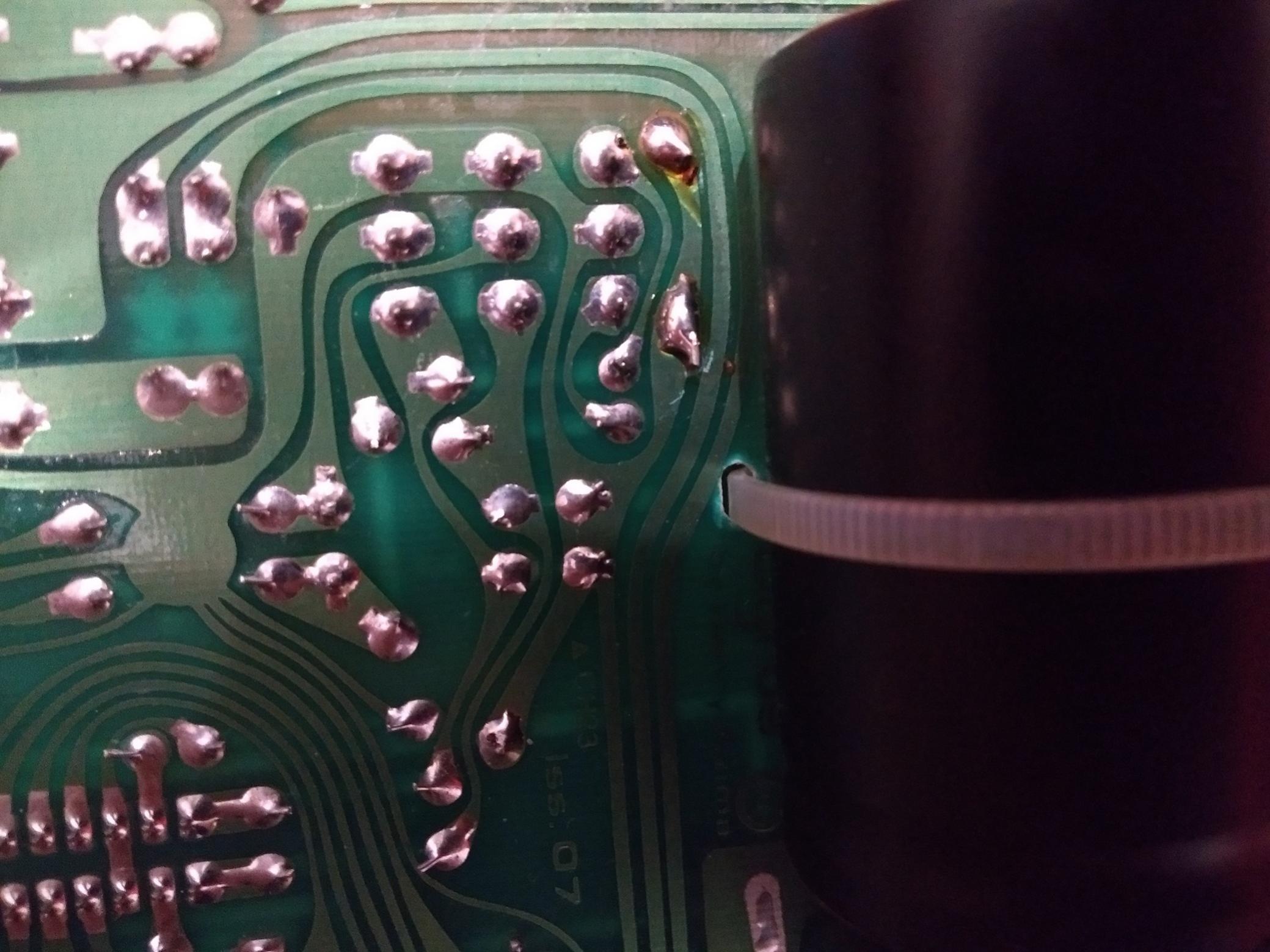

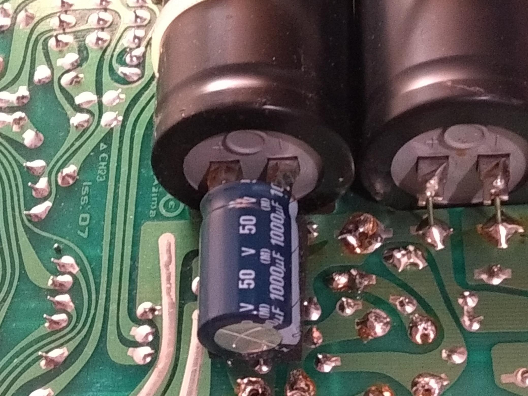

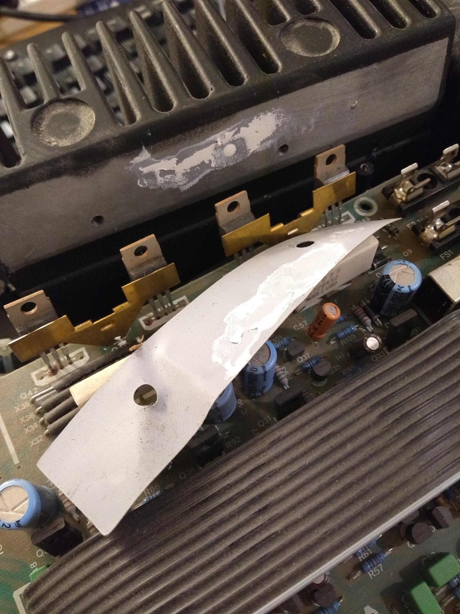

Yes all I did was unscrew it. I got some pads too, cpu etc. the left channel (maybe right) you can see the pad is a bit wonky. Thats the channel that's blown! It has muse bipolar caps under the ribbon, I didnt think modern caps were used since its such an old amp!
First pic Cyrus should be ashamed! Second pic what the hell is that? I have never seen a random cap added to a big cap like that before! its on C65. Looks factory done! Elna cap too

The factory could not have fitted newer parts like that additional cap. It's probably there as Mr Fixit's quick way of augmenting or patching over a duff cap. with all he had on hand. If there was a power supply buzzing noise, that's the cheap and nasty way to make it disappear for a while longer or at least until the unit was sold.
It seems as if that's a cast heatsink from a Cyrus 2 in your pic. and as Chris recommended, the surface needs to be smoothed and perfectly flat for reliable operation with such small power transistors, where heat transfer is already marginal. If you use thermal transfer grade silicone washers or sheet instead, you can expect more failures unless you keep the maximum power level down. How you do that is beyond expectations for any normal user but if I said to polite volume levels, perhaps that has a clear meaning?

The plastic pad you found is a thermal transfer insulator. I hate them, the grease was probably to stick it in place long enough to screw things together. Now would be a good time to either use mica and grease, or one of the newer thermal pads. Either option really improves thermal performance. While you have this apart, take a fine, flat file and carefully make that mounting surface smooth. The way it is is too rough. THeir later amplifiers are even worse. Even under warranty I would spend the time to file them flat. This is the only criticism I have for Cyrus. I have a pair of Mono-X amplifiers that I got new. They will be coming apart soon for detail work, and making the mounting surfaces flat is #1 on the to do list. Getting rid of those darned BFA connectors for the speakers is #2.

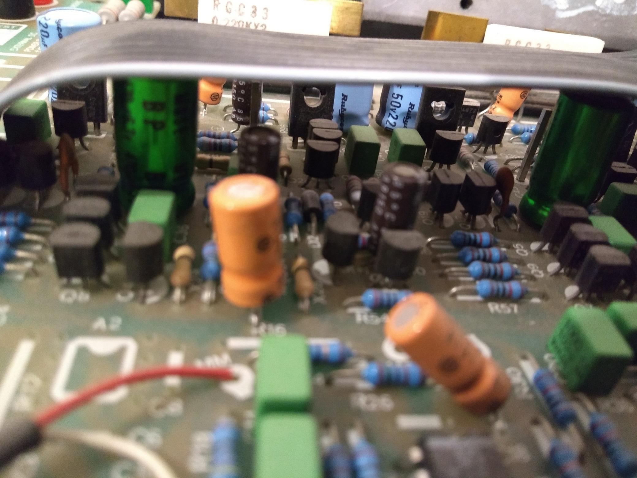

The drive (driver?) transistors measure really good above 600 (is that volts or ohms?) on each leg and are original MJE253 and MJE243. I read that the BD transistors can be used. I actually accidentally purchased a few of these not sure if I have 2 pairs and I rather keep original MJE in place but swapping them out could be an option.

Notice the green muse caps in 3rd pic? Its factory fitted the solder is consistent with the rest! The Cyrus is the latest model with the toggle switch but never seen that cap in all the internet pictures!

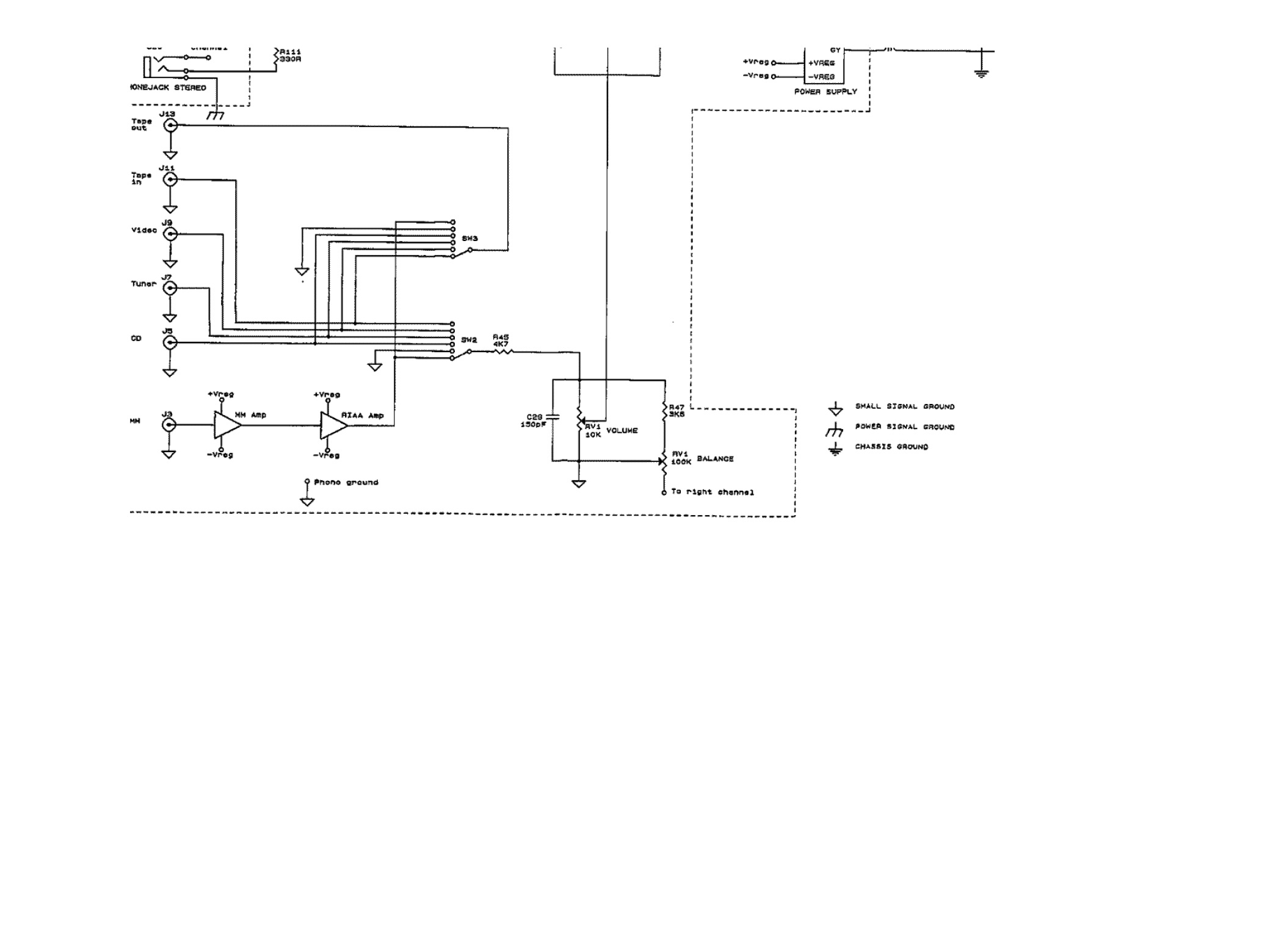

The Alps is suppose to be a lot better! Also its genuine even for £6! I suppose its like $10.
I added the schematic cant it just be bypassed or moved? Never seen that type of setup before. It doesn't hurt to consider it!

Read my previous posts again please. One change at a time only. The new control may or may not be the real thing. Wishful thinking does not make it so.

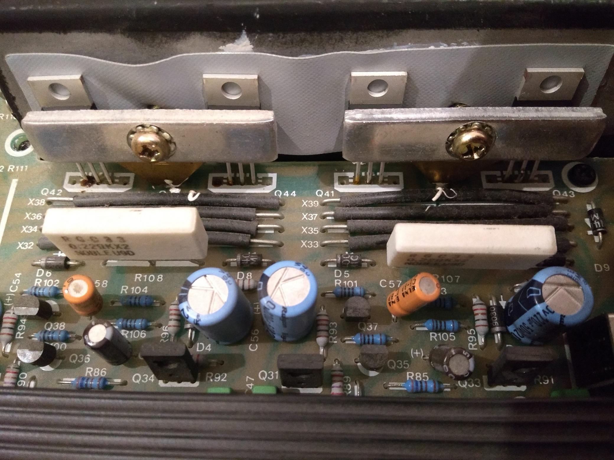

Success! Output transistors replaced and no blown fuses!
Tested quick power on with speakers an input works fine.
Tested bias and in a few minutes it already reached 20mv and rising. I stopped it there just in case it blew. On the SM manual it says if its too high to place a 180r resistors between the two terminals. Should I try to find a close value and try it?
