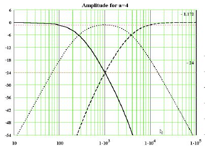

Now bear in mind you are trying to get this sort of (below) frequency response.
Shouldn't be too hard. 🙂
