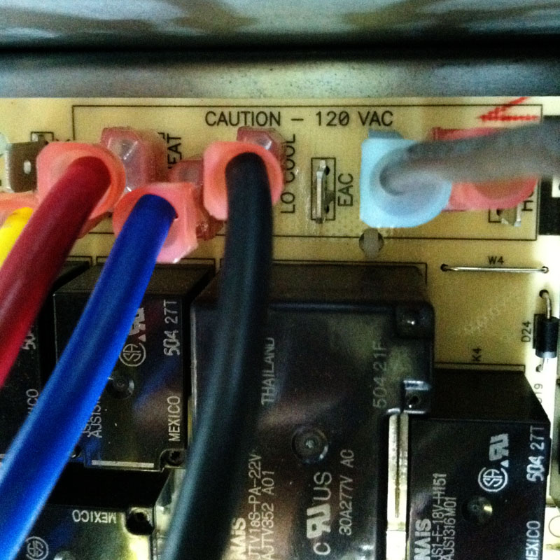

I don't have a lot of choice. The picture I posted is all I have access to. I'll do it on the left side as close as I can to where it heads into the ceiling. If this doesn't work I am SOL anyways.
EUREKA! This beautiful little tab called "EAC" is an Electrical Air Cleaner, and I don't have one. I read the installation manual where it describes the operation of the furnace in detail. EAC is always on when the fan is on, 120V!
One last question. When I plug everything in, can I just pull the breaker for the furnace (as long as it's not running when I do it, and cause ventilation issues)?
You can shut off the breaker or the service switch on the side of the unit. Either way the power will be off. Good find on that terminal. That will make it simple and you will have it for all seasons.
I got the fan in, but the wiring is still in progress. Romex really isn't suited to hooking up to the control board. It's way too stiff.
I'm trying to stick with the wiring specs already inside the furnace, but that wire is really hard to find in small quantities. In the manual is says all wire inside the furnace must be rated to 105 C / 221 F, which excludes regular THHN wire. It's UL1015 PVC coated stranded stuff. Everything on the control board is between 18 and 14awg. The blower fan itself is on 18awg UL1275, but that is practically impossible to find, as far as I have seen.

The booster installation manual says 14awg wire, but I would think 18awg is fine for in the furnace sine the big blower fan is 18awg and the booster only draws 0.4A.

You need to run 14 because that is code minimum for residential. Just use some THHN from the board to a j box to connect the romex to. It will work fine.
All set up. I'll be observing everything over the next few days, but it appears to be working perfectly. I ended up putting a box in the ceiling with a switch. THHN runs from the furnace control board in flexible conduit, to that switch box, into Romex which runs through the ceiling to the fan.
