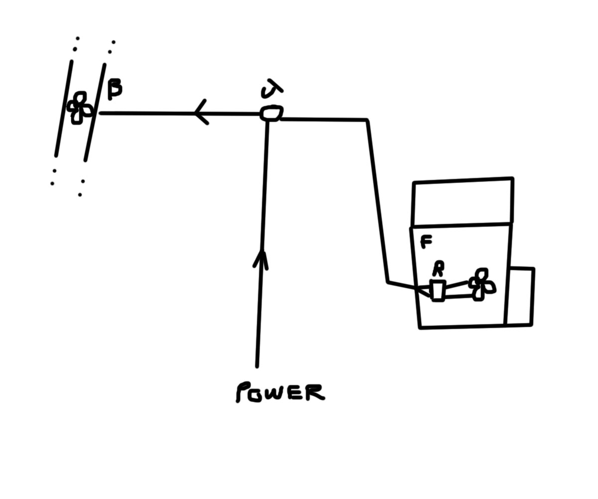

I need a relay to control a duct booster fan in my home (120VAC, 0.4A). I believe I found the fan wire from the thermostat (green), and I thought I read somewhere that it runs off of 5VDC. So, I need the 5VDC to trigger the 120VAC on.
What kind of relay do I need and where can I get it? I need something I can put in a regular electrical box. I have looked high and low locally, and no one sells them. I got this DPDT @ Radioshack today, but I am so confused by the additional leads, and I don't even know if it's okay to put this in an electrical box. Help?

Install a contactor in the HVAC unit that is triggered from the main fan or the fan output on the board. You don't want to run it off of the t stat otherwise ther will be no delay and the fan will run when the t stat closes and blow cold air unitl the main fan kicks on. This will aslo ensure that when the HVAC breaker is turned off there will be no power at the booster fan.

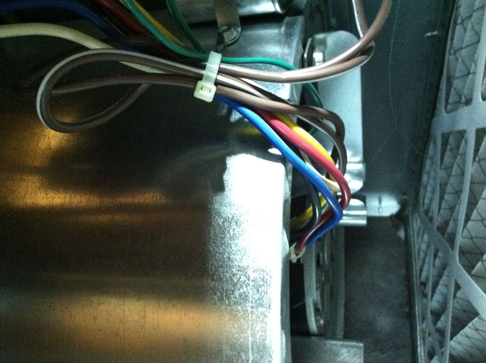

The blower in the pic isn't the main fan. It will be bigger and should be located on the supply end of the furnace.
Ah... see this is why I was hoping not to have to mess with the furnace itself. Right, that would be the direct vent blower.
The filter is on the bottom right behind the control board in the pic. Would it be behind there?
There should be an output on the board marked blower or main fan. Connect the booster fan there or any point along that wire and the other to neutral. This will allow the booster fan to work in conjunction with the main fan. You can just cut the wire and wire nut them together. It is not a heavy current fan so it will be a simple tap in.

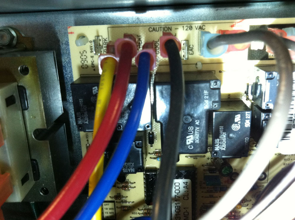

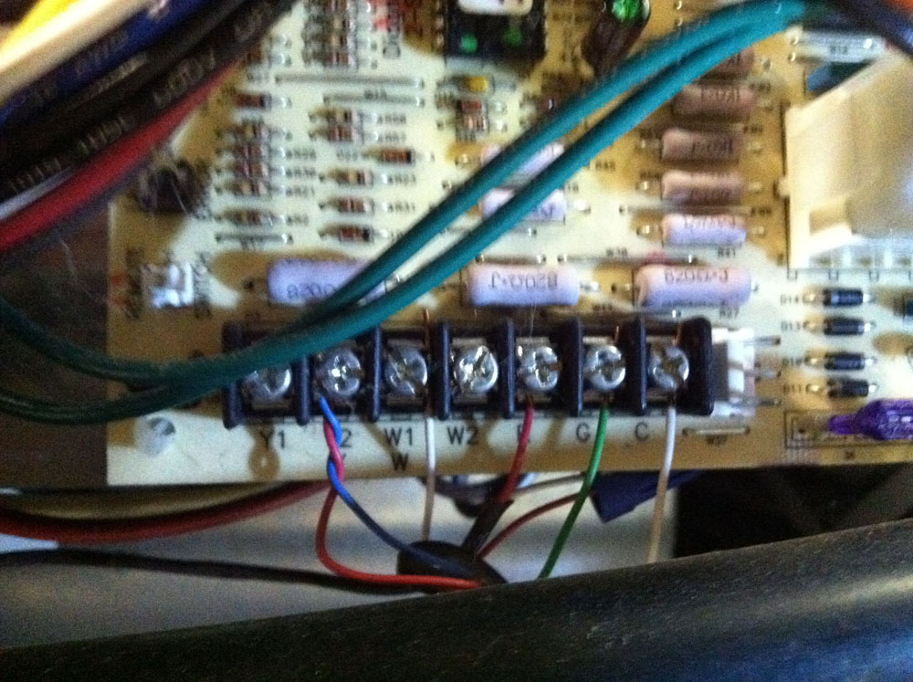

Aaaaaand a bunch of pictures. There doesn't appear to be just one fan wire. It might be a trick to find a fan wire that's just "on". It seems to have "cool lo", "cool hi", "heat lo", and "heat hi", which are all separate wires. However there is currently a jumper set on pins that say "heat lo" next to them. And I don't know what to use for the Neutral.

The blower fan in the furnace runs on 120 volts. In your second picture you see five wires on the board. The white is your neutral. Use that for one leg on the booster fan. The blower most likely runs on low speed for heat and that would be the red wire.
If you have a meter then verify output when the main blower is running then you should have 120 volts at the red and white wires. Connect your booster fan there. If it is running at hight speed then it will be the white and yellow wires, Just verify how yours is set up with a meter while the blower fan is running. You will not need a relay.
Verify the voltage on the booster fan. It should be 120 volts. This will be a simple install. You will probably not use the booster fan for A/C since the A/C will run at a higher speed. This is just to get some extra heat to the far end of the trunk line to take the chill out of the room.

118.3V from Red to White. The wire that looks white in the pic is actually grey, but I did find the white and it indeed goes to a pin marked neutral.
So then... I should just run 14-2 straight from the furnace control board to the booster?

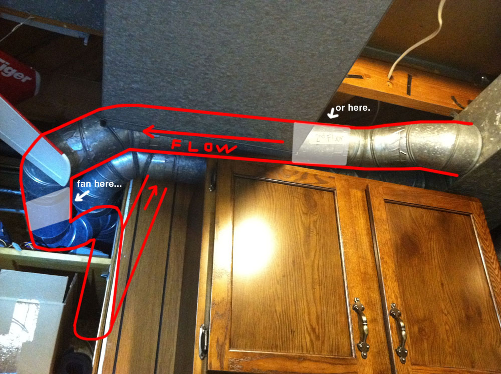

This sounds like the air flow has fallen out of design targets. Or was never set to design targets.One issue with what you said. We most definitely need the booster in the summer. Our bedroom (the room that needs a boost) is 90 degrees in the summer and 50 degrees in the winter. We'd like to split the difference there! The room literally has no pressure on it's vent.
There is usually some form of adjustment in the airflow ducting and/or outlets to adjust the resistance. I suspect these need some attention.
The attic was popped up and finished in 1958. I think it is likely the home owner did some of the work, or standards just weren't the same. In addition, the insulation probably isn't very good up there. As I said before, this duct line is at the very end of the main trunk. It twists around a bunch before heading upwards, and it's only a 6" duct. I don't think there were ever design targets. If ever we can afford to remodel the house, these issues will be fixed, but there isn't much I can do now. I have opened or closed every baffle trying to get some air to flow up there and nothing works. Our neighbors had this same issue (same style of house) and a duct booster helped them a lot.

That's the duct I am boosting.
