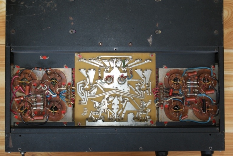

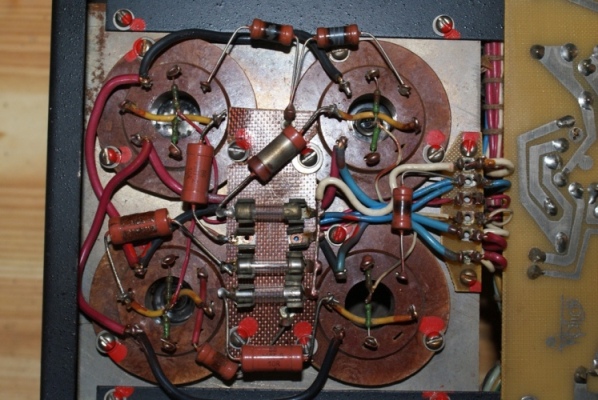

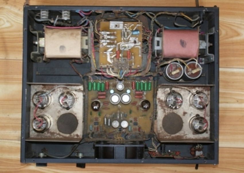

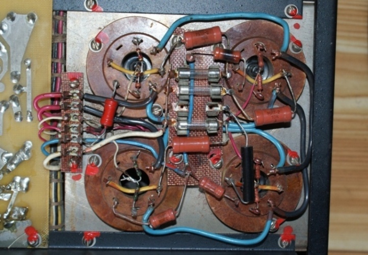

Yesterday I checked cathode currents of pA500.
After 4 hours of work:
VL1 ... 41.3mA
VL2 ...
VL3 ... 41.4mA
VL4 ... 46.5 mA
VL5 ...
VL6 ... 49.2 mA.
Here are some pictures

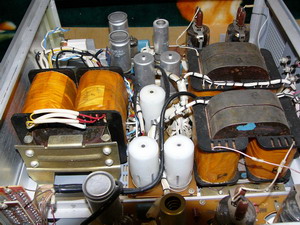

This is Soviet Union (Russian) tube power amplifier, named "Priboy" or "Priboj" or "Priboi".
If somebody wants, i shall put here full circuit of this power amplifier and photo of this device.
In Russia this power amplifier is costs about 10000 rubles (300$ - 350$).
