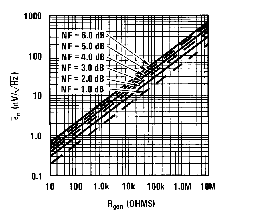

PF5102 on the graph is process 51 jfet, I guess that J111 family is similar? Any links for the noise measurement of J112/113?
If you're talking about the En vs Id graph I attached, then no: it's a Toshiba 2SK147, it has a large geometry, a Yfs of 40mS, an En of about .7nV/SQRT(Hz) @1KHz, and of course, unobtanium. Attached is a full datasheet from Sanyo, which is technically the same as the Toshiba.
The J111, with its medium geometry, a Yfs < 20mS, and a En of 2nV/SQRT(Hz) @1KHz is not in the same league.

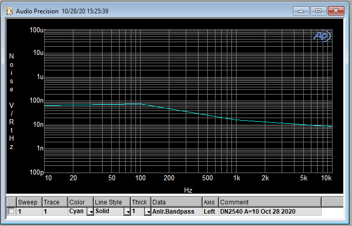

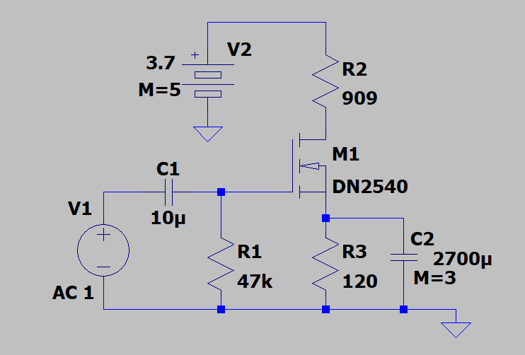

I don't have noise measurements or noise specs for DN2540, but have built some amplifiers with it and found it to be very quiet. Run at about 5 to 20mA, and cascode it to eliminate g-d capacitance variations with voltage. With a cascode and source degeneration resistor (about 300 ohms) to set its current, it will have extremelt high input impedance limited only by bias resistor and is capable of quite low distortion, too. (Running at higher Vds might work rather than a cascode, I didn't though).
Not at all in the same class, here's some input noise data -- running @16mA, gain=10

Why does it level off and even slightly drop below 100 Hz?

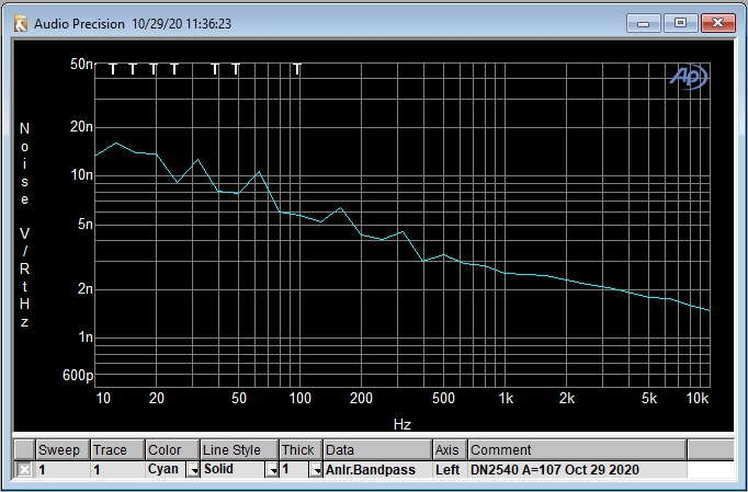

Re ran the test again with a bunch of DN2540's -- the graph below is the best one.

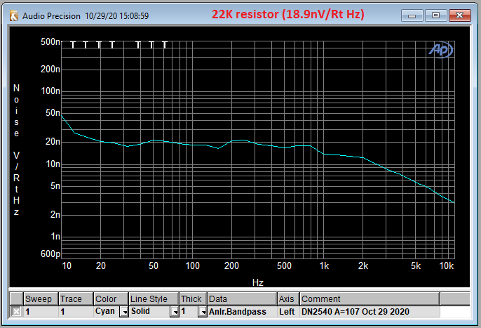

Reconsidered the setup and ran the test from 1kHz to 10kHz, 18.5V supply (5x Lithium 18650 cells), Rd=909R, Rs=120R with 2.7mF * 3 in parallel.
Edit -- as a sanity test ran with a 22k resistor which should have 18.9nV/Rt Hz noise)

The resistance is below a square root, so theoretically the difference is 32 dB - which is still a lot.
However, that 3 dB at 1 Mohm for the 2N5459 is in the maximum column of the datasheet. The exceedingly high value can simply mean that Fairchild used a cheap production tester that can't measure noise very well or that they had difficulties measuring noise properly in a production environment with lots of interfering equipment. It can also mean that their process was not that good and occasionally produced a very noisy device.
In any case, when you look at the second graph at the last page of the datasheet you linked to, you see that the typical noise at 1 mA drain current is only 4 nV/sqrt(Hz).
