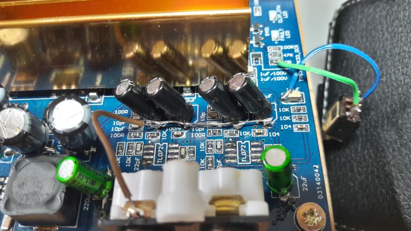

Desolder the opamps and ground both TPA inputs with the coupling caps in place. if noise is gone, it comes from the frontend. If noise is still there, you fried the input stage in the TPA which usually happens with more than 9V on each input pin.

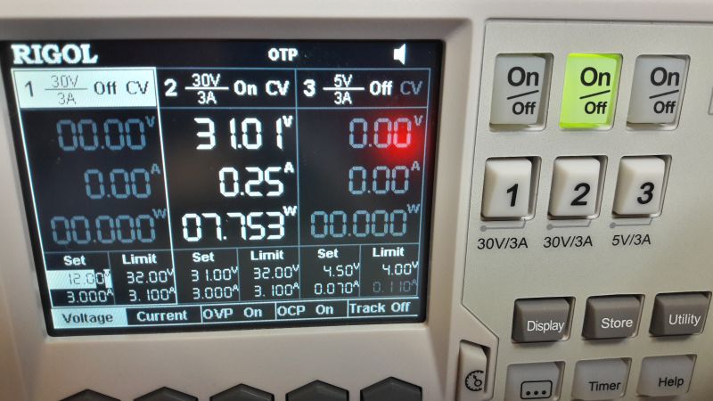

as expected the TPA3255 is damaged.
pic 1 shortcut as doc mentioned - hopefully correct done
massiv noise at left channel - right channel generates a switch off the amp while i am but a speaker in parallel to the 8ohms load.
pic 2 power consumption is starting with 14Watt and stop at 7,7Watt...normal is about 31V - 4 Watt
....so a new chip cost about 11 euros..and i do not know what is additionaly damaged.....complete board costs 44euro..
