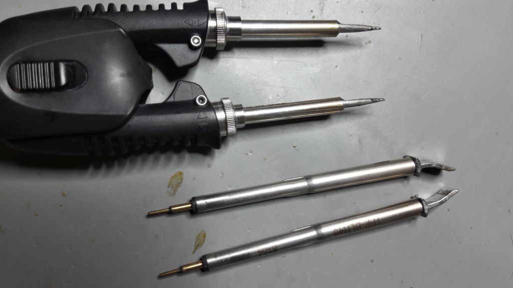

pic 1 my desoldering smd tool.
the big (buttom) is for soic. i had the problem that this tool pic up the 22pf caps near the opamp and its was to late if i realise this. so this smal 22pf caps are sticking at the soldering tool full with tin-solder. so i have to use my 22pf from the box.

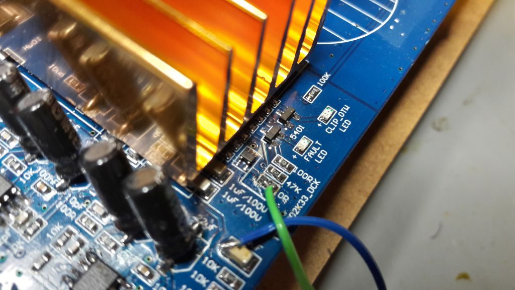

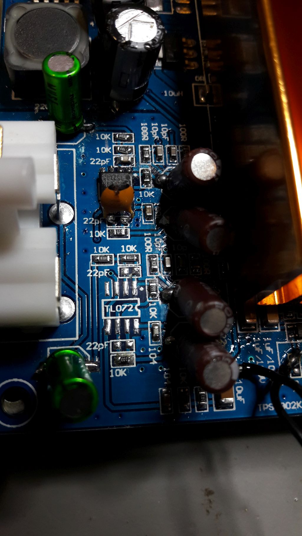

pic 2 wrong label
here you can see the label = "TL02" is other way round. the marking is correct..this was my first bad if you look at late night just on the label.

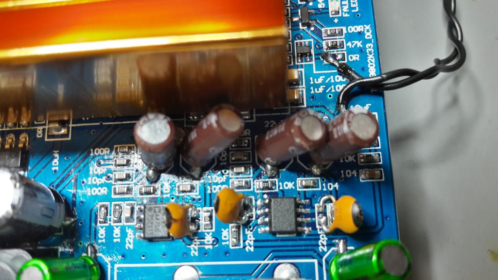

pic3 final change of the opamps-- left loud noise right
Question
could that be that the sensitivity of the AD8599 is higher for feedback loop. i meant the 22pf is too less-should i use 47pF???

pic 2 wrong label
Question
Pin 1 indicator is what counts, not labeling. That's why i don't use labeling at all.
The AD8599 is stated to be unity gain stable, but give it a try and solder 1n in place of 22p to see it changes. Well, if they're unstable in this configuration it should be sufficient to just touch the caps leads. Do you know what ceramics yours are made from? I'd only trust NP0/C0G there. Those "oldisch" leaded cercaps might be Y5V is old stock, which is a NONO here.
