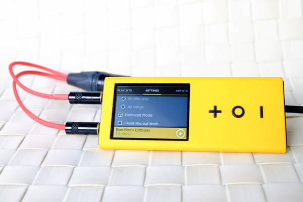

Could anyone imagine a Pono shaped cell phone on the market, I bet that would sell real well!

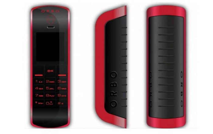

Is this near enough ?.....“OPhone Free Energy Self-Charging Cell Phone"
I don't know what they were thinking with that design, it seems like going backwards before there even was an Ipod.
I reckon the design is good, really good.
I like the way that the Pono can be plonked down anywhere and the display is always perfectly viewable....and it can be placed/oriented for left or right handed operation, cool/mandatory.
This video review likes the shape and ergonomics but notes letdowns in multifunction menu button and low battery life.
Sound quality is rated as 8/10....I did not search for players with better SQ rating so don't know what is 'better'.

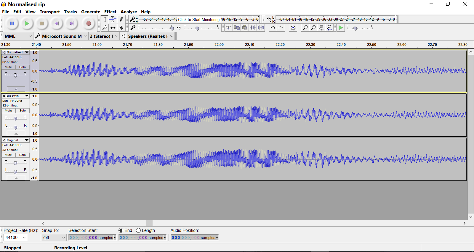

The envelopes are wildly different.This shows the left channel of:
1/ Normalised rip. This is the track ripped directly to WAV.
2/ The 4558
3/ Tone control not present. Direct recording from CD player to PC.
Dan.
Mooly,
Visually these two files show differences. Is this because of the DAC conversions not bring exactly sync'd between the two recordings when you made thrm [Scott please correct my assumption - this may contradict Nyqvist]
If you have a fractional sample offset there would be problems getting a null without tedious maths.
http://home.agh.edu.pl/~turcza/sr/Splitting the Unit Delay.pdf
Thanks - I'll freely admit the math is a bit beyond me but I'll wade through it - looks very interesting.
IIUC, you may get fractional sample offsets in recordings like this, which in turn might lead to sample by sample differences of the digital words (talking about zoomed right in of course to illustrate the point) but since fs is at least 2x the highest f being sampled, it makes no difference when reconstructed, filtered and output as a bandwidth limited signal.

The cell phone I have no problem with the look, the Pono I do. What you have to think about is the Pono is supposed to be a portable device that you carry with you. The triangular shape seems to me to be a real problem if you aren't holding it in your hands. I don't think you would put that in your pocket and hanging in a case on your side it would be so bulky. I imagine that the shape was determined based on a set of round batteries internally stacked, I don't know, If that is the case that is just poor design, you can design batteries into flat packages and have a much higher density package than a round battery and not waste the space caused by putting round batteries next to each other. If that isn't the reason for the shape then I just don't get it for packaging reasons. I must say I have never seen a Pono in the wild, never. I see no advantage over a current smart phone for storage of music files.

Mooly,
I was another that thought that you were showing a comparison of two devices, never realized that was a right and left channel. I take back my comment about the files being different after that clarification. I can't compare the last set of files you just posted, they look very similar to me.
I don't think the visual display in Audacity is good enough for the kind of comparisons we are seeking.
