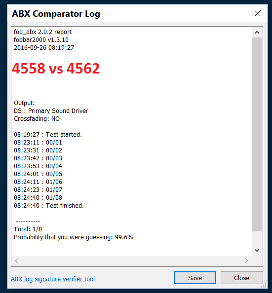

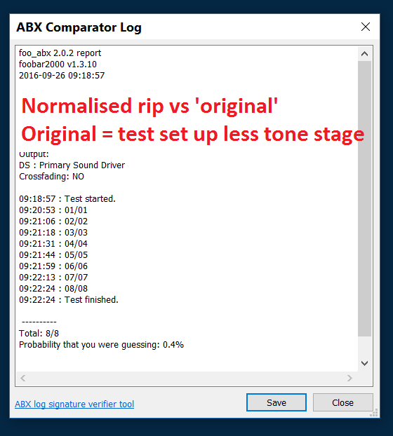

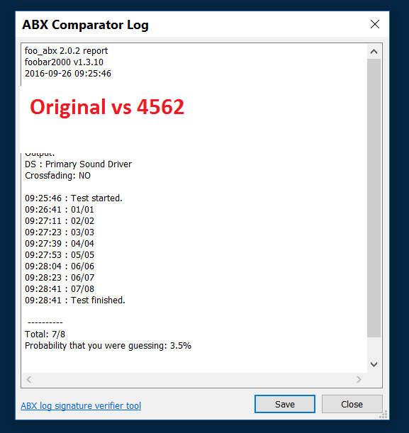

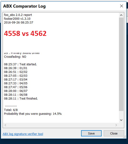

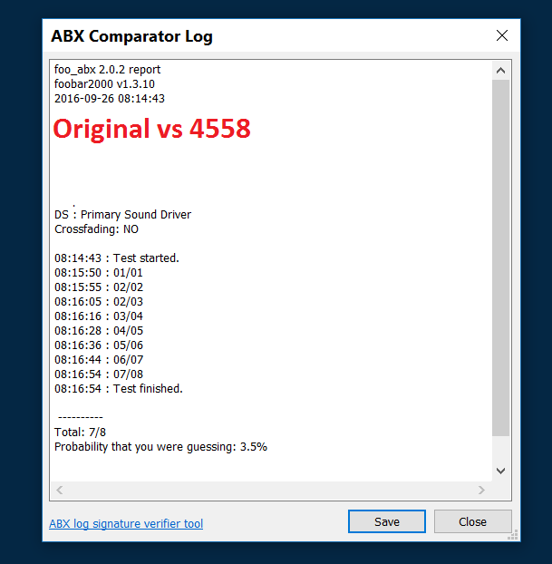

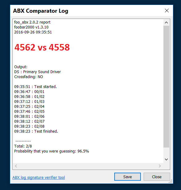

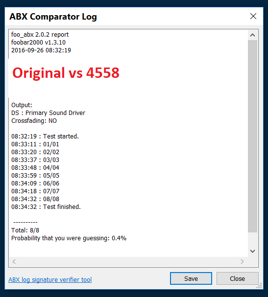

I've just been giving these a more critical listen via headphones playing at modest volume (Sony MDR-V7) and with the electronics set to a flat response.
First thing to say is a big thanks to all that do listen and compare because as I'm finding out again, its hard work and very tiring.
For my own satisfaction I've compared the 4562 and 4558 against the 'original' and also against a normalised (volume equalised) rip of the test track. Original here means the track being played on the Philips spinner and recorded directly to the PC. No tone stage in circuit.
I'm pleased to say that I can differentiate the two opamps from the two 'originals' fairly easily.
Where I can't statistically show any preference is for the 4558 vs the 4562. I'm disappointed in that but its a fact.
Does that indicate anything ? Are the opamps all more than capable of doing the job asked of them in this application or is some other limitations of the test/PC set up masking things.
I'm struggling with the fact I can't differentiate what should be the best of the best from the worst of the worst opamp wise.
What is also obvious is that for a casual listener, five files is way to much. It really does have to be one vs another and not much more than that.
Non the less, your comments have been very interesting...... more on that later 😉
I can post the original file and the normalised rip if anyone is interested.

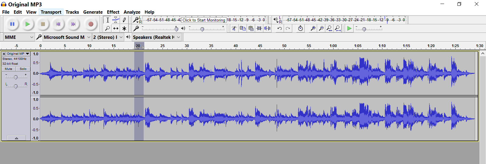

I was thinking of using one of the cymbal hits as a reference, then making a new track where the reference cymbal hit plays first, then one of the other hits. Alternate, 1,2,1,3,1,4, etc. so that each one has in immediate prior reference to compare it to. Might help for thinking of how to describe how they sound in relative terms since there seems to be multiple variables of sound (different distortion mechanisms and/or in different ratios, for each track) involved in the differences.
In one it is particularly softer, smoother, more dull, sounds like less HF altogether, but doesn't sound better. There may be 2 where I could hear a little modulation on the cymbal,.......
In the screen shots above I used just this highlighted segment to do the comparisons.
This says it all. Each file taken in isolation is perfectly acceptable to me. Here we are straining to hear minutia differences.
The differences here are very very small imo.
