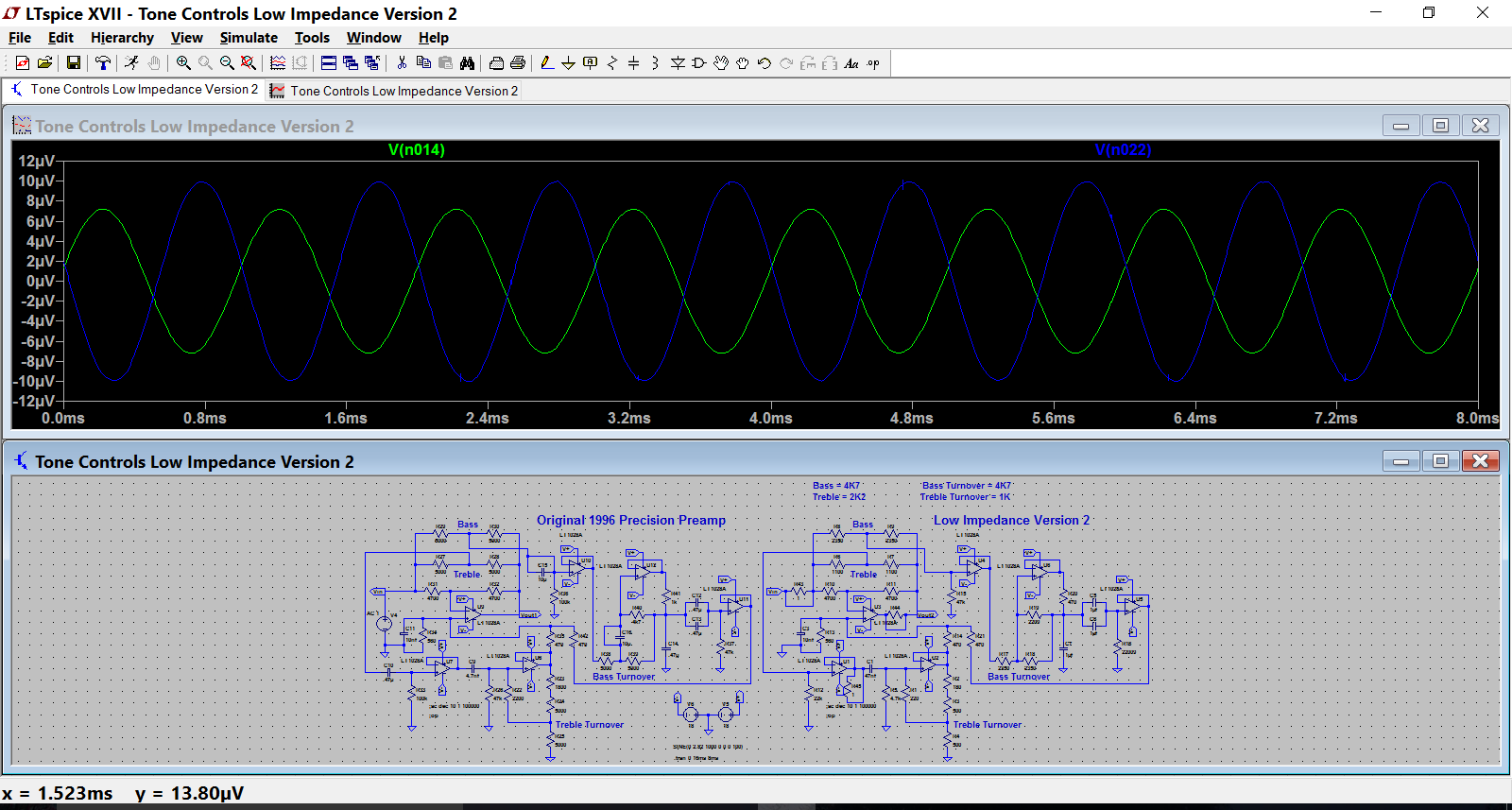

You just might be surprised how close the boost/cut version is compared to a single pass from player to ADC i.e. no tone control in circuit.
I suggest you repeat your test with tone controls flat, and one pass through only.
That would essentially be just two opamps in the signal path. With the bass and treble centred there is no contribution from all the other devices. That can be seen in the simulation below where we are looking at the final output from the bass and treble networks prior to mixing with the incoming signal.
Edit... simulation running with 2vrms applied.
Understood, but if enough additional distortion gets added to the test path, it might have some masking effect on more subtle differences. That being said, I did look at the files in Reaper, line them up to the exact sample, and I can see some differences in places. To what extent they might audible, I don't know.
