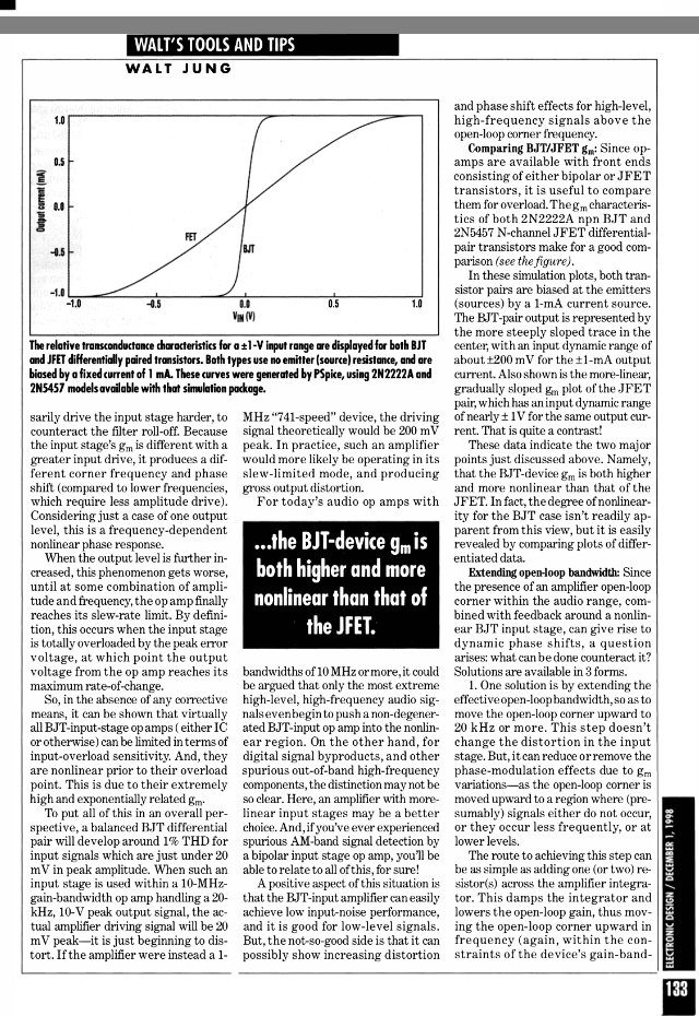

Not to continue this death by a thousand cuts but Walt Jung’s findings are interesting for modern designs.
I did a search in this thread for ‘Jung’ and a few mentions turned up so I’m adding pics of his article.
My current diy project is a feed forward compressor. Its working great with the Butler AD275 front end but I’m exploring a discrete version now.
here is Jung’s article.
