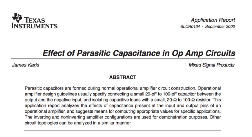

Not religious as recently designed in a side-chain using the OP275, there are intrinsic issues with op-amps if used in the signal chain.
Op-amps do excel at intended purpose ie instrumentation, precision gain amplifier, active filters ......
Again, here is the TI engineering note on op-amp internal/external parasitic capacitance effects.
How is this different from analyzing and taking care of of the parasitic capacitances in discrete parts, circuits and assemblies?
