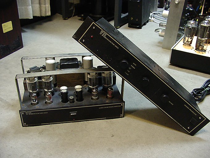

BTW - I have compare some years ago two unity gain line preamp concepts, one with OPA627 and one with Andrea Ciuffoli's power follower in modified preamp line version (only 9V but 1A idle current). Unfortunately I haven't documentation of the measurement results. But it was to observe follow: At 1 KHz and 10 KHz much more better THD results by the OPA627. And by 100 KHz and 500 KHz and soundcheck clearly better results by the power follower ( OPA627 deliver sathtooth instead sine wave by 500 KHz). 2xIRF520 was in use by the power follower. Sonic quality was better in all respects by Ciuffoli's power follower. The used power amp here was a ZEN diy project and a tube power amp from VTL (see attachement). And the speakers at this time was a 2-way combination of PHL B17-1220 and Focal T120K (very high resolution loudspeakers);
have a look also to this this URL:
http://www.diyaudio.com/forums/pass...itional-op-amp-ultimate-sounding-phl1230.html
The also still present preamp VTL "Maximal" was in the perception between both, clearly better than the preamp with OPA627, clearly inferior to the power follower concept.
