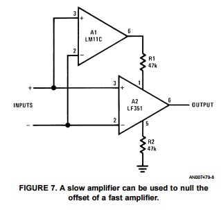

He had some boners too, he hated FET's so much he did the LM11. Do you think many folks actually used some of the applications here (I said many not any)? http://www.ti.com.cn/cn/lit/an/snoa818/snoa818.pdf
Though I do like the no cap offset servo taking advantage of its inherent slowness.

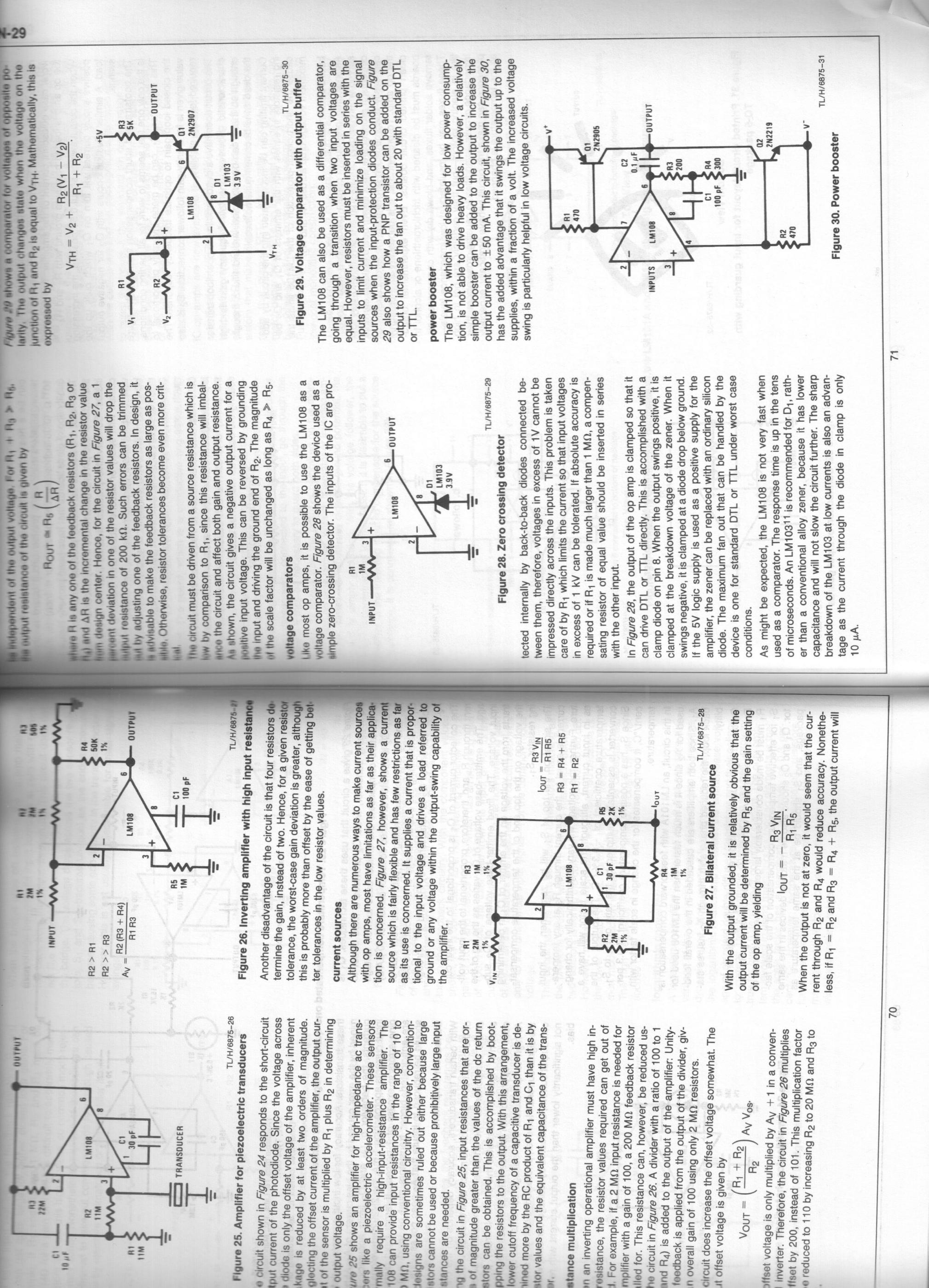

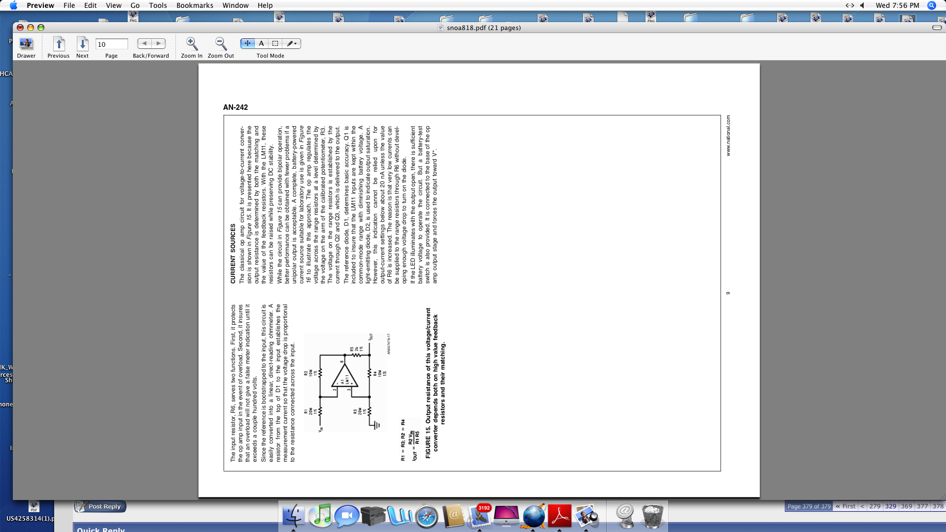

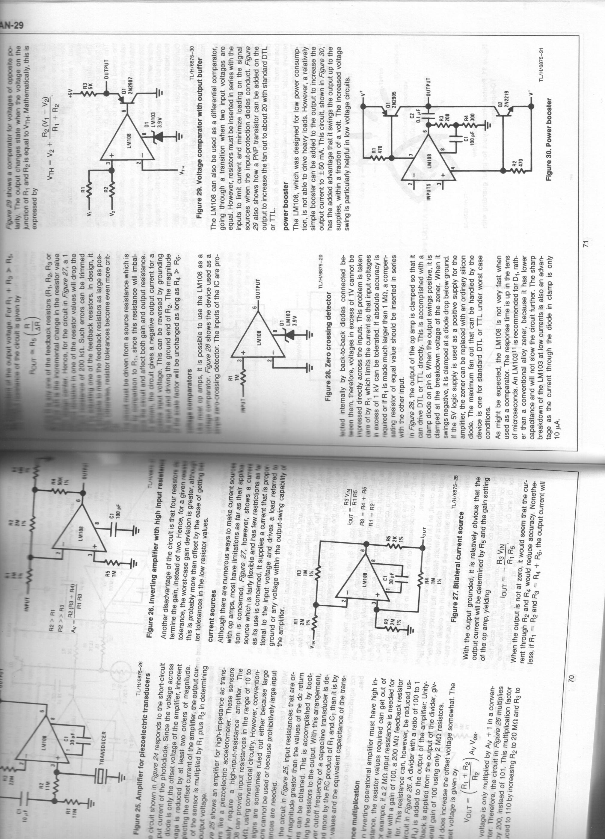

Well Scott, on page 9 of the App note that put up, I USED that brilliant floating current source design to make a 2000W servo amp for Ampex Research in 1969. When I offered this design to RG Meyer at UC Berkeley as an alternative current source, he looked at it with some question. Still, it works, and I later used it for the record drivers for both the Mobility Fidelity and Wilson Audio 30 ips recorders, after first designing it into an HK prototype cassette tape recorder in 1978. App notes can be VERY USEFUL if you keep an open mind about NIH, that is inherent in all of us.
Here are the 2 major apps that I took from Widlar, back in the late 60's. In fact, I saw them in an earlier app note, or an engineering mag article, before early 1969, because I used the current source app. in mid 1969, then I used the power amp app in 1970 as an automotive power amp, and even a temporary power amp for one of my K-horns.

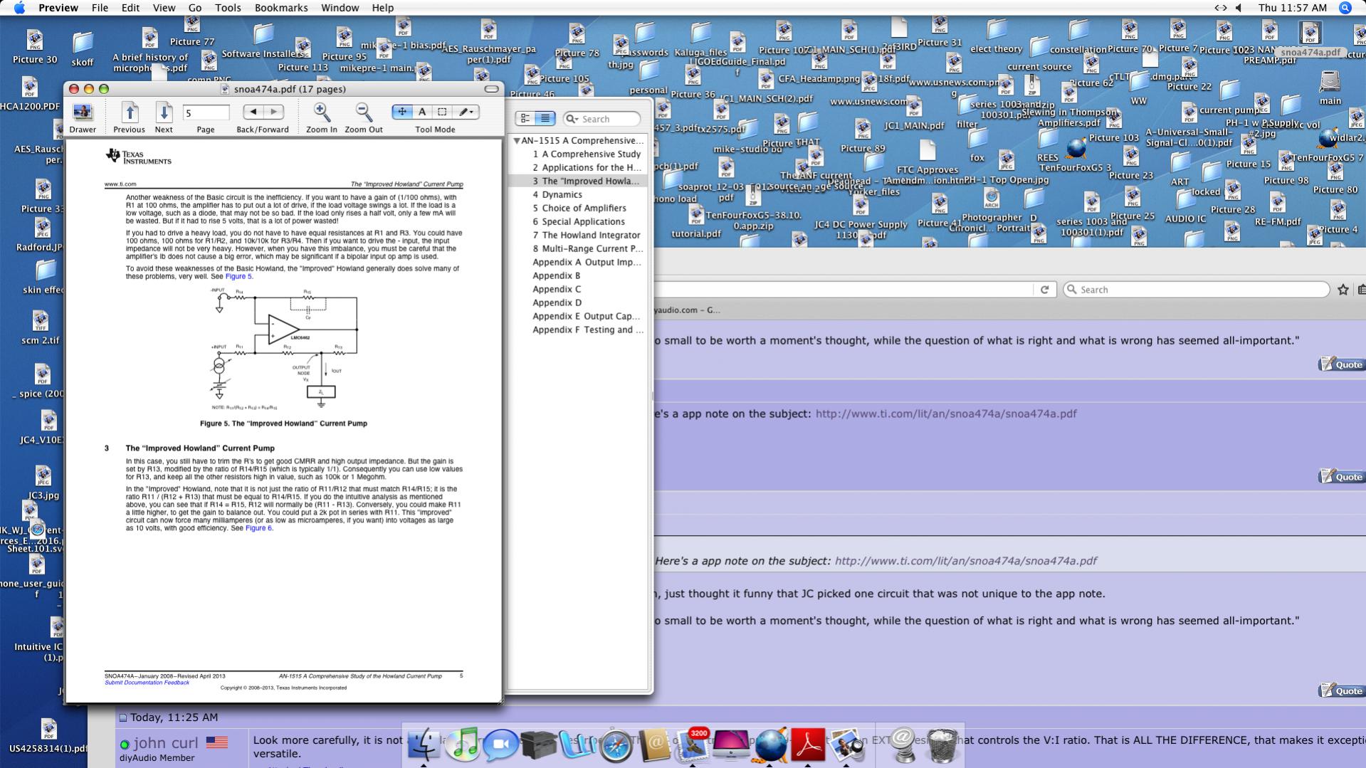

Funny you should say that, the Howland current source was definitely not invented there.
The "Basic Howland Current Pump" was invented by Prof. Bradford Howland of MIT, about 1962, and the
invention was disclosed to his colleague George A. Philbrick (the analog computer pioneer who was head
of Philbrick Researches, Boston MA at that time). This circuit was not patented. The Howland Current
Pump was first published in the January 1964 "Lightning Empiricist", Volume 12, Number 1.

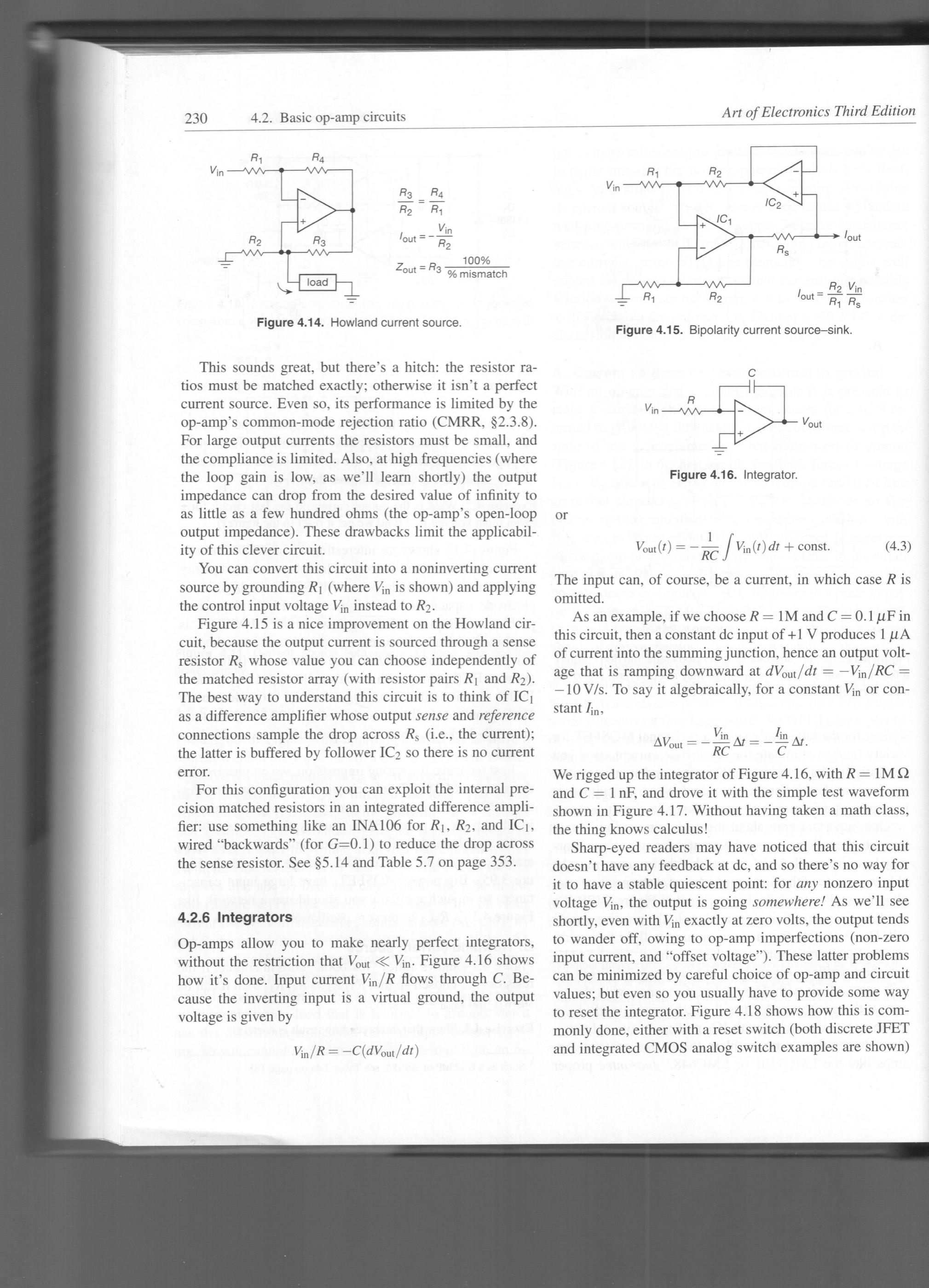

Look more carefully, it is not a Howland current source as described in 'The Art of Electronics' pp. 229-230. It has an EXTRA resistor that controls the V:I ratio. That is ALL THE DIFFERENCE, that makes it exceptionally versatile.

The improved was dropped from improved Howland current source for as long as I can remember. The point was that app note was not the first appearance.
I am talking about almost 50 years ago! Not the last 20 years. Scott, I think you were not designing circuits when this first came out and I grabbed it. I don't care if Bob Widlar designed it, some colleague at Fairchild did, or some professor: I saw that it was an elegant solution to a making a floating current source, for motor drives, or even analog record amps. It was not in general textbooks at the time (late 60's) so far as I know. The standard Howland Current pump was in the textbooks at the time (I'm pretty sure).
