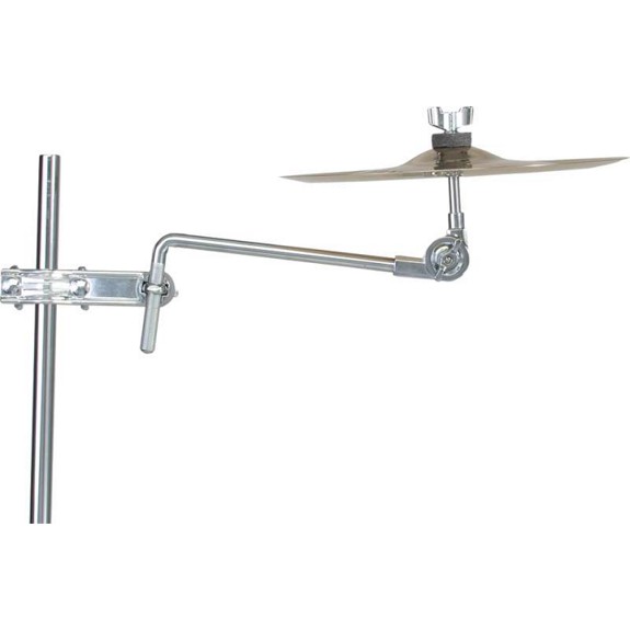

Top felt pad/wingnot was removed and a mixture containing small diameter and thin rubber disc/ring placed on top surface of cymbal center concentric with mounting post/thread, and top felt pad and wingnut not refitted.
Experiment was with a professional drummer who used one or two sticks and played all over the surface of the cymbal and at varying intensities.
He could not get the cymbal to go into chaotic/harsh/ear bleed mode despite his best efforts.
All present agreed that the sound produced was cleaner, clearer and more pleasing than the usual sound produced, and numerous A/B comparisons were trialed.
The position, weight/mass/damping and contact area of the rubber pad are seemingly not sufficient to produce the effects observed.

😕 So you made a mechanical change?

Yes, but minor.
The centre and quite inactive part of the cymbal rests on a felt pad.
Resting my disc on the top surface of the cymbal should not effect any significant mechanical change, however the result was distinctly audible.
Dan.
Fairly dramatic change of boundary conditions to the vibrating disk problem. See cymatics for instance.

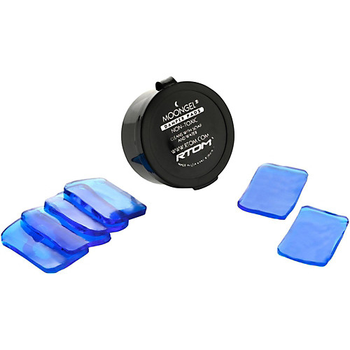

Experimentation with small patches of duct tape on the underside of cymbals is not uncommon. It's a trial and error process, but often can result in a preferred sound. Then you can mic it and use an op-amp preamp, of course.
This stuff is also commonly used to tune/dampen drums and cymbals, but is not the effect I am talking about.

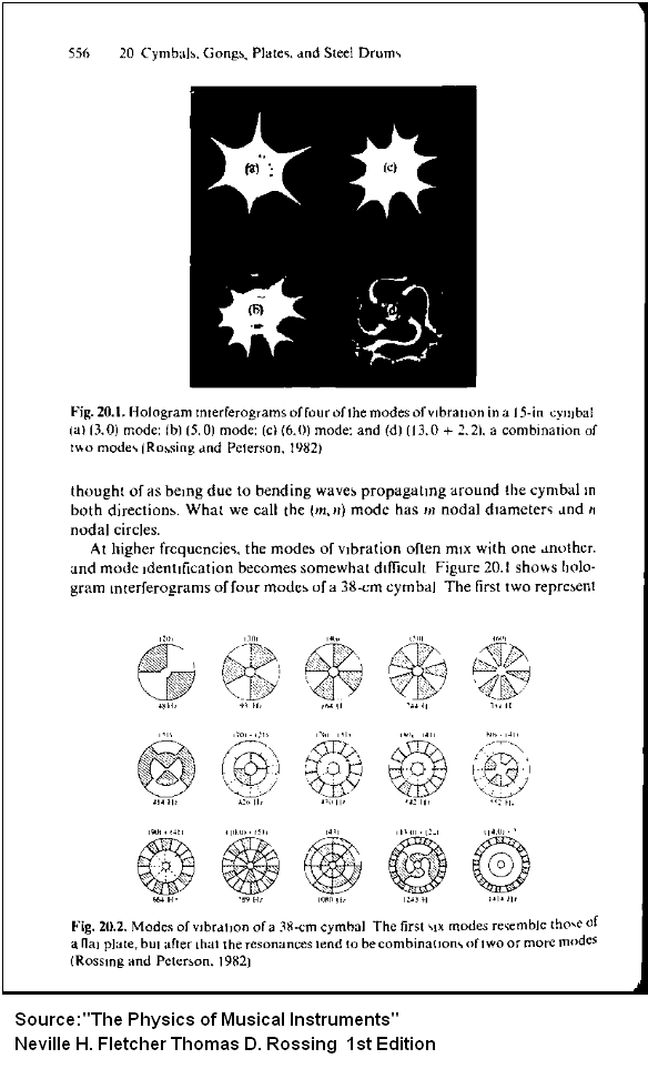

Yes, but minor.
Dan
As you can see, no part of the cymbal is “quite inactive” with all these modes of vibration taking place.
As a supplemental info, from industrial inspections with ultrasonic waves, a small oil drop on an inch wide surface of a 1/16 inch thick metal piece can attenuate (damp) the propagated shear waves by about 20dB and the surface waves by about 40dB.
George

That is a completely different statement from what you said at first.
When there is just sufficient nonlinearity to allow for chaotic behaviour you might only need to reduce the nonlinearity by a very small amount to kill or modify the chaotic behaviour - that is one of the reasons it is called chaotic! So "I changed the system just a little, and the chaotic behaviour changed a lot" - who would have thought it?
The AD797 is a very good product, especially for instrumentation. Whatever normal instrumentation measures is OK with the 797 in the thru-path. However, Richard Heyser warned me that test instruments could have potential problems in measuring ALL deviation, whatever the problem is, because of the internal devices used. So, an IC might have trouble measuring itself, you might say.
Thanks both you and George, point taken, though I still reckon the effect is not solely due to mechanical damping of the cymbal at the center, which is already placed on a damping felt pad.
I may be proven wrong into the future, that remains to be seen.
