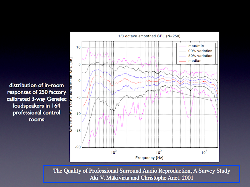

yes, even the base realities of RIAA Mastering Practice accuracy introduced phase and frequency uncertainty magnitudes blow away the properly enumerated objections re op amp, feedback implementations
RIAA curve accuracy is a easily pursued numbers game but in fact the cutting room engineer re-equalizes the master tape source on his own monitor system (different from the mastering monitor setup) to his own taste (hopefully with the goal of reproducing the master eq on the produced vinyl) there is no reason to expect even skilled recording engineers to approach 0.1 dB accuracy (~= 1%) in such a scenario
how about those different mastering studio response?
