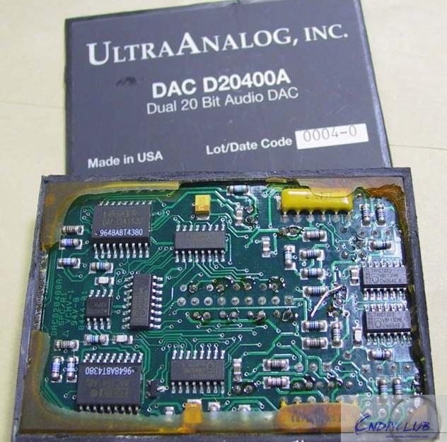

Ultra Analog used to be a maker of DACs in the late 80's/early 90's. It was a USA company. So now I see a UK operation selling a surface mount chip mounted on an 8 pin dip socket adapter board. Nice, I guess, to commandeer a respected name and sell part soldering services at a hefty markup.

Those tubular resistors are/were common in tuner modules, ditto tubular capacitors.....what's special about them ?.Ultra Analog used to be a maker of DACs in the late 80's/early 90's. It was a USA company. So now I see a UK operation selling a surface mount chip mounted on an 8 pin dip socket adapter board. Nice, I guess, to commandeer a respected name and sell part soldering services at a hefty markup.

MELFs? higher power handling and sometimes better matching. Other than that a PITA as they roll off the board before they hit the IR oven if you get your pasting wrong.

Nothing. The point is the UK company using "Ultra Analog" It's like if I started using HH Scott.Those tubular resistors are/were common in tuner modules, ditto tubular capacitors.....what's special about them ?.
