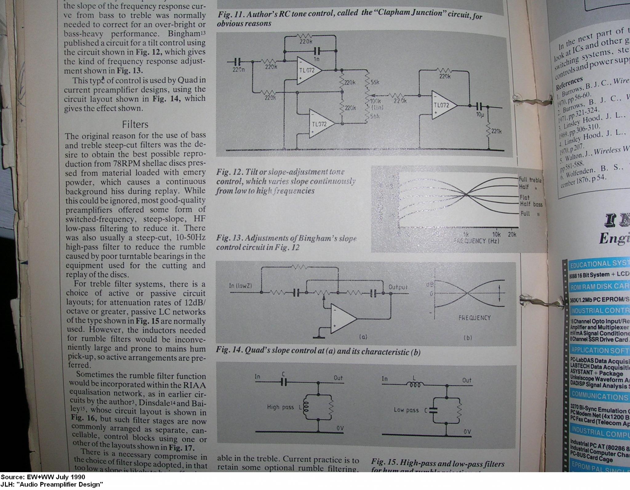

In most cases, a freq tilt circuit is what is needed. (1st attachment)
Due to it’s frequency balancing-unbalancing in a complementary way, it dissapoints the jerk guest and makes him to self correct his action.😀

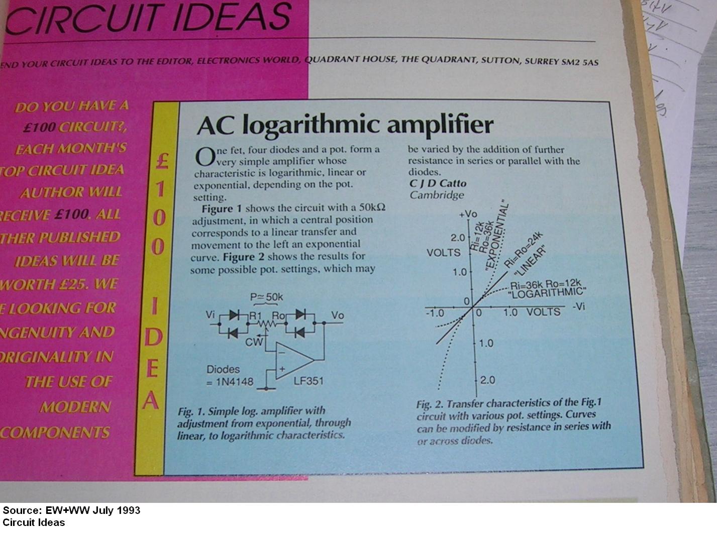

I have shown some folks how to get a tube sound by using inverse parallel diodes in an opamp feedback loop and mixing some of the resulting distortion back into the main signal chain.
Ed, looking for the tilt circuit, I found this (2nd attachment).
Is the log function what emulates the tube sound?
