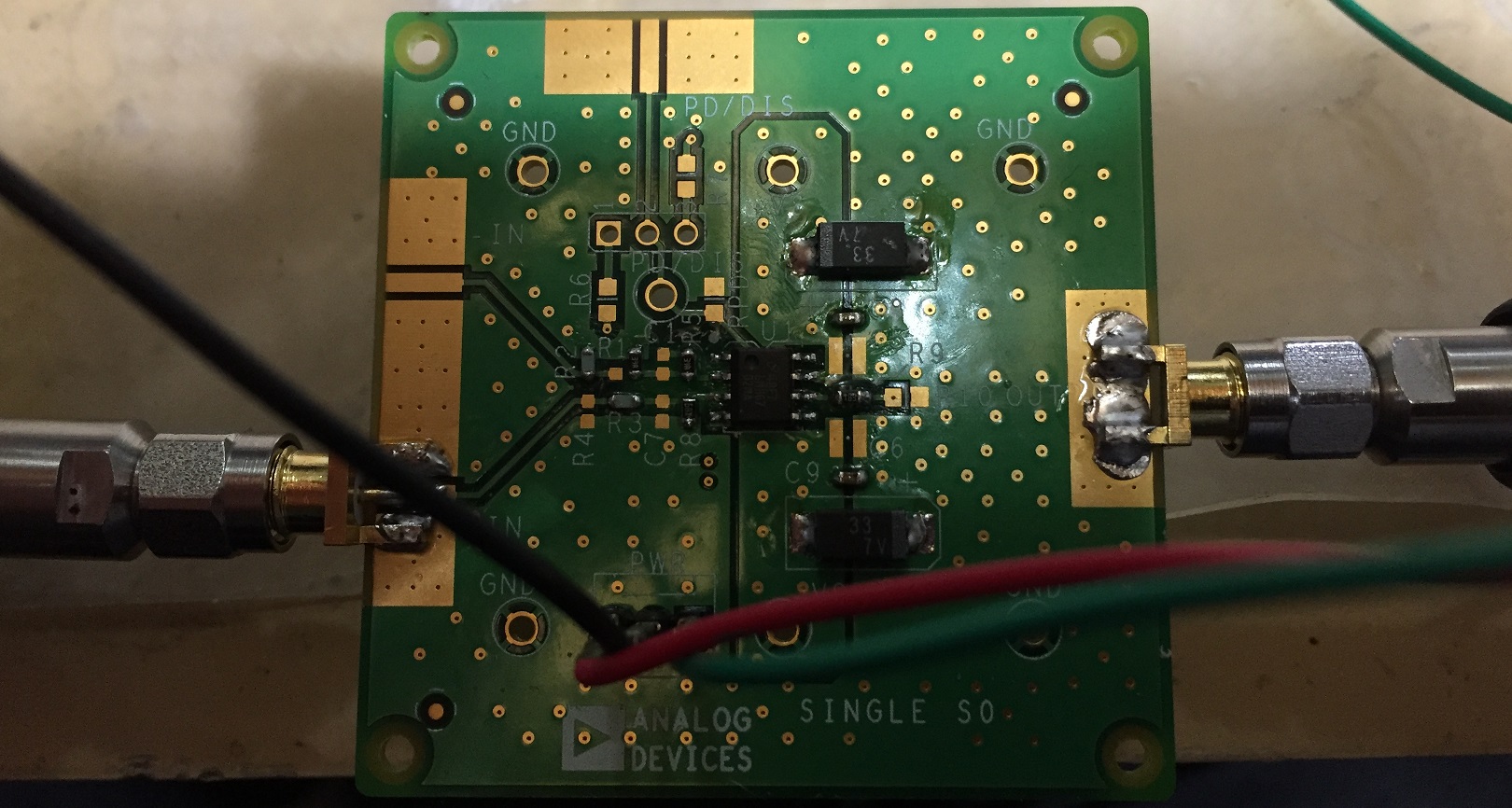

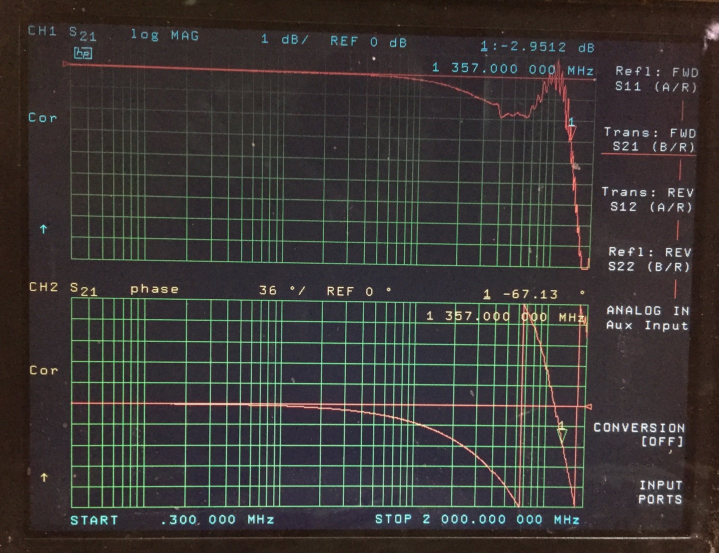

Because we are at it, I just finished an op amp evaluation.
This LMH6702 has at Av=+2 a bandwidth of 1.4GHz (rise time is 250pS) and a slew rate of about 3000V/uS. Fast enough for audio? 😕 Will it sound good? 😕

A little bit anaemic, good treble but the bass does not live up to my expectations.
We use them for clock distributions because of their good phase noise floor.
By the pound. I prefer the sot-23. For distortion, the cap directly from VCC to
Vee is important. More than those to gnd.

Been there, done that. More caps are on the board back side, including Vcc to Vee. Not my call for SOT23 vs. SO8. Those 6 layers eval boards are expensive, almost x10 the cost of the chip.
I agree, it sounds a little thin in mid bass, also I've noted some sibilance on high pitched female voices. Good for punk rock, Nina Hagen sounds great, fails short for opera.
I guess I have to check the OPA695, perhaps it will improve the sound 😉.
