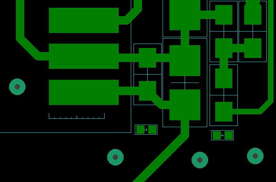

008004 chip device shown next to more normal SMD components, 0402 and 0603 packages (scale is 1mm long the size of an 0402 chip device). Our sample kit lasted all of a few seconds, everyone wanted to try an hold one... trouble is they look like a bit of dust and are soon lost... and breathing on them causes havoc, possibly the only devices you have to worry about inhaling.
The great thing about CAD is you can zoom in...
