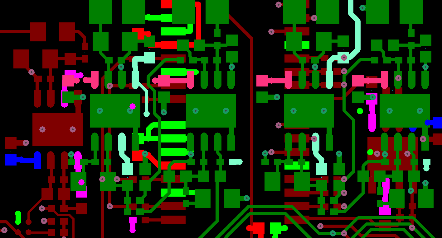

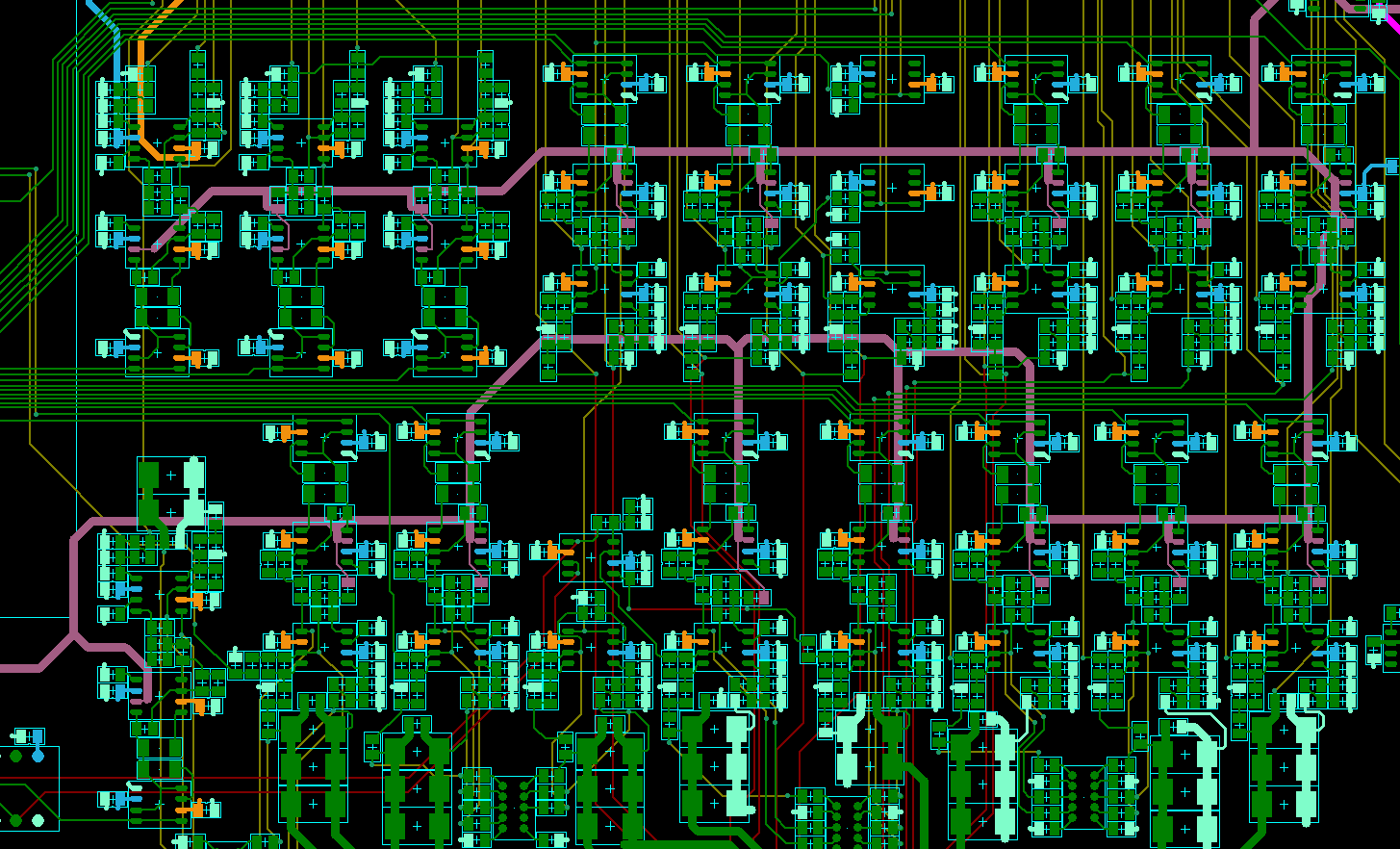

The 1.27mm pitch soic packages are good, go nicely with 0603 and 0805 discrete's... the really small packages are a bit more taxing but allows more to be packed into whatever space you have, the pic below shows 0.5mm pitch op-amps and associated discrete's... course you really have to use laser drilled vias (o.1mm hole).
Ah... Marce,
Those plots are beginning to look like Hollywood's idea of an LSD trip! Anyways how do you solder those tiny chips with a Weller soldering gun? They are getting to be smaller than the tip.
