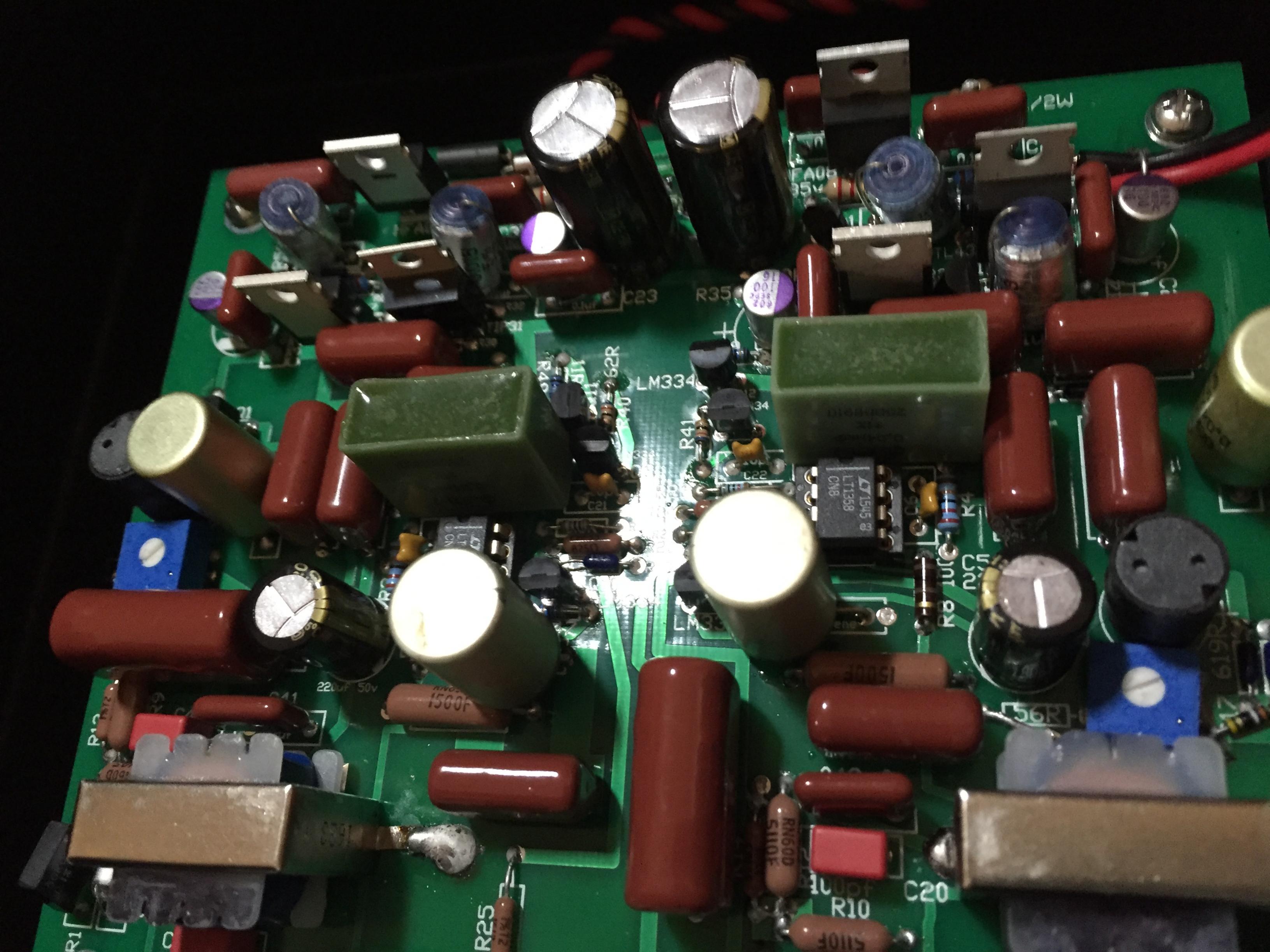

I very much doubt its due to the slew rate directly, that's just a marker in this case that the part you love hasn't the usual LTP input stage and hence exhibits less sensitivity to out-of-band grunge at its inputs. I'd double check your decoupling - have you observed hygiene in keeping power and signal grounds separated?
Oh Yes, separate power ground return. 2 oz copper traces. Russian 0.033 - 0.056uf k71 styrenes (what ever I can get at an earthly price) as close to the power pins as possible. Next to those 1uf pp. Also 220uf panasonic FM//1uf PP from pos rail to neg rail to help with supply common mode. I could go on.
DIP adapters... and what are those ceramic caps for? If the polystyrenes are your decoupling caps...
