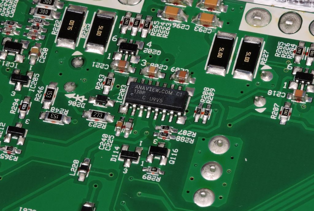

Whom is that? Evidently the part number in the schematic was never a part. I like mysteries but this one I'm going tiresome of. I really want to fix this amp so I can I say I did but wow.
I've no DC offset now but no audio. I messed with it an hour or so tonight. No Idea. Totally lost
Sometimes a batch of custom parts are made and the manufacturer (IR) has to give it a part number. If it goes into production, they will invest in producing full documentation. If it's only used by the company that ordered the special IC, there may not be any IR docs.
anaview.com. It's printed on the IC. This is from a smaller version.

Ok I understand. We will see what happens with UTSOURCE ICs when they arrive. I hope I learn something
Just some additional information: the IRS20956S seems to be a custom version.
It is quite similar to the IRS20957S, but there is one MAJOR difference between them: the 957S expects an external PWM generator connected to pin 3, while the 956S seems to have an internal PWM generator (accepting an analog audio signal with a max. amplitude of 1V). That makes the 957S unsuitable as replacement!

That's what it said and that's what I bought. I asked and they told me it's the only size they have. Ordered it. It was the right size. Worked in the amplifier about a few hours. Bad again. I don't know it was that IC or it not being correct. Anyway got tired of messing with it. Bad design amp with a custom IC. Amp is junk in my opinion. Doubt I'll work on it again. Probably just throw the ones I have apart in the trash and sell or give away the others.

I can confirm that the IRS20956s from UTSOURCE is a suitable replacement. I have fixed 9 of these with bad 3601 driver ic's with direct replacements from UTSOURCE. Usually around $2.50 a piece.

I am also trying to fix one of these PDX-M6 amps and am really curious if it was ever confirmed if the IRS20965S (Digikey - part number is: IRS20965STRPBFCT-ND) was confirmed to work as a driver in these amps.
That is not the correct part and will not work.
The correct part is IRS20956. They are available from utsource.
IRS20956S International Rectifier,SOP-16,08+PB | IC Chips | UTSOURCE
I have repaired many Alpine amps with parts from utsource and have had no problems.
