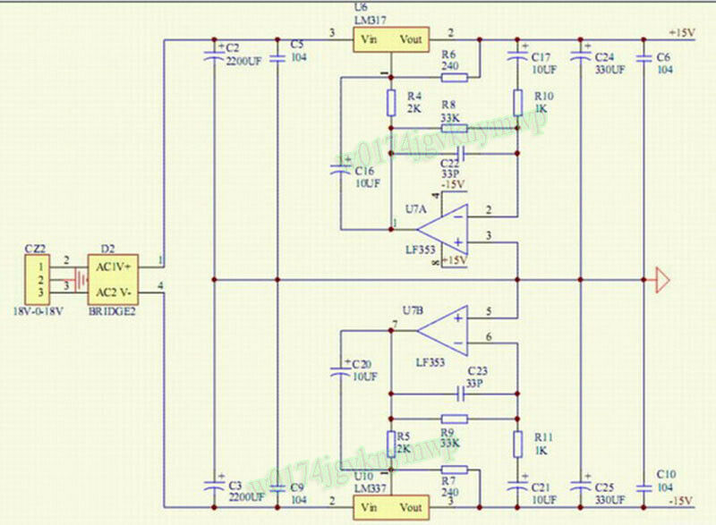

What is this opamp doing in this power supply schematic?

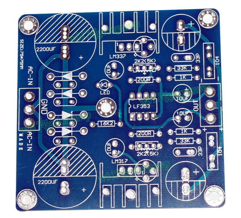

I have this pcb that I got off ebay for a few bucks.
I'm building a preamp and I need a -15/+15v supply for it.
The schematic they included in the listing has slightly different resistor values compared to the ones on the pcb because it is for a fixed output. This is actually how I plan on implementing it. The board also allows for an adjustable output using trimpots.
Only thing that has me scratching my head is the LF353 opamp. What is the function of this? Does it keep the outputs equally symmetric?
Can I safely leave this out of the design? Or is it recommended I leave it in?

Yes, it is an opamp denoiser; it is also wired for a correction factor of ~30dB.
The advantage of an opamp is more convenient coupling capacitors values, the disadvantage is that the noise will be higher: you need a very good opamp to match a very cheap transistor like the BC337, and no opamp will match a transistor like the ZTX851.
But the circuit should work OK, and improve the PSRR and the output Z

It is a dual LDO regulator with an opamp de-noiser. At $10.80 fully assembled, it is one of the best PSU board deal on e-bay.
The LF353 a good choice for its function. It is on socket and can be esaily changed if so desired.
AC-DC LM317 LM337 LF353 Servo Rectifier Filter Power Supply Module Adjustable M | eBay
But it is NOT a 1.5A output board. The heatsink should be fine for a class A line level or headphone amp biased at 200mA or so, but not much more.
LF353 was commercially replaced by similar but cheaper TL072, which your store sure should have. The '353 is still available, and costs only pennies more, but nearly all the early 1970s stuff that started on LF353 moved over to TL072, often as a drop-in, often without noting this on the docs.

TL072 and LF353 are both JFET input opamp and often considered interchangeable. The smaller bandwidth of the TL072 should not be a problem for a denoiser servo.
The NE5532 is bipolar input opamp and lower noise. What does that mean to the denoiser servo application?
The input impedance is totally irrelevant in a denoiser application, and in fact the gain resistors around the 5532 should be lower, to take advantage of the better noise performance, and reduce the effect of the noise current.
I didn't make any calculation, but you can safely go to very low values since the signal handled is normally quite low.
Properly using a 5532 will lower the noise floor compared to a TLO72, but an ordinary transistor will do even better
