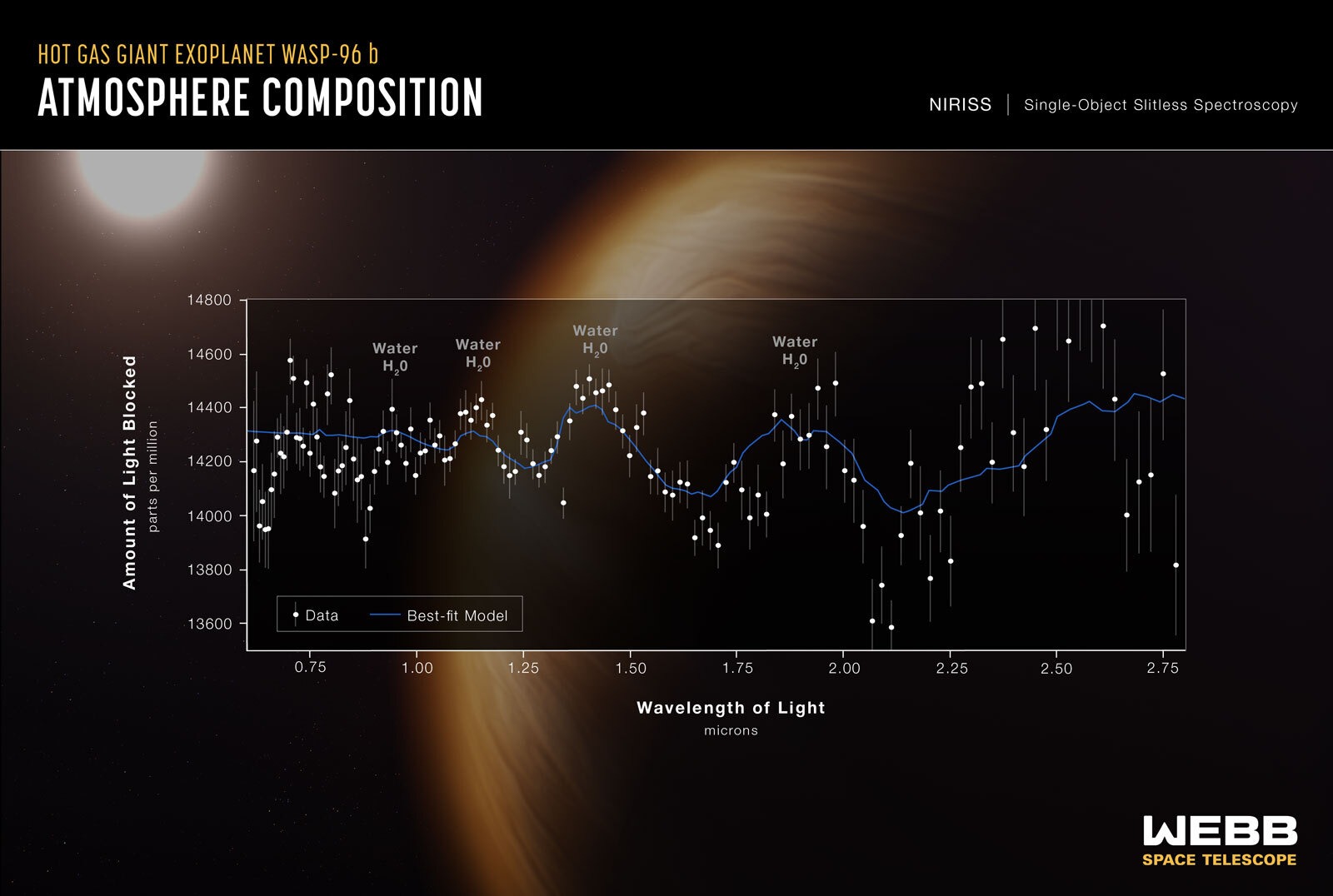

...the capability of the spectrographs.
As shown by the transmission spectrum of the atmosphere of exoplanet WASP-96 b which has revealed the presence of water.
The instrument used is the Near-Infrared Imager and Slitless Spectrograph (NIRISS).
"NIRISS is able to detect colour differences of only about one thousandth of a micron (the difference between green and yellow is about 50 microns), and differences in the brightness between those colours of a few hundred parts per million."
https://exoplanets.nasa.gov/news/1707/webb-reveals-steamy-atmosphere-of-distant-planet-in-detail/
P.S. The hot gas giant exoplanet is 1,150 light years away!

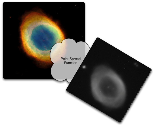

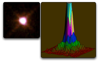

In short - it's the mathematical function that maps between the perfect star/image and what you have in front of you. It's not just one PSF but a number all combined together. The telescope, the atmosphere and the everything from the source (including an Einstein lens) each have a PSF. Then combine them to get your final PSF.
Years ago I wrote a nice forum article titled "What did the Point Spread Function (PSF) ever do for us?"
PART1

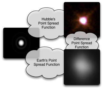

Unfortunately quite a bit. It's part of the reason my image doesn't look like hubble for a start..
Here you can see the additional PSF between bubble's image and a basic stacked image of mine. It's the reason why everything is a little bit more blurred. However even Hubble has a PSF! We can look at an ideal mathematically generated PSF and show the PSF between Hubble and my image - lets just look at the bright star in the top left of the hubble image:
Strictly speaking the ideal image is also a PSF caused by the circular aperture.. as we're all looking through circular things.. then lets just ignore that point 😀

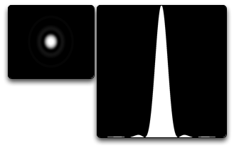

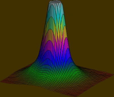

Lets look at each star with a plot of the image. If you imagine the difference between the plots in 3D - that's the point spread function.
First the ideal PSF:
You'll note that I've shown a 2D slice through to make it easier to see. The centre bright spot is in the middle, the brightness of the star then quickly drops creating a nice around appearance. But wait - what's the little rings around it? Well these are caused by looking through a circular aperture - known as defraction - and they appear as the little bumps at the bottom of the graph.

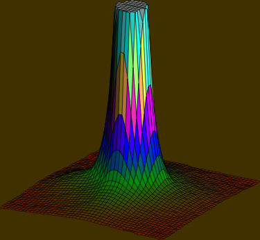

Next Hubble's:
The top is is flat showing that the centre of the star was too bright. however the sides quickly drop evenly away and it looks very close to the ideal plot above. You'll note the spikes caused by Hubble's secondary mirror supports - a natural additional "defraction spikes" that reflector owners put up with.

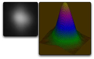

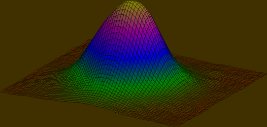

Then finally mine:
The first thing you'll note is the gentle slopes of the image that aren't circular. I'm using a refractor so the image doesn't have defraction spikes. The scope is operating at below dawes limit - this means that a point smaller than the limit means it gets blurred due to defraction .. this all adds to my PSF complexity. Guiding errors also add to the non-roundness of the stars and this is what you're seeing here. Additionally the earth's atmosphere that bubbles moves the point around causing additional blurring.
Wait? Why aren't they the same? Well the PSF is a cunning beast - it changes completely between images and even over the time you take an image. Next time you look up and see the stars twinkle then you're seeing the PSF change over time and so the star appears to change over time thus the twinkle.
The last point is that PSF doesn't just affect the stars.. it affects the whole image resulting in a blurred mess - including nebulosity, galaxies - that means you'll miss some lovely little things in the background hidden in the blur..
The technical term of all this badness is "Convolution".

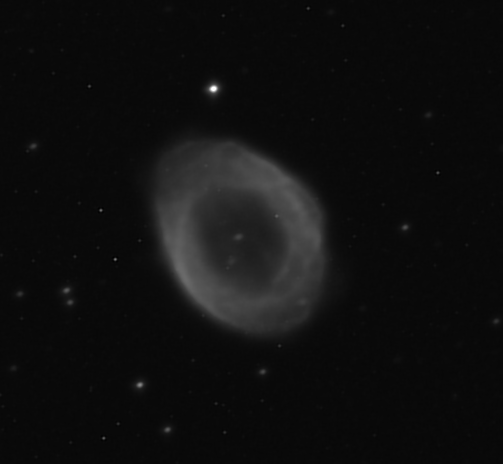

I've done alot of astronomic imaging but specifically high resolution information recovery using a 4" refractor in the back garden:
Those four dots are the sensor pixel sizes. Which means that's 28 arc seconds across.
The bear paw:
Compared to my 4" image above, this is what a space telescope sees: https://en.wikipedia.org/wiki/NGC_2537
And to show post processing - before:
After:
Enough to say - JWT is exceptional but for the most part just the visible wavelength is actually the less impressive stuff. Far more is the capability of the spectrographs. I built a DIY spectroscope for sun hydrogen alpha and got a resolution R6000 and bandwidth of 0.9Angstroms according to one of the professionals analysing my sodium test image. That's enough to be able show the movement red shift in hydrogen gas as it moves on the sun.

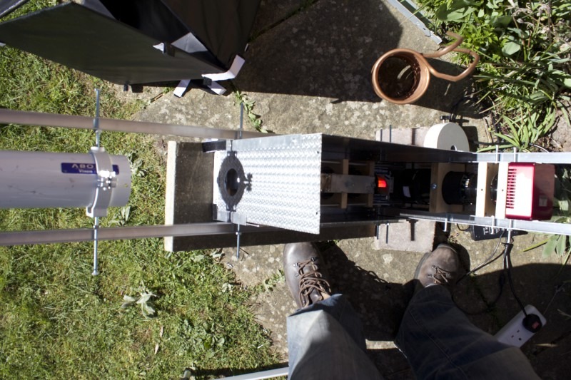

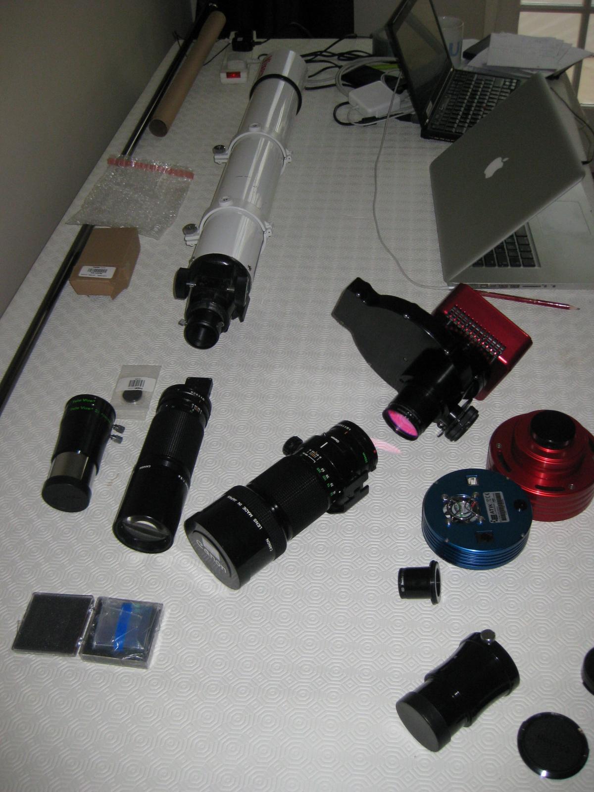

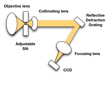

Any details on your DIY spectroscope?

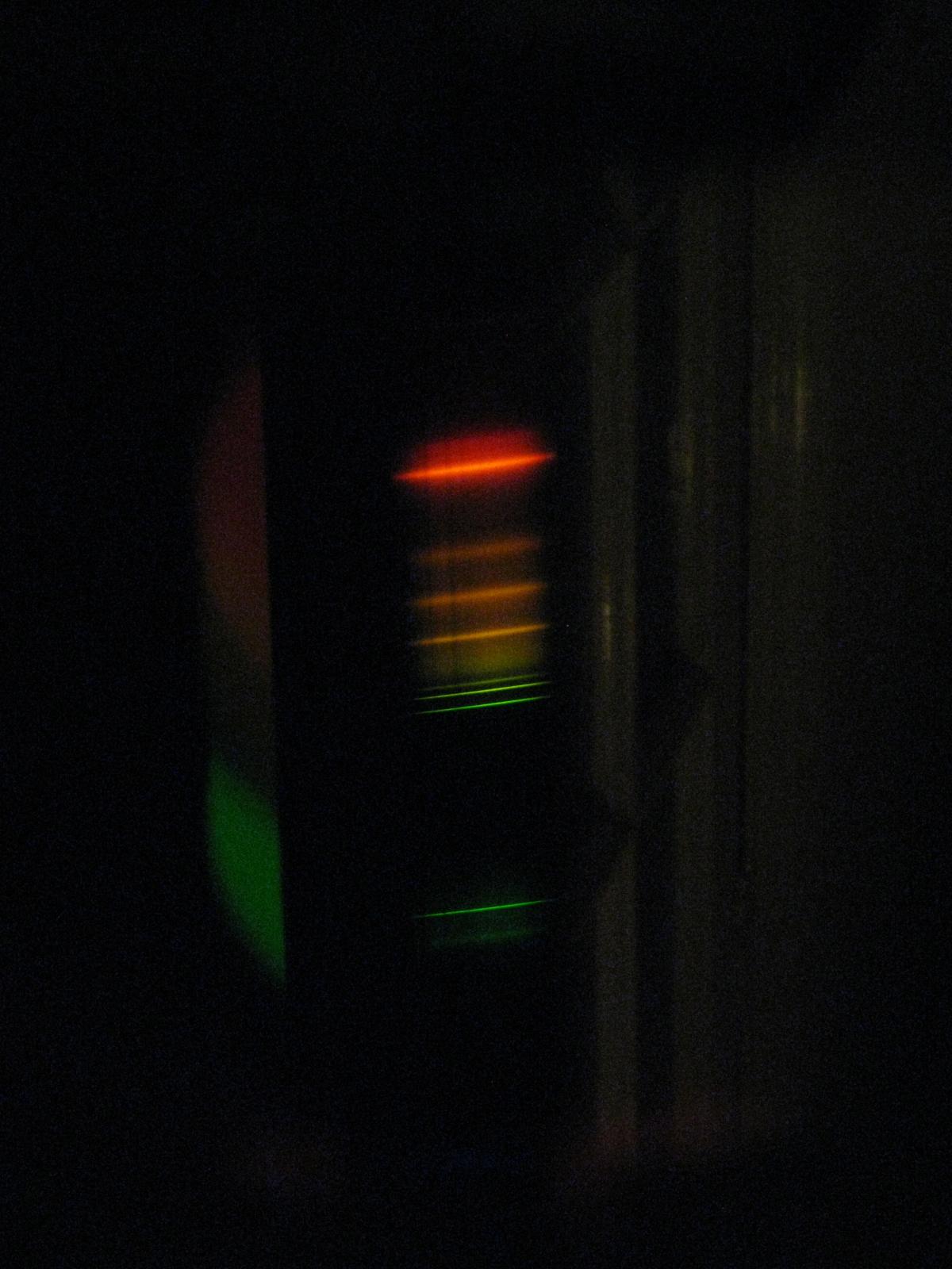

It was (now disassembled) made up of a 910mm FL scope with two telephoto lenses (cannon 300mm f4) with a Thorlabs slot and defraction grating. The idea was for sun imaging.
First the component layout:
I used a high pressure sodium bulb initially to get the alignment and first spectra:

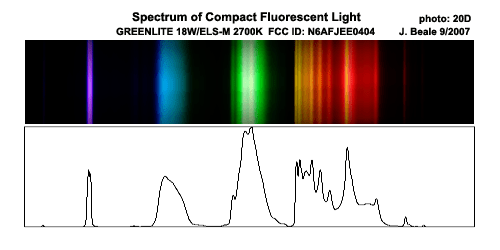

And a test shot at a CFL light to get sodium lines, cropped to show the native resolution :
So those two lines above are the two yellow lines just at the start of the yellow.
And first light at the sun:
The next step was to make a scanning spectrograph using a CD mechanism but unfortunately life got in the way and so I couldn't spend the time staying up all night or all day.
