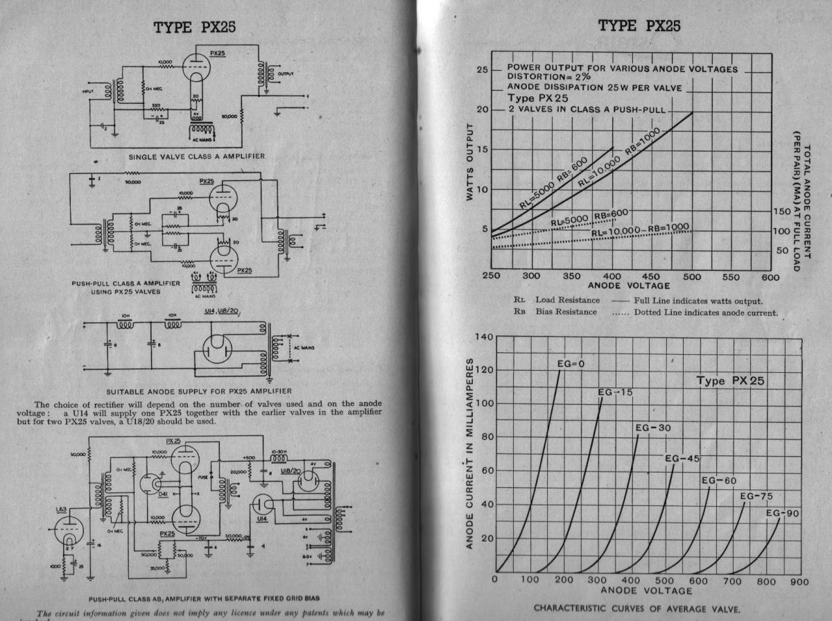

Here is my answer to your question "who encouraged the use of DHTs in amplifiers after 1940".
The attached is page 106-107 of the Marconi-Osram Valve Manual, 1951 edition.
The wording (eg "choice of rectifier" [in your amplifier design]) clearly shows that the PX25 is being promoted for design-in in the 1950s, regardless of the production stability of the KT66. The Marconi-Osram Valve company were quite aware that the KT66 (6L6) was not good enough for all designers, however much feedback is applied.
And no wonder. On the facing page you can see the superb characterisation of the PX25 - if anything, even better than the 300B, and linear all the way up to at least 700V.
Notice, too, how the Design Suggestions on this page show fully Open-Loop circuits (zero global negative feedback if you prefer). No feedback is required, because of the high performance of the device.
Another outstanding Directly Heated Triode, still bearing a fully justified fame.

A relic of an earlier edition of the same manual?The attached is page 106-107 of the Marconi-Osram Valve Manual, 1951 edition.
Actually you're probably right. Even in the 1950s the triodes v. 'modern' tetrode/pentodes debate raged. Even then, 60 years ago, the triodophiles were regarded as the subjectivists, and the pento-philes as the 'rational' objectivists. If MOV thought they could continue to flog triodes to customers in the 1950s then I guess they would indeed promote them in their manual.
