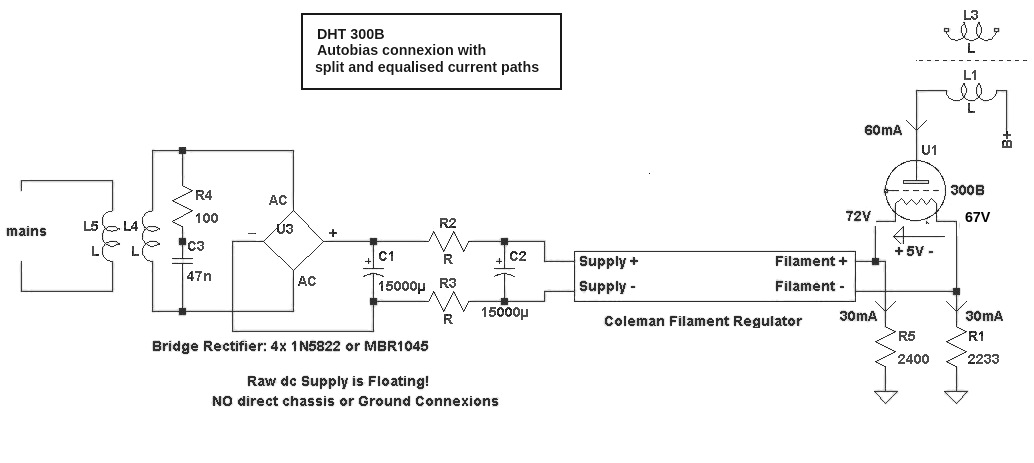

Hi Chris,
The emphasis in my documents on the floating supply has to do with floating the raw dc and transformers, to allow any dc voltage to be set on the 300B "cathode". So the input side floats, but the output can be connected to ground, or it can ride on a cathode autobias resistor at any voltage desired.
If you like to use 2 resistors, please try, and compare it with the circuit in my suggested connexion method. It does seem to have quite a big influence on the sound.
Another method is to autobias a DHT using 2 separate resistors. The picture shows the arrangement: the 2 ends of the filament are connected to ground using 2 separate resistors, whose values are set to allow half the cathode current to flow in each, while maintaining a voltage difference of Vf between the two resistors.
I don't insist that this sounds better than the usual connexion, but you may prefer the equalised current draw, if you're using autobias.
