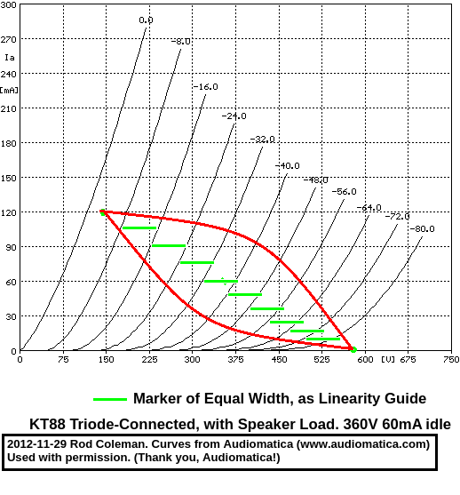

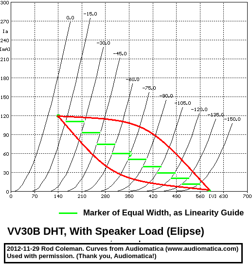

The Directly Heated Triode has serious, and measurable advantages over triode-connected pentodes and beam-tubes.
I confine this assertion to power output stages, driving a loudspeaker, since here, the advantages are clear and obvious.
To avoid any charge of bias, I will call on independent measurements, taken with the same equipment, at roughly the same time. The examples I give here are used with the kind permission of their owner (and driver of the measuring equipment) - Audiomatica SRL:
Audiomatica Srl
I have compared their curves for the KT88 beam tube against the directly-heated VV30B (a 300B variant).
In both cases, a load approximating a loudspeaker corresponding to a nominal 3500 ohm anode load is shown, and the idle point for both is 360V 60mA [Pa = 21,6W].
The load line is an elliptical envelope to represent the reactive nature of the speaker. As levels and frequencies vary, the instantaneous operating point can be anywhere within the ellipse, or even further out!
The use of elliptical load lines to model speaker loads is widely discussed, please look it up, or find a library with good books in:

The pictures tell the tale. The green markers are just lines of equal width to help judge the spacing.
As Thomas mentioned above, the triode-connected beam tube shows much more variation in mu than the DHT.
More seriously still, the KT88 curves become seriously compressed high voltage.
Altogether, the linearity across the required working range is worse for the KT88. The comparison may be made between others, with similar results.
But the fame of the 300B for linearity in SE speaker driving stages is perfectly justified.
Provided the power supplies are top notch (HT AND Filament), the difference is easy to hear, in SE amps for sure.

...The pictures tell the tale. The green markers are just lines of equal width to help judge the spacing.
But the fame of the 300B for linearity in SE speaker driving stages is perfectly justified...
Interesting stuff!
The picture shows the KT88 at operating points of plate volts = 360V and plate current = 60mA. That's only 21.6W plate dissipation. KT88 is capable of >30W plate dissipation. Perhaps there is a more linear operating point possible for the KT88-triode?
Interesting stuff!
Also, the 300B needs about twice the drive voltage of the KT88, so really we have only shifted the linearity problem from the power valve to the preamp.

You can tinker with it but the problems do not go away.
The variation in mu with operating point, and the compression of curves with decreasing current/ high voltage remain, and make a wholly unnecessary compromise in performance - if you are driving a speaker.
The EL 34 is as bad, if not worse.
But don't take my word for it - head over to Audiomatica and try your own operating points on the curves.
I compared the KT88 and 300B becuase they are both 35-40W (depending on manufacturer) anode rated. We should be careful to compare things on on equal footing.
Only if you insist on using tired out 1950s driver circuits.
Achieving high linearity across a swing of +/- 80V is something of a challenge, but if we move the design standards onward, and use modern transistor-supported triode drivers - we can drive this swing wholly within the high-linearity range of the triode.
Hi!
With all plate curve measurements I did, DHTs have been more linear than IDHTs. Especially in comparison to triode strapped pentodes. There had been some experiments done by S. Bench, comparing IDHTs to DHTs and DHTs with oxide and thoriated tungsten filaments. He measureed the change of mu with signal ampltitude. In this test the DHTs had mroe constant mu and among DHTs those with thoriated tungsten filaments had been better
Best regards
Thomas
Thank you very much. Now I know that 300B is more linear than indirect triodes like KT88 (wired as triode).

Well, looking at the curves, I do see your point.
In the end, I suppose it comes down to budgetary concerns. You can get a quartet of new 6L6GC's for the price of one E-H 2A3 (least expensive 2A3 I can find on short notice).
